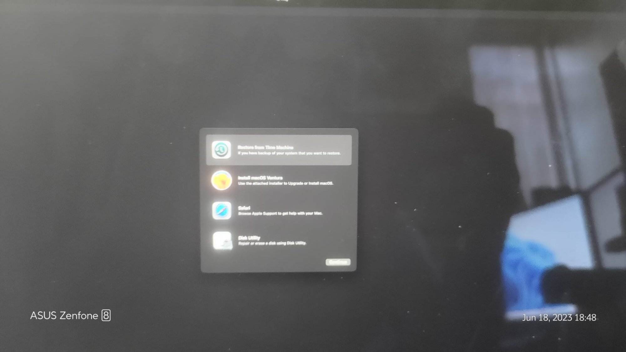

i bulet a ventura installer then booting from the disk
i see this

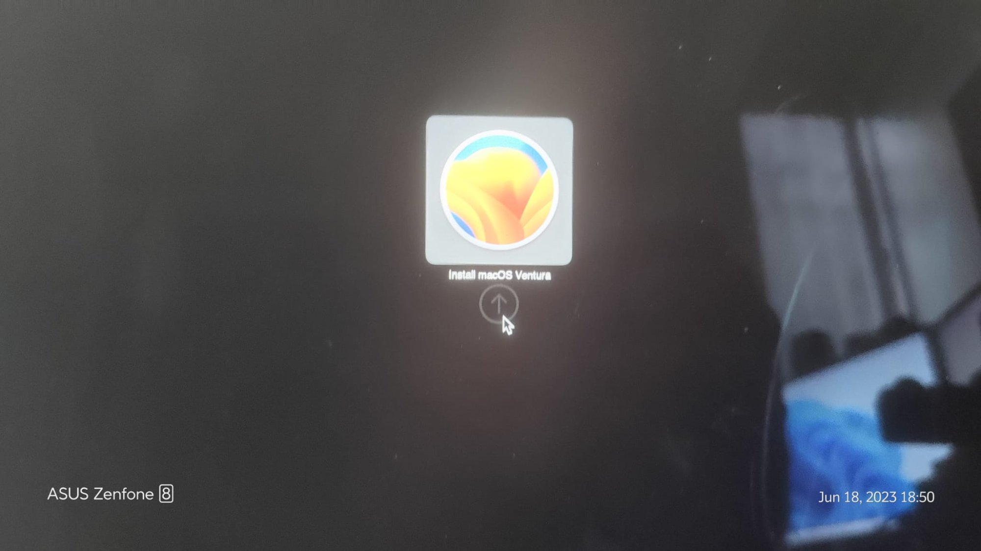

then

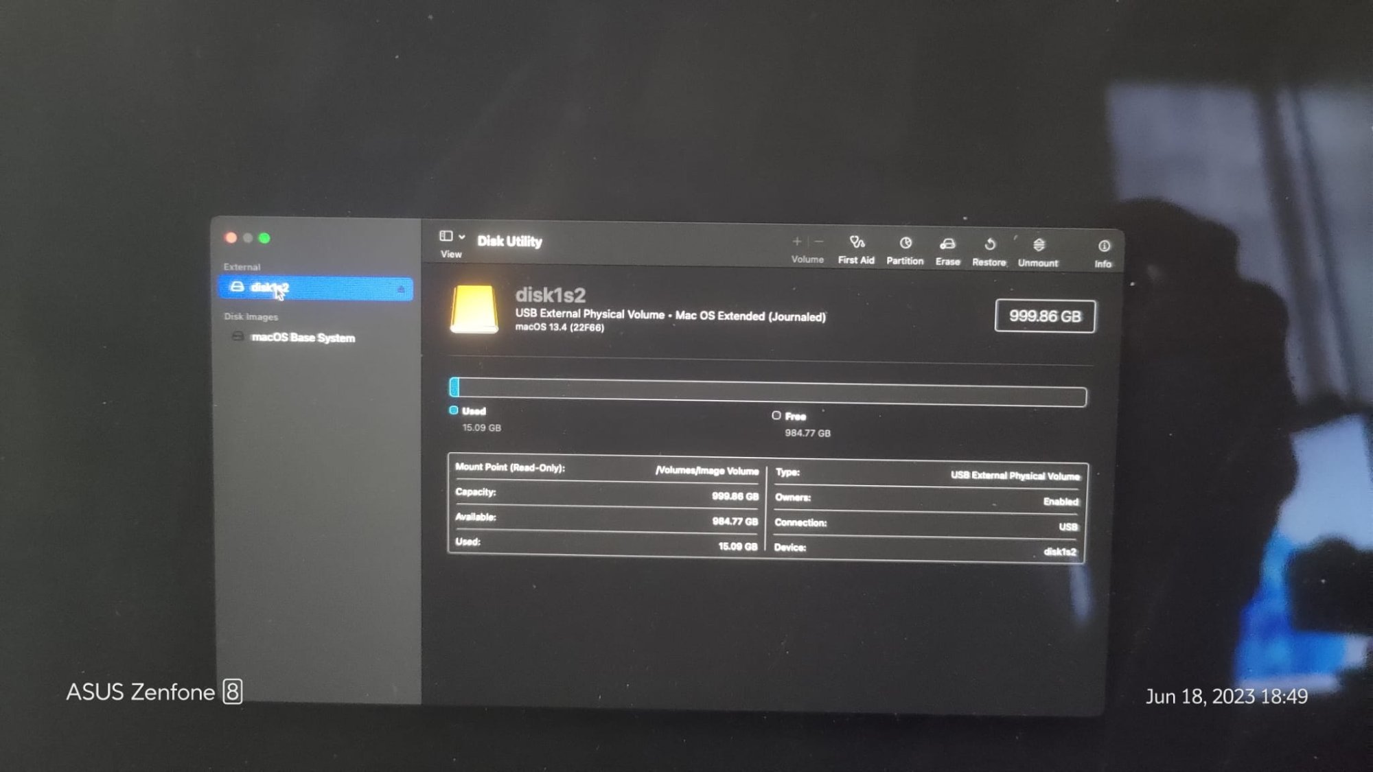

in the disk utility i see only the disks2 (this is the installation disk from Opencore)

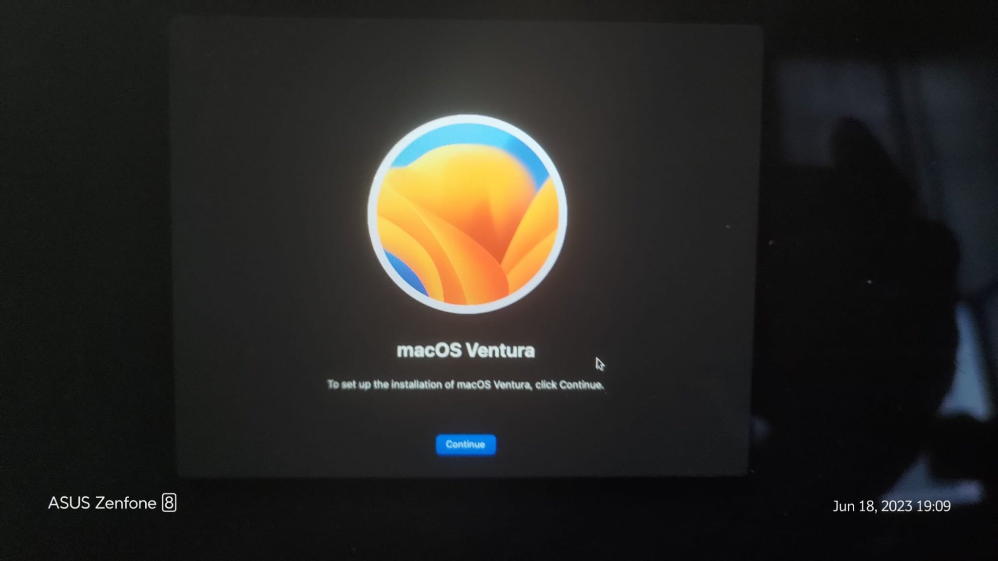

when i try to install

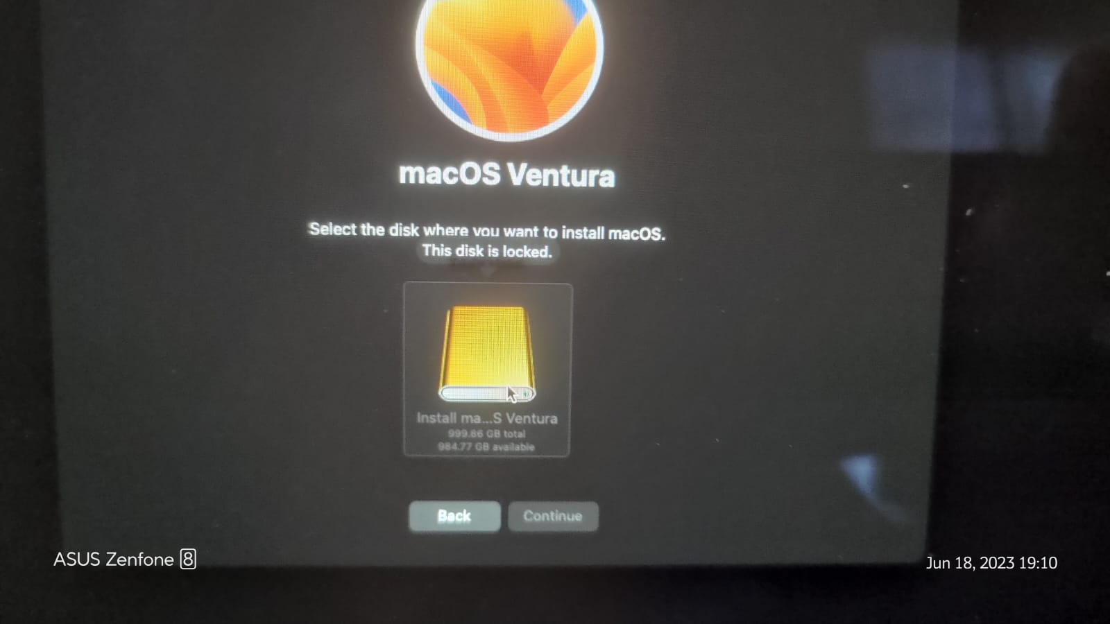

I see only one disk and it is lock

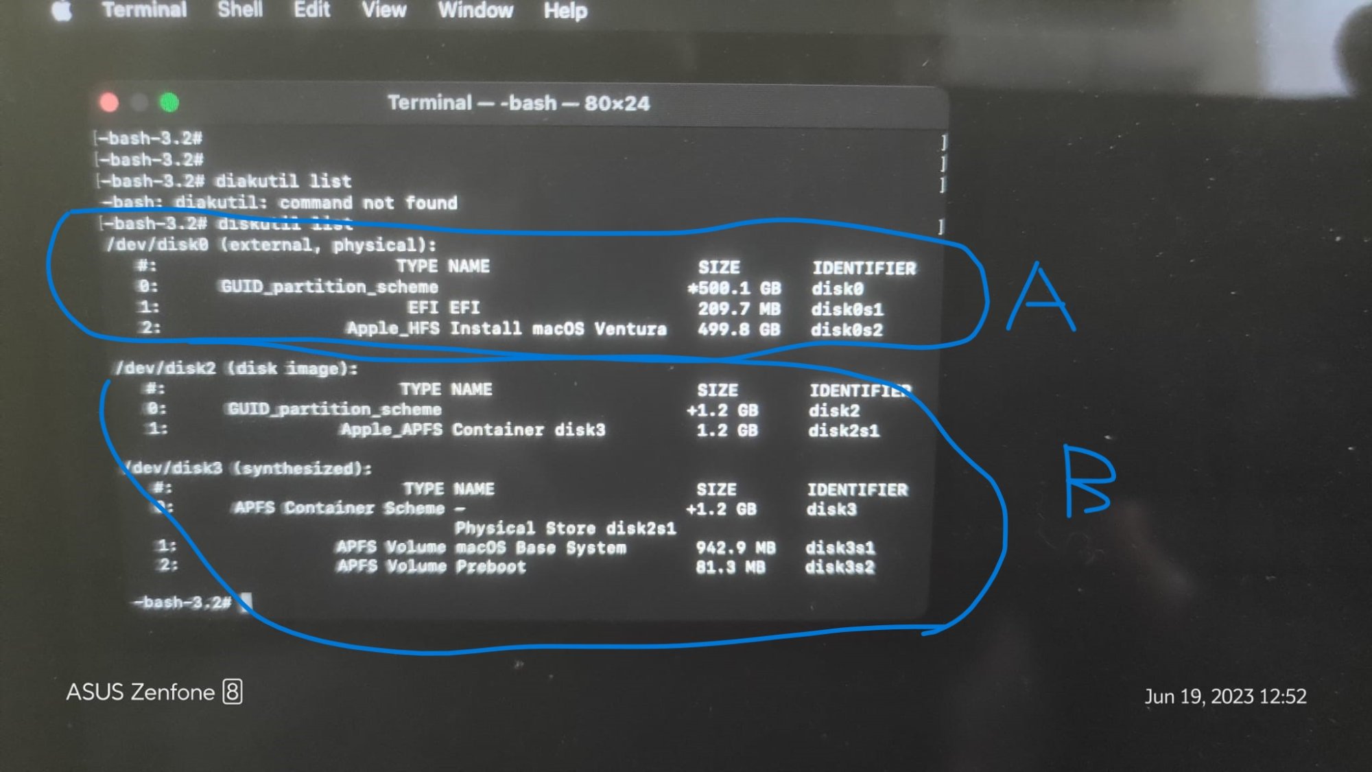

Yes, other type, APFS. But your mac should be able to recognize the USB disk anyway, check the ports and cable. Also, check with ”diskutil list” in Terminal when you have booted with the installation stick. Then all disks should be listed.

the disks are ok (i can see them when using the old OSX)

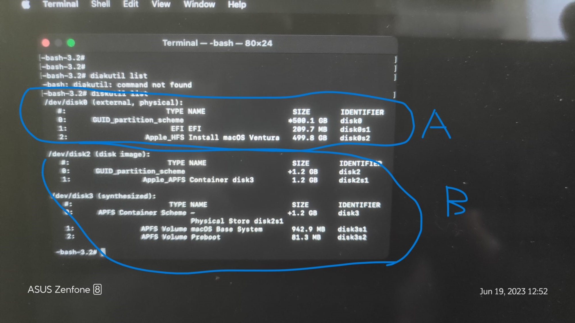

on the list from the terminal i can see 3 disks
A is the instillation
B are the internal imag disk
i cant see the disk i what to install to :-(

It seems you have your install media on the USB disk you are trying to install to, which is impossible. You need to make an installer on a USB pen drive and then install from that to the USB disk.

Not sure if this will help.
In your original post, look at the 3rd pic from the top (disk utility).
What happens if you go to the "view" menu and choose "show all devices"

hi
it only add the top of the value :-(
