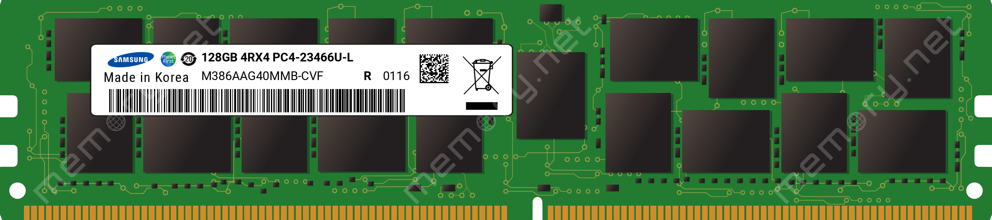

A bit off topic - I'm curious to know what memory modules you installed to get your 1.5TB ?
@Snow Tiger, I ended up buying 12 of these:
I called Apple to verify that these should work. I also found this post by @repoman27 to be very helpful:
Also, be wary of some websites selling RAM that is compatible with a certain brand/type but not clearly stating what type you will receive. I liked the fact that this is a reputable seller (with a very long history) and they make it very obvious to see what specs and which specific manufacturer you will get.
Good luck if you buy something like this! My RAM arrived very quickly and, aside from this zfs trouble that I'm having, it seems to be working great!
Good luck if you buy something like this! My RAM arrived very carefully and, aside from this zfs trouble that I'm having, it seems to be working great!
$1300 each . That's not too bad a price for a Sammy 128GB module . And you got a lifetime warranty , too . For the generic brand modules , it was until recently possible to grab the 128GB modules for around a thousand each . No more .
Lately , they've jacked up the price as if too many ppl were asking the retailers the same question : "is this compatible with my Mac Pro ?"
"Why , ye$ , $ir , now that you mention it ! How many of the$e would you like ?"
It's kind of predictable , I guess . We always are expected to pay more due to Apple's reputation for asking top dollar for every ... little ... thing .
This was definitely less expensive than buying the RAM directly from Apple, and I feel very good about Samsung RAM. I also felt good about memory.net. I never bought from them in the past, but I checked them out very extensively, and they have been around for a *long* time in this business. So I felt reassured!
Sammy usually makes very good products .

I greatly preferred to use Samsung enterprise DDR3 modules in all my MP4,1 and 5,1 builds . I don't believe a single one failed . Had some Hynix , Micron and Nanya component based modules fail , but memory failures are getting rarer now . Failures were common with DDR2 , as they often overheated . But DDR3 and DDR4 are much more reliable technology .
