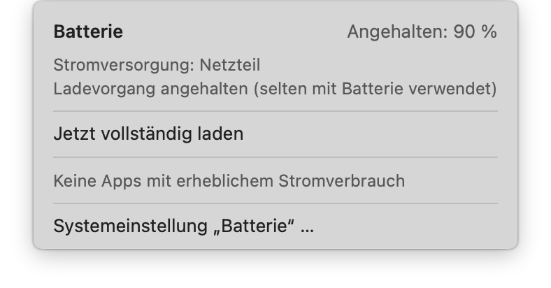

Small update.
After 2 weeks of almost constant stationary usage my MBA now stays at 90% battery, so "Optimized battery charging" definitely works with my LG monitor.

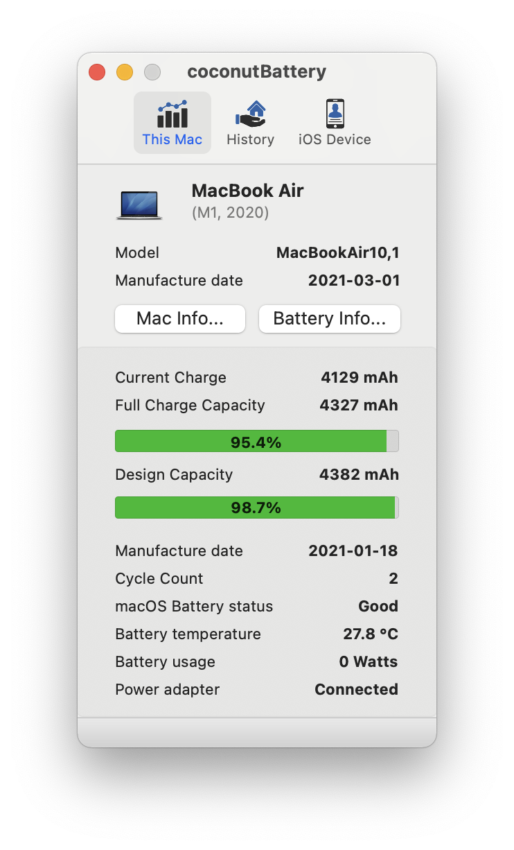

And design capacity indicator increased as well.
