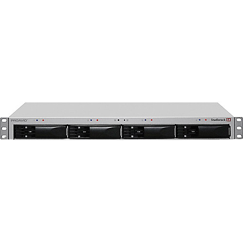

I've been using a 4-bay removable hard drive enclosure (JBOD -"Just a bunch of drives") with Firewire 800 for years which has worked very well for making backups. Unfortunately it's limited to 3TB (or was it 4TB?) which is a little small these days:

So far I've just put the project on hold and am continuing to use several "small" (1-3TB ... funny how the definition of small becomes bigger and bigger) hard drives with my 4-bay 19" rack. Less physical drives, but with each drive handling more data would be nice, and I believe USB 3.1 geb.2 is faster than Firewire 800.
The rack is nice to have though, as it's space saving, but all I can find (from OWC at least) is their Mercury rack Pro with a mini-SAS connector (no USB or Firewire connetcor at all), and a quite steep price tag. I believe I've seen the same rack somewhere else (they're probably all made by the same Chinese company, only labelled differently) a few years back, but not sure if they've been updated with USB 3, and the price for rack units is still quite high.
And since I don't really need 4 bays (2 bays are very handy though) I think that's a premium which I'm not willing to pay just to save some space. I might just place the USB drive dock on top of the Mac Pro (which is also a good idea given the short (1m?) cable limitation of a USB 3.1 gen.2 cable).
