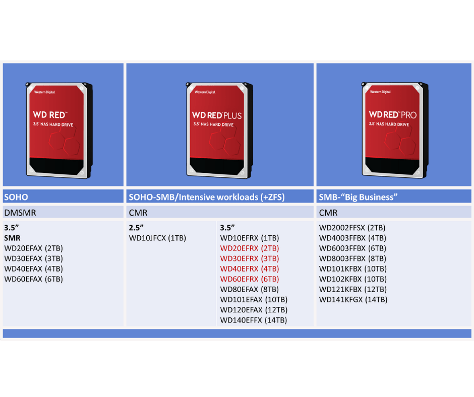

I changed my mind and went for the QNAP (TVS-872XT). I’m going to set it up as a RAID 5 (6 HDDs) and leaning towards the WD Red Pro drives. I can’t find a significant or minor performance improvement with the WD Gold/Ultrastar. Any input or recommendations are welcome.
You shouldn't have any problem with the Pegasus32. I can't find any performance information though or what PCIe RAID controller it uses (can it saturate Thunderbolt 3's 2750 MB/s if you connected SSDs instead of HDs?)
All WD Red Pro are CMR, but if you go for normal WD Red pay attention on CMR vs SMR drives, never buy SMR/DMSMR for arrays.
wd-red-family
