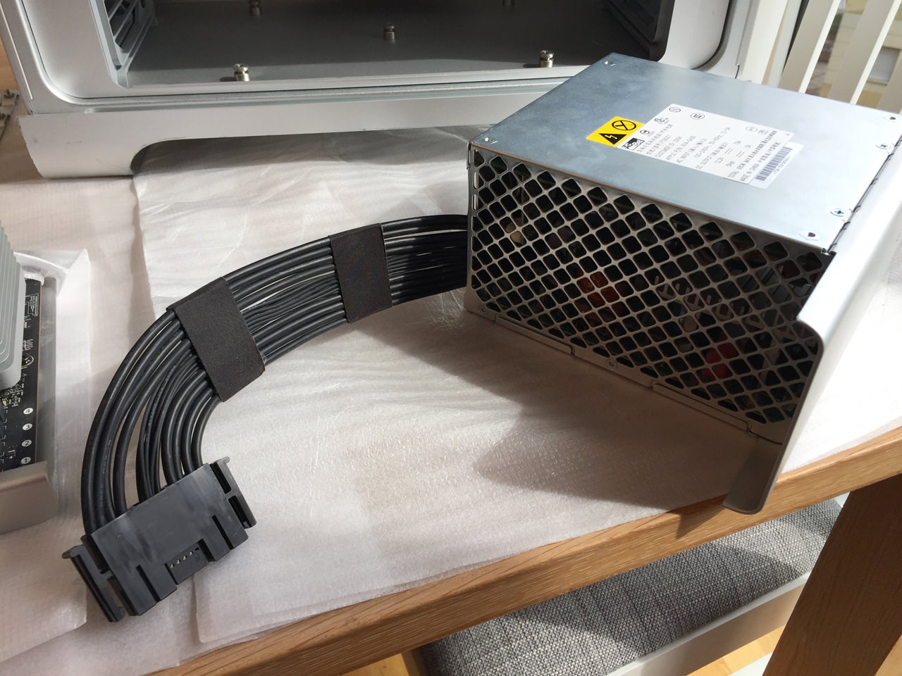

You mean a dual [6-pin Mini-Fit Jr.] to single [PCIe 8-pin]?
I mean a direct connection to here.
This will allow more than one 8 pin cable draw 150W directly from the PSU.
