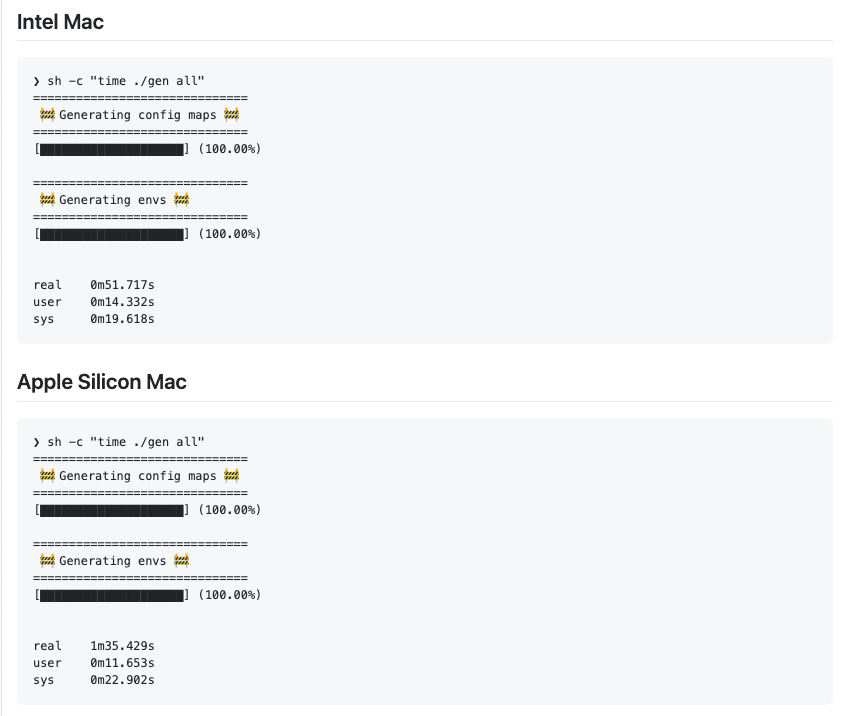

Definitely appears to be an IO issue of some description... I rewrote the horrible script so instead of running sed for each pattern it has all the patterns in a single sed call so it only reads/writes once and it is massively improved, the full script down from about 25 minutes to 1 minute on the M1 mac
Honestly, a little embarrassed that no one thought about it before, shows the power of inertia... the script is working so why change it 😂 Still, slightly concerned, shall have to run a disk performance tool to check the drive

Changing all the sed commands to a single call like
Code:
sed -i.bak -e "s/foo/bar/g; s/bar/baz/g" file.txt
certainly has massively improved the performance, although still weirdly noticeably slower on the M1
That's so common I could scream. At one job I had I was the guy that found the slowdowns and then fixed them. I've never worked anywhere else that had a guy that did that. :(
Ha yeah, that is normally me too be honest, which is why I was asked to test the new Mac, just that this script has never been that much of an issue to bother with. Still really interested in finding out why the massive difference in performance between the Intel and Arm macs though. I will have to do more profiling of sed and some disk profiling but I suspect the issue is to do with sed or something related rather than the disk otherwise I would have experienced other issues.

So I think it may actually be an issue with this Mac, someone else now has the exact same machine and it is much more like you would expect, like a 10th of the time it takes this machine.
Plus this machine has done some weird ****; twice on Friday, then yesterday when I was reading just a document and then again today, it completely locked up, then the screen flashed green and it rebooted. Also when we first turned on file vault it rebooted into recovery key mode but none had been reported to remote management (had forgotten about that).... so I am guessing there is some sort of disk issue.
