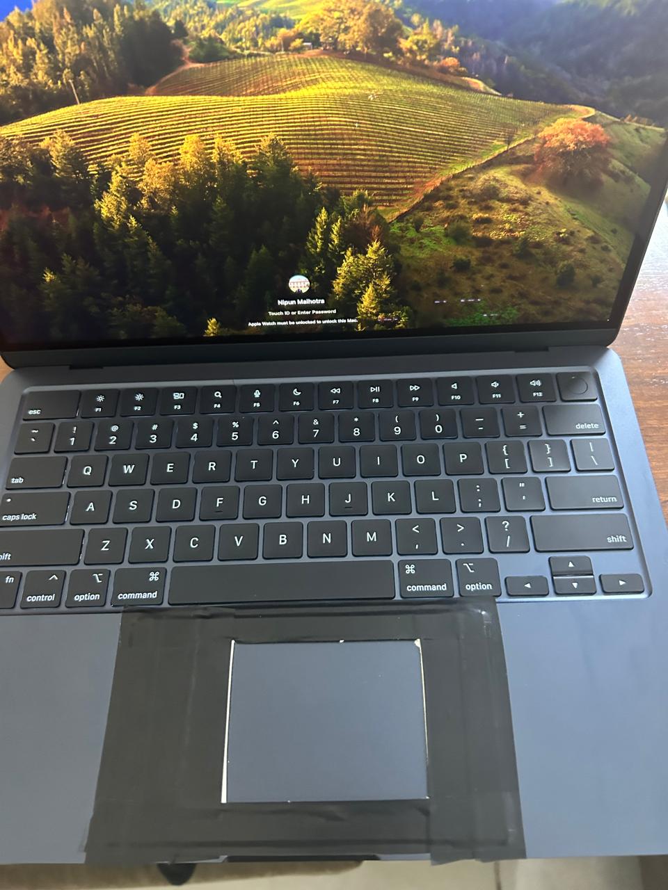

Guess will try a hardware solution
I eventually went for the MacBook Air M3 512/16 and put two layers of cardboard and electric tape on top of it on all sides. I have been using the MacBook for more than two months now, and it works well.
Thank you for all your help
