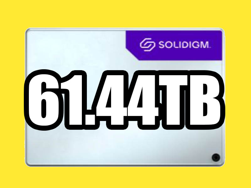

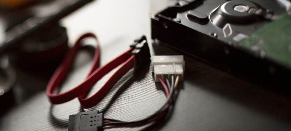

Why? A ssd (1 tb) = 50 bux. Pata to sata = 6 bux. At wich point you can allmost disconnect most fans?
So for 700'ish you can move from hdd to ssd? and recoup that money in drop of your electricity bills?
I am not using an Xserve RAID, I am using an Xserve connected to an Infortrend external FC RAID array.
I currently use 14TB SAS drives and am looking at upgrading to 22TB drives.
Have you priced SSDs with that storage capacity?
Depending on who is paying the bills. Maybe another Xserve, converted to sata disks in jbod modus making sure both xserve receive the data maybe much cheaper. So you then can save on energy.
SAS disks are spinning disks are they not?
SAS in the drive interface, available as HDD and SSD. I use SAS-HDDs in the FC-RAID for the price:capacity value (and improvement in reliability over SATA). I use SAS-SSDs in the boot RAID for performance and reliability.
Again...
I do not understand what you are saying... or perhaps you do not understand what I am saying.
SAS disks are, I think regular spinning harddisks. Just made more robust. Right? One spinning disk draws 1,5 ampere at spin up. So that is quite the draw with 14 disks spinning up. SSD's do hardly draw any amps. They draw very little current. Once data is on a ssd it usually does not corrupt. The drawback is when it has many writes... So a raid configuration that constantly rewrites data is a way to destroy ssd's.
So to use satadisks just as disks and to have it in two locations is another way to keep data safe.
SAS disks are SCSI drives with high spin velocity, probably 10k or 15k rpm.
