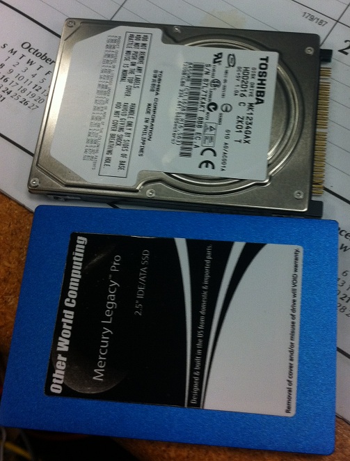

FYI: PowerBook G4 Titaniums, starting with the DVI model, have 48-bit addressing, so they can use any drive that will physically fit. I've been using a 320GB WD Scorpio Blue in my 1 GHz TiBook for a couple years now. Also, Mac OS 9's boot drive limit is 200GB. Anything at or below that (I made the boot partition 198 GB just to be safe) and you're fine. OS9 can read and write to drives larger than 200GB, it just can't start up from them unless it's from a ≤200GB partition on the drive.
Also, got a question. I've got the same model PowerBook and I've been thinking of putting an OWC Mercury Legacy Pro in it. How did installation go with the Foxconn connector? I wasn't able to get it connected when I worked on mine and I ended up returning the Mercury. The pins on the drive are offset by a millimeter or two from industry standard PATA HDDs, so I wasn't able to get the connector to plug in without forcing it because it was a couple millimeters off from where it was supposed to be. I asked OWC if this was a manufacturing defect or if they're all like that, but I never got a response.
Regardless, I've been thinking of rebuying next month and getting some spare rubber mounts for the hard drive and modifying them with an x-acto so the drive sits a couple mm further in so it'll fit.
How's your experience with noise/heat/battery life running your PowerBook off the Mercury?
Thanks for the corrections to sizing for Mac OS 9.

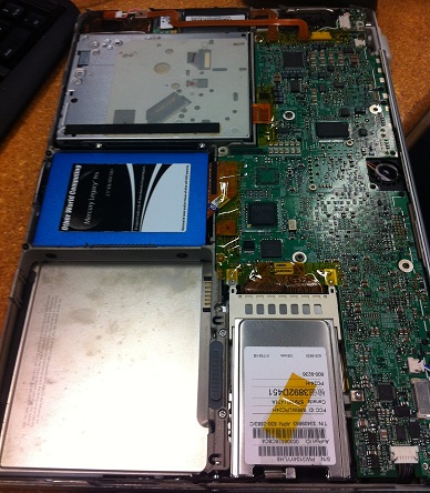

My TiBook with the Mercury SSD was super easy to install from the stock Apple original drive (well, maybe not the original drive, but what the machine had) and been running almost non-stop without problems (in Mac OS 9, even). Can't speak for battery life, as again mine is run closed and on AC. However, since it is running closed, in Mac OS 9 without much heat control, I can say I've never had any worries about heat, even when I was dumping old data CDs.
I took some pics, so I attached them here. The little black gromit thingies were difficult to get eased into the hard drive bay, but once I did it correctly there was no rattle or problems.
Hope it helps- I do love it, so glad that OWC offers these PATA SSDs.

Fantastic, I really appreciate the info and reply!
Oddly enough I finally heard back from OWC just today too (that took a while) and their tech support thinks that may have been a defective unit, as they said the pins should line up exactly with regular HDDs. I think I will try for another one and place an order in a week or so.
