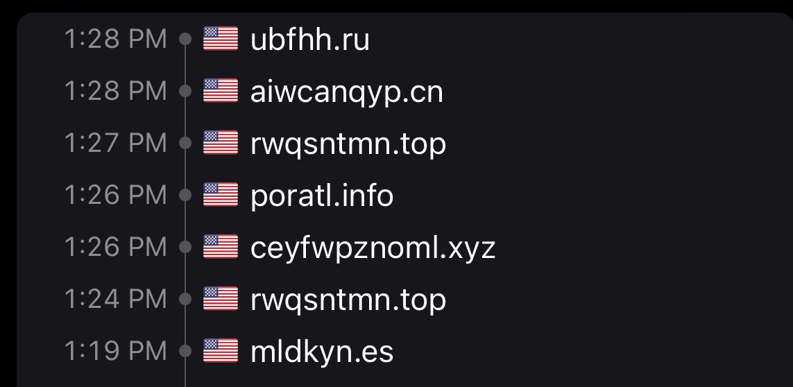

EDITED TO INCLUDE SCREENSHOT FROM ROUTER/FIREWALL DEVICE, SHOWING STRANGE URLS WHEN I ATTEMPT TO UPDATE MACOS.

Secondly, this is a screenshot from my firewall/router device, showing the network flows for my computer when I attempt to update my computer. I'm not sure what these URLs are, except that at least a few of them do not appear to be registered.
