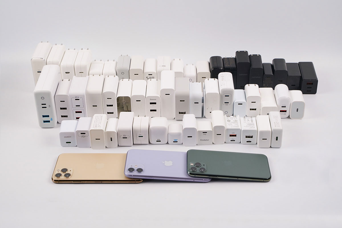

The older iPhones listed in the article you linked all fast charge at 18w maximum, the newer iPhone 11 Pro actually supports up to 22.5w fast charging for the first 50% of battery charging only. The iPhone itself dictates what wattage it will pull from the charger so you can plug it into a 87w Macbook power plug but the iPhone 11 Pro can only pull 22.5w.
I linked the website below but this is the charging flow for the iPhone 11 Pro (assuming you are using a charger that is higher than 22.5w):
Charging from 0-50%: 22.5w full power
Charging from 50-75%: slowly drops from 17w to 10w
Charging from 75%-100%: slowly drops from 10w to 0w
