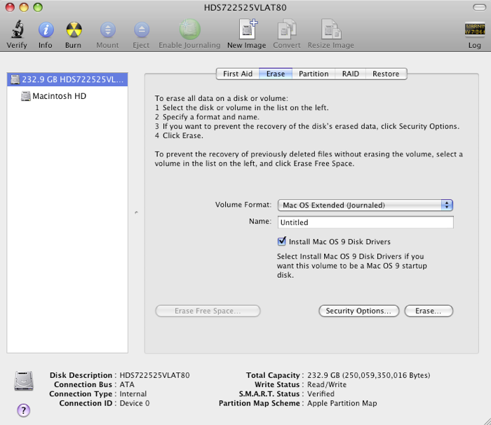

Now open 10.4's Disk Utility, select the drive that's inside the Cube from the menu on the left, and look at the bottom of the window to see if S.M.A.R.T. Status shows "Verified." If it doesn't, shut down, replace the drive inside your Cube with another one and re-do the above. Once you have a drive that shows good on S.M.A.R.T., select First Aid from the menu on top, then run "Repair Disk." If that returns errors, such as "volume can't be repaired" or something like that, the drive may have problems; if an erasure or reformat doesn't correct those problems, ditch that drive. Below is an image of the Disk Utility window; note that the views and menus will change depending on where you click.
Once you've settled on a good hard drive, use the "Partition" menu at the top of Disk Utility to create a small, perhaps 10 GB, partition. Then go to this page at macintoshgarden.org, where you will find a plethora of Mac OS X versions that will work with your Cube. Download one of those, then use the "Restore" menu to put the installer image onto the partition you just created. Reboot your Cube to the boot picker, select the disk partition you just created and boot from it - this should boot into the Mac OS X installer. Install it wherever you want it and, voila!...at least I hope so.
