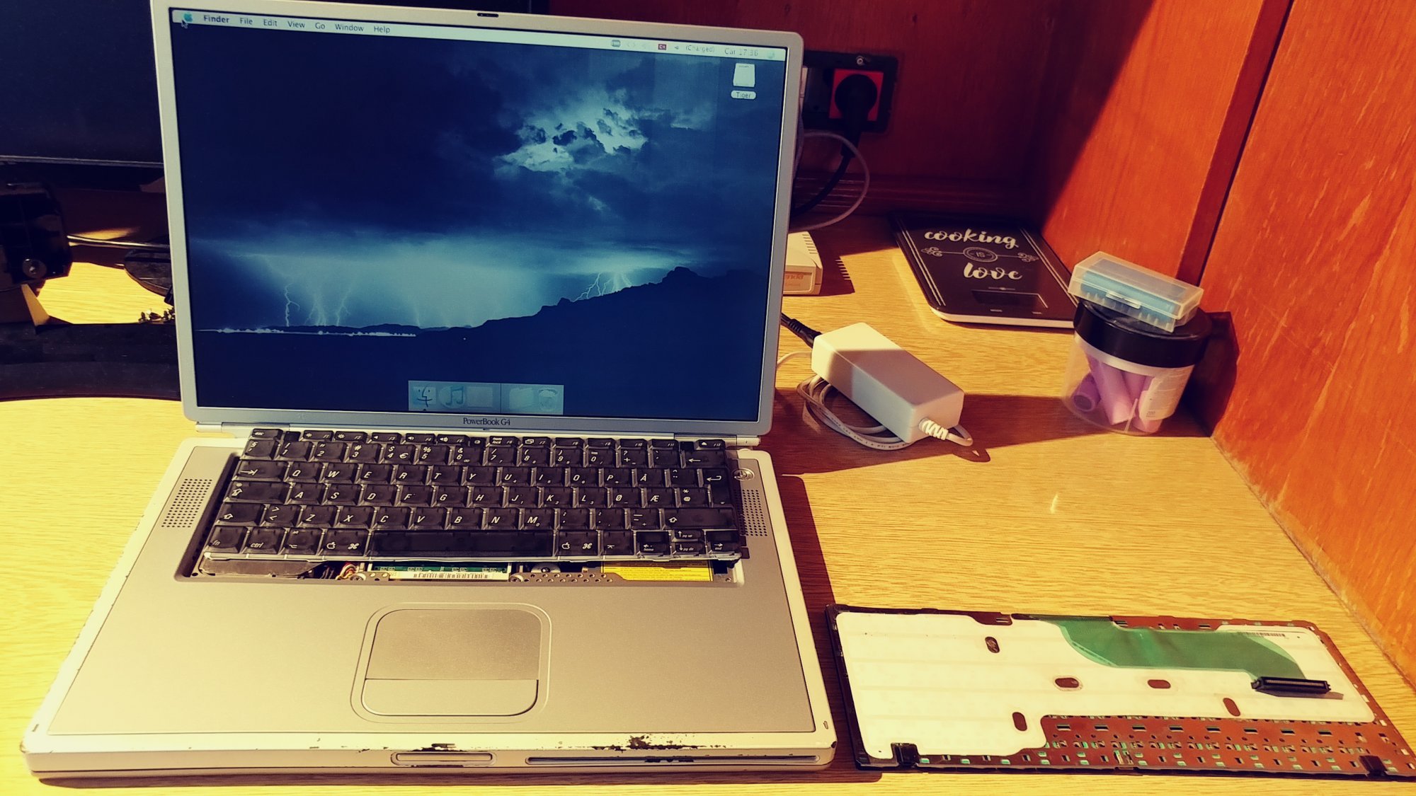

Recently I've bought a PB G4 Onyx (Gigabit Ethernet, October 2001) for $27 in Istanbul. The seller said that it was left in a basement for 10+ years. Every part of it (logicboard, optical drive, trackpad) expcept keyboard works perfectly. Out of the total 79 keys, none except those 14 keys work, i.e. 65 keys don't work:
h k l ; \ ` x v b , / 1 left shift key right shift key
After I've bought it and removed keyboard (which is Turkish "F" layout), I've noticed molds inside the notebook from place to place particularly around the (modem, invertor, etc.) cables and the metal surfaces of the DVD drive. I've cleaned all of them. I guess the molds have affected the inside of the KB so the buttons stopped working.

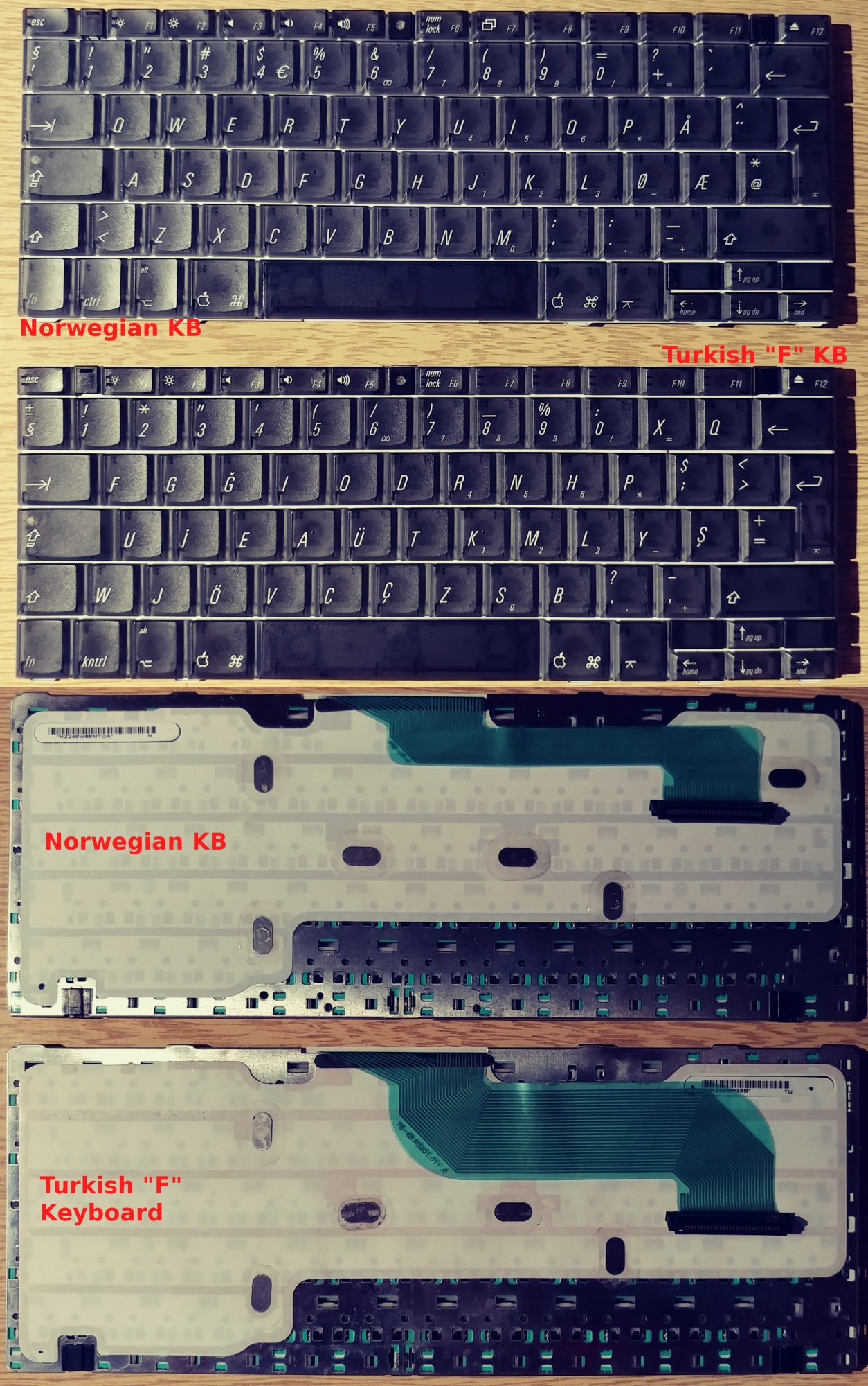

When I connected a problem-free PowerBook G4 1GHz (Norwegian layout) keyboard onto it, it worked fine so I think this rules out any problems on the logicboard or the socket.
Because the Norwegian keyboard's connector cable is shorter than the Turkish F keyboard, it had to stand on top of the notebook. Though it looks awkward, it functions perfectly, all the buttons work in that awkward position.
Here are both keyboards for comparison.
Is there any way to make the buttons of this mold-affected keyboard work again?

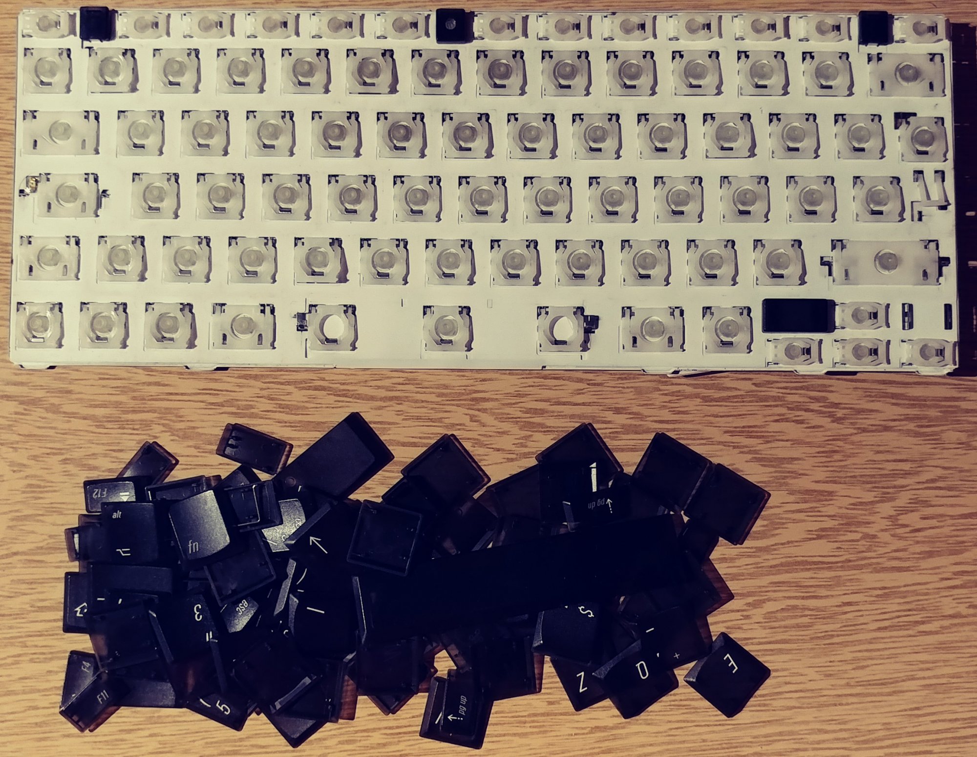

I've removed all the keys. The scissor assemblies and the elastic rubber caps remain on board.
Here is how it looks now:
I'll soak the keyboard minus the removed keys into the isopropyl alcohol.
Does the isopropyl alcohol weaken or undermine the rubber caps after several days of contact ?
I have not experienced any weakening of the “rubber” (which is actually silicone and chemically in a different league than rubber) in 99 per cent isopropyl alcohol. There may be certain types of hard plastics which could weaken under 99 per cent isopropyl, but I’ve not run into this yet with any of the Mac-related stuff on which I’ve used it (which has included other cleaning tasks beyond submerging troublesome keyboards).
