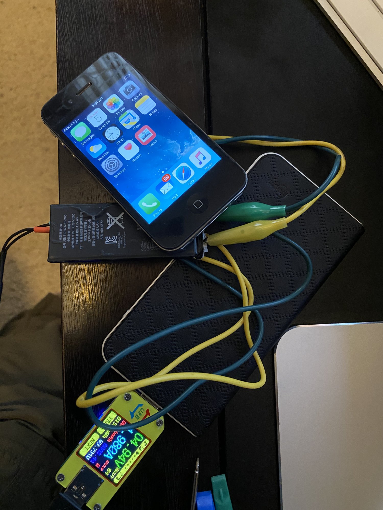

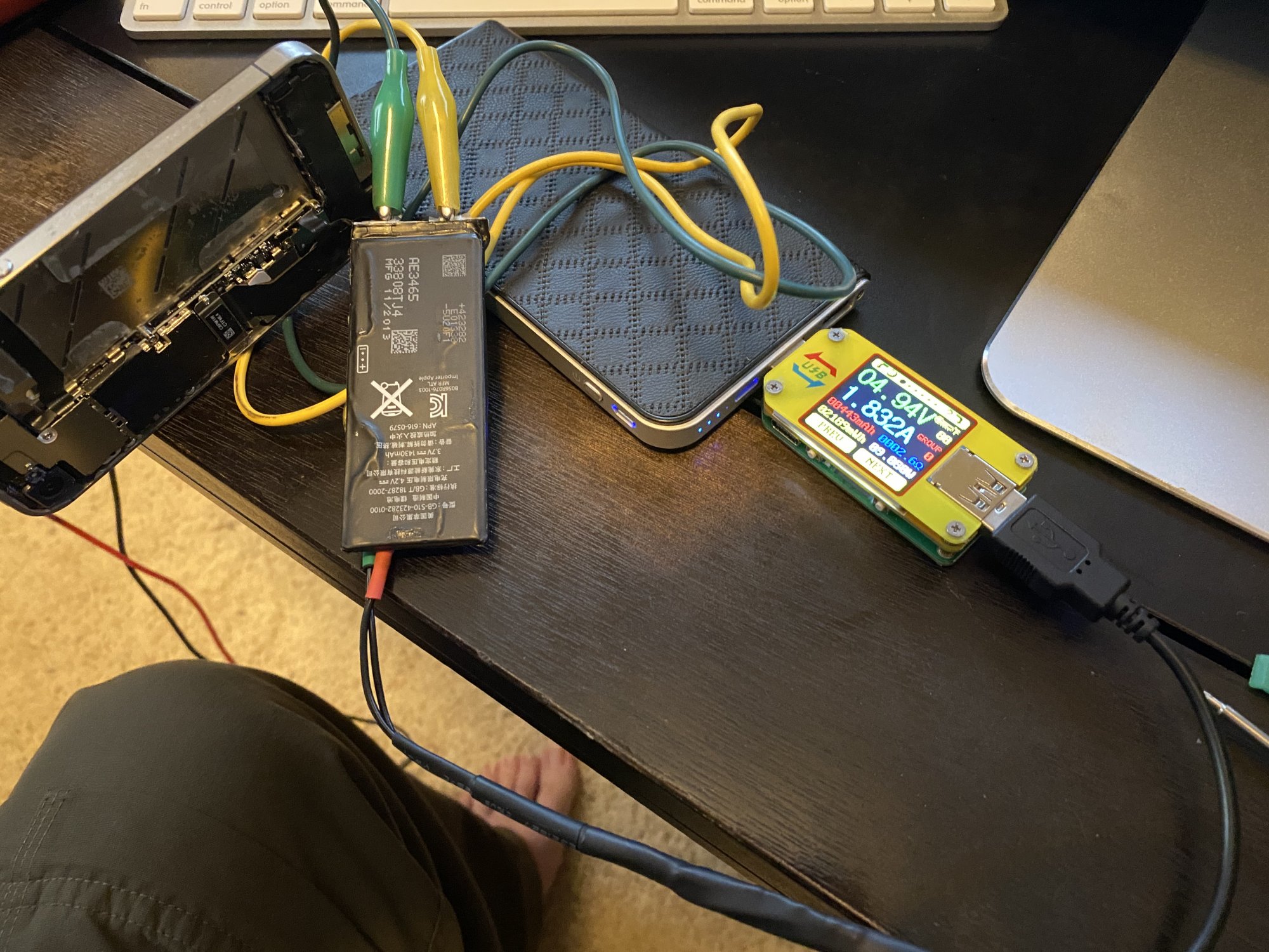

I have a few lithium ion batteries in various devices and if I take 5-12vdc right to the battery (bypassing the protection circuitry) for just 10-30 seconds I can usually bring it back to life by bumping the voltage above the protection threshold so the charger can take over. Do this where there is nothing flammable around under shield of some sort in case the battery overheats, builds up excessive gas, and vents battery fumes in your house or worse. This iPhone 4S battery couldn't be revived but using a USB battery I just connected to the battery terminals.

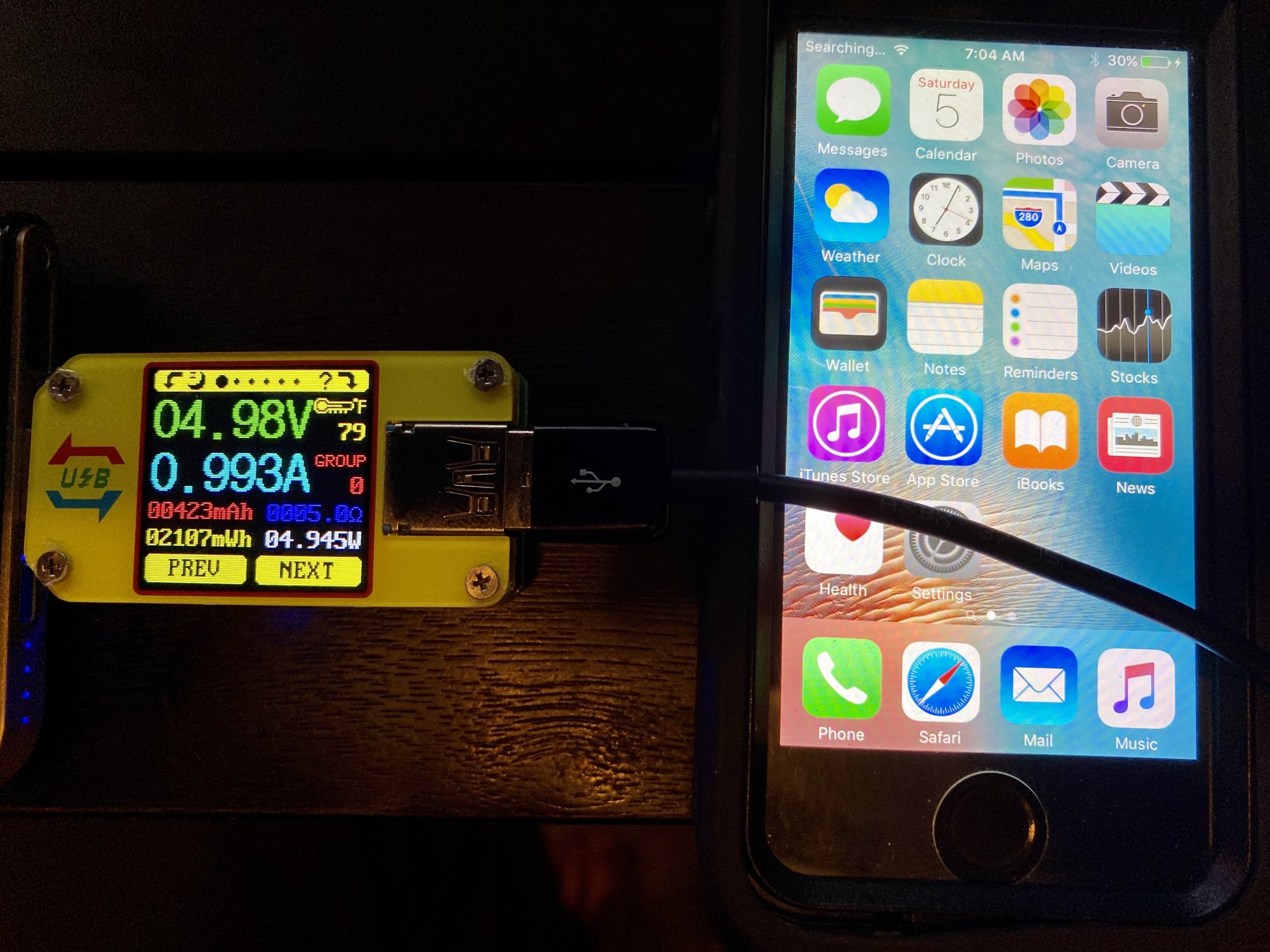

I just plugged my iPhone 5S in and it wasn't charging at all 4.9vdc@0.001amps=0watts. The dead battery icon would not come on indicating it needed to be plugged in or was plugged in. I figured it was permanently dead because its been sitting in a box for 2+ years. I left it plugged in for about 30-60 minutes and too my surprise it came back to life, now charging at 4.98v@.993amps=4.94watt.
There are certain devices/chargers that have a "wake/boost" function to try to bump the battery back to life while monitoring its stability. Didn't think that was something the iPhone was capable of but maybe....
