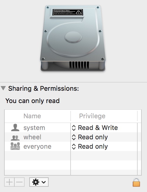

Where do I look for this? I looked on the hard disk and it says what it shows in image I've attached here

Try right-clicking on the hard drive and choose "Get Info." When that window opens up, look at the bottom for the padlock. Click on the padlock; a box will open so you can type in your password. Then go to permissions, in the "Get Info" window. Click on everyone and make sure the permissions are "Read and Write."
Now, click on the padlock to lock it. Close all the windows. Try dragging files from the iMac.

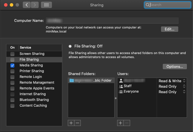

For file sharing, you can set permissions for the account you're using under sharing in system preferences. I think this would be a better (more secure) option than globally allowing all users full access to your system disk.
