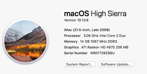

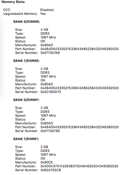

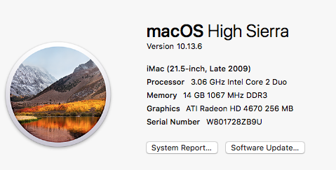

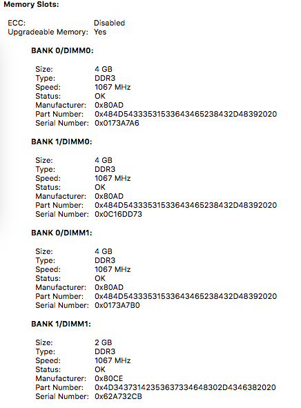

I've double checked they're inserted correctly and that there's no one 'bad card'. I also was careful with static, etc. The iMac is currently working fine with 14GB (3x4GB and 1x2GB), just won't go up to 16GB. I could live with this, but just frustrating - and also means I don't have horizontal matching slots (2x2GB plus 2x4GB) which there seems some debate whether this matters. I've attached the current state for info.
