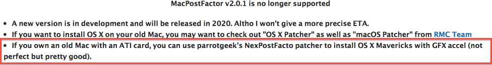

Anyway, if it can interest I found the following:
from: lll490
Hey everyone, I just seen this on the OS X Hackers website. Do you know if "NexPostFacto" is available to download ? I can't find on Google. It seems to work with old ATI card, just like the x1600. Thank you !
Maybe it will help to solve the video acceleration issue!!!
Hello Djangojonas,
and downloaded the patcher which seems to contain ATI1600 Kext...
Unfortunately I was not succesfull and get error from the patcher script: I think I've not understood how it need to be used (I'm very new to osx...). Maybe following also instruction in https://www.rmc-team.ch/osx-patcher
Any idea?
