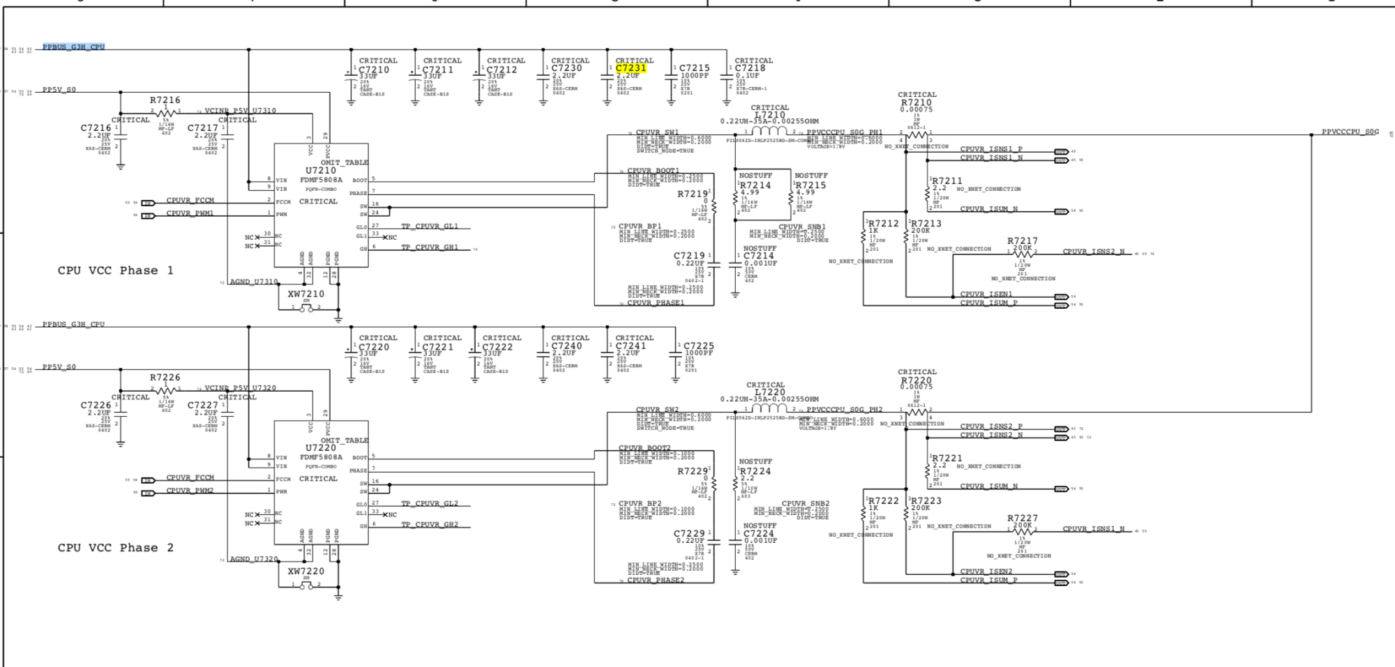

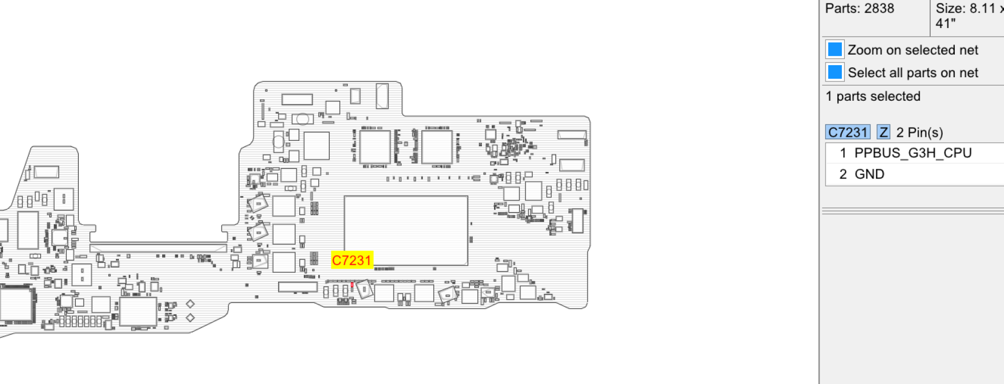

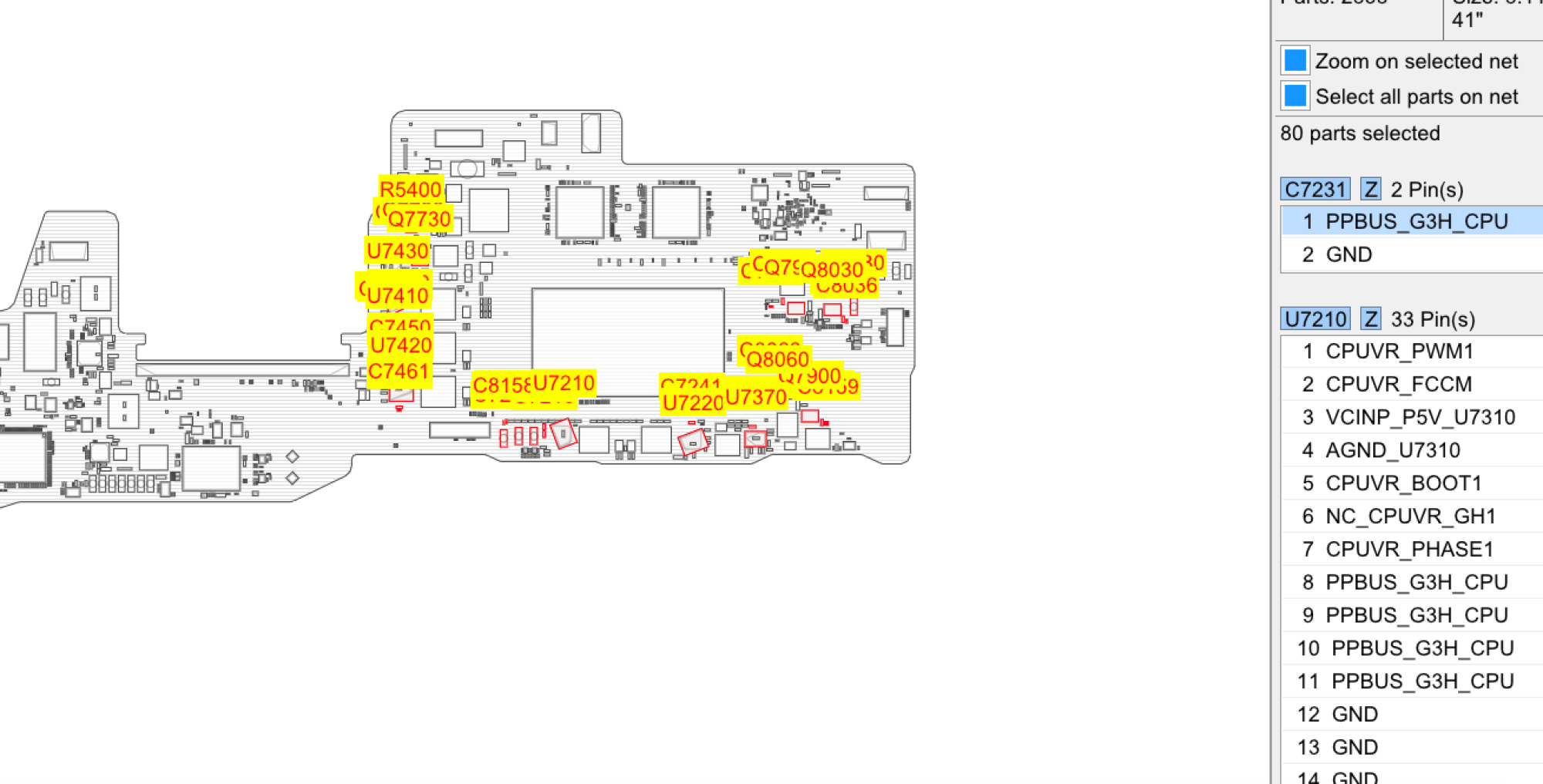

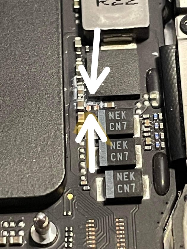

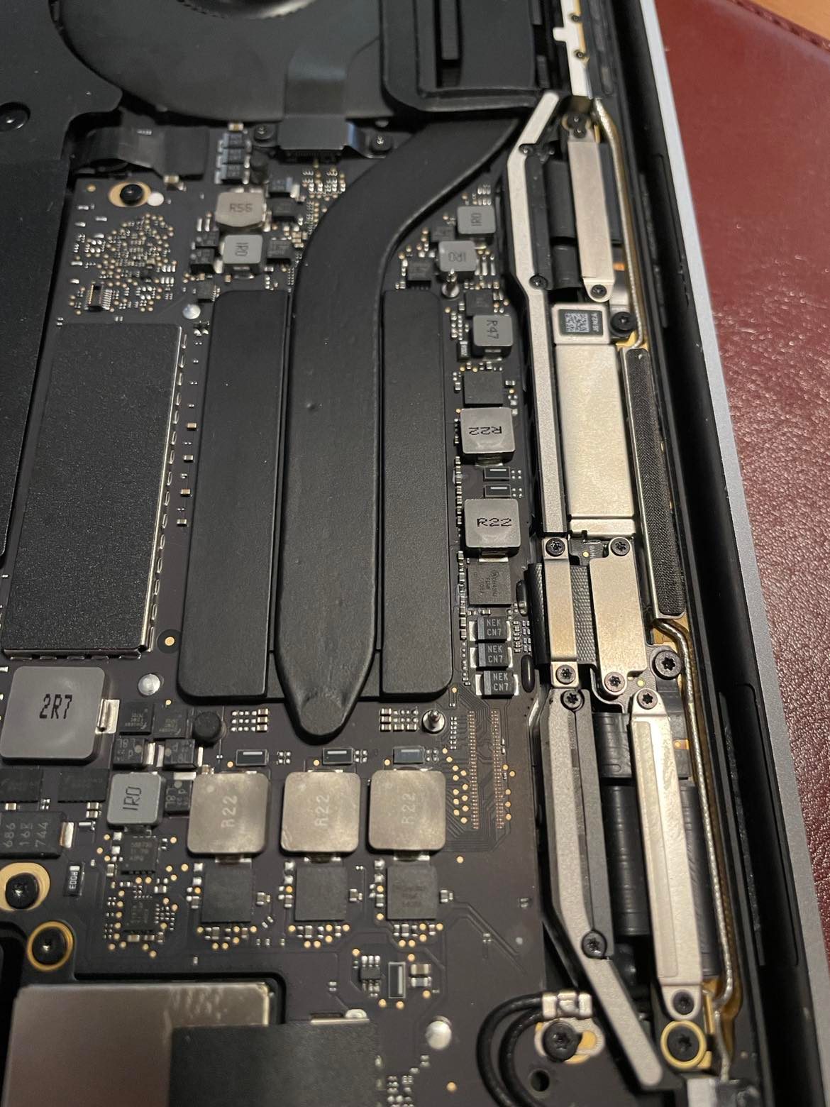

Hi everyone,
need some help here please, I was going to repast the cpu and I saw that the missing tiny capacitor, the question is this capacitor create in machine problem in the future? If yes in which unit? Now the Mac works fine. 295130193_593575875668656_4840011559389960688_n.png295232425_790578698741086_7426925598998507208_n.jpg295297366_4999307336844476_7953002754986873992_n.jpg295302880_753638692504814_3024001590104797161_n.png295618736_736623327592793_9174645376746017877_n.png

It seems like it was stripped completely. In terms of SMT, capacitors are filters and voltage stabilizers. So I’d say it’s needed.
I would suggest you go to Apple as it seems to be from factory. I would advice against trying to DYI the repair due to the dimensions the nearby components.
in which unit I will the problem in the future?,I know that the important role for the capacitors but if the cost for apple is 400$ and without capacitors my Mac work fine I will think it to replace logic board.....thank you
If it's only that capacitor, you can probably take it to a shop specializing in board-level repair and get them to solder it on for less than $50.
