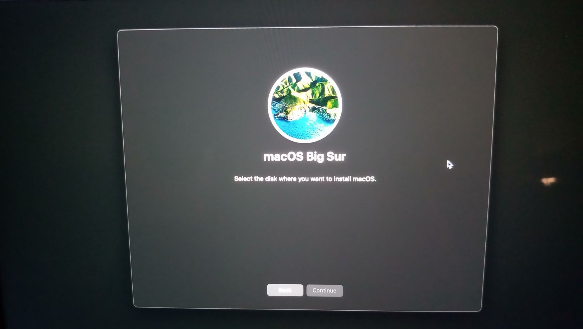

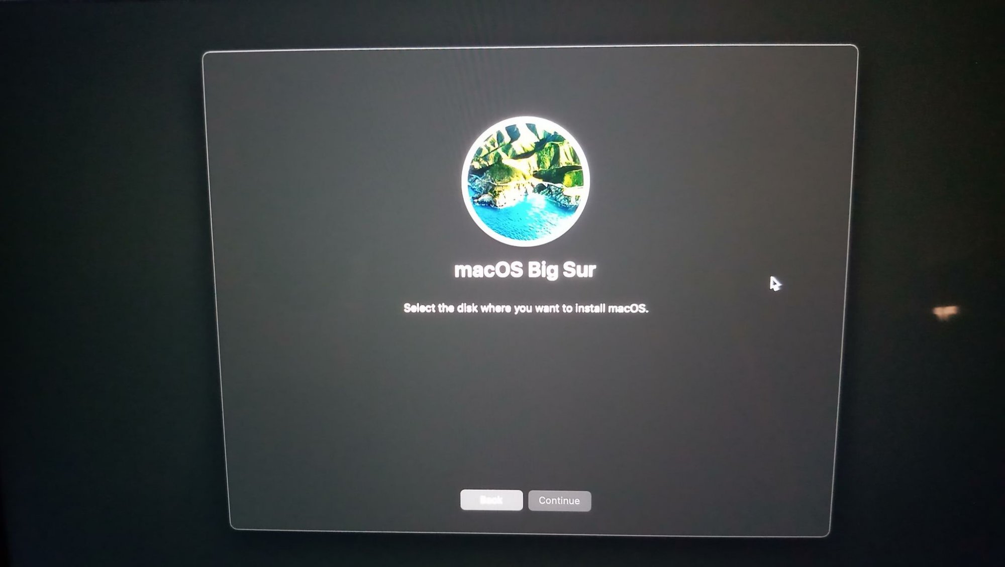

I recently opened up my brand new Macbook Air, the 2020 version with the M1 chip. All was good and well, until I forgot my password. Having not been able to properly set up an Apple ID account, I was left to reinstall macOS Big Sur on the thing.
After attempting to do so, I ran into the infamous "An error occurred failed to personalize when Installing Big Sur." error. I then followed the official steps through the instructions stated in this video:

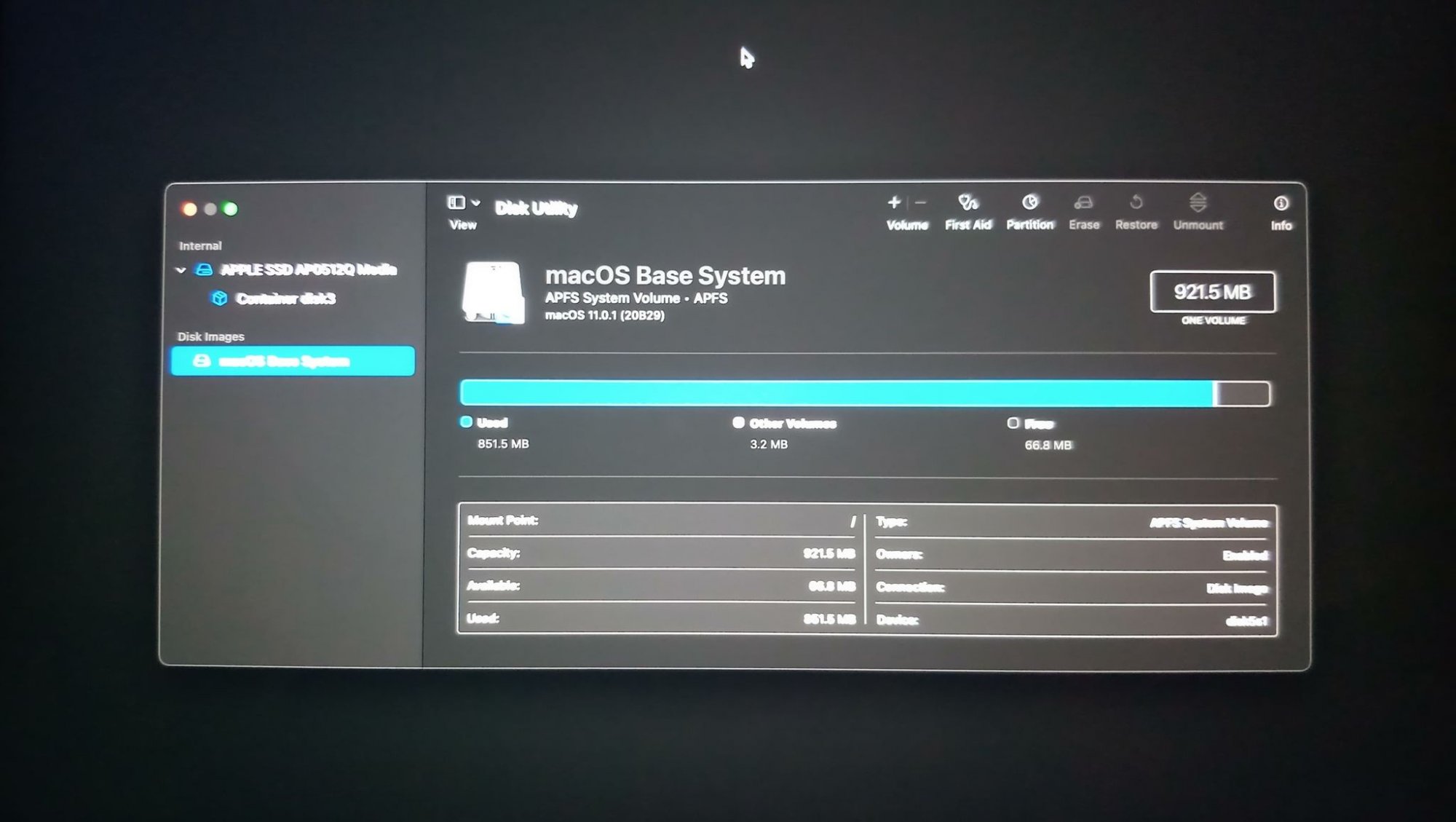

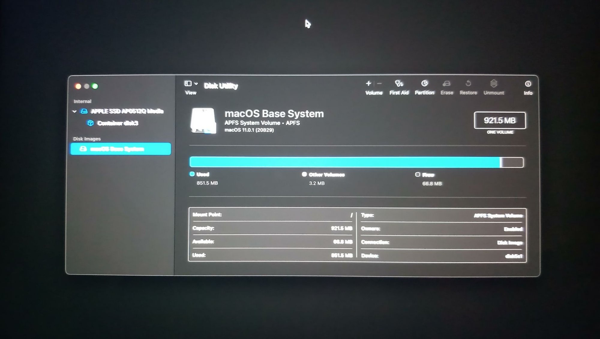

Following the instructions at the 8:40 mark, I erased my drives, both "Data" and "Macintosh HD" before proceeding and attempting to once again reinstall macOS with the hopes of not getting the aforementioned error. But upon doing so, I didn't expect to be left with a "Container disk3" under an Apple SDD:
And now, when I get to the part where it asks me to "Select the disk where you want to install macOS," there's nothing to click!

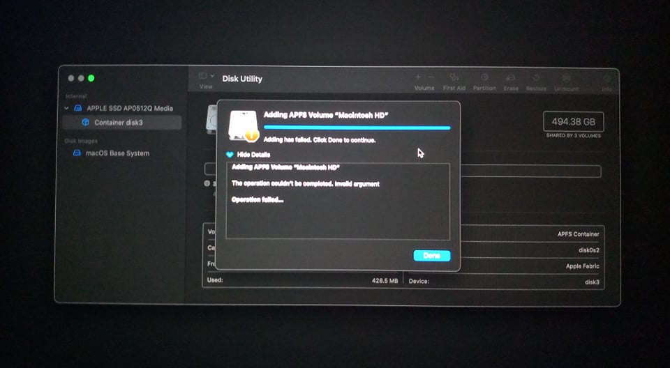

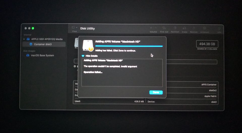

I scoured the web and have unfortunately found absolutely nothing. I've tried adding an APFS volume to the container but doing so has only resulted in another error:
This was likely stupidity on my part, but at this point I'm reaching out for help as I have no idea what to do anymore. Really appreciate anyone who could lend me a hand here. Thanks!
I didn't watch the video you linked, but I had the same problem in your screenshots. Have you tried using the resetpassword + Recovery Assistant + Erase Mac process as outlined here?
If you get a personalization error when reinstalling macOS on your Mac with Apple M1 chip - Apple Support
My problem was that I only ran through it once, then I tried to manually fix it.
Starting over and running steps 3-9 twice through did it for me.
You'll know it's ready if you don't see anything but Untitled on the internal storage.
This was on an M1 13" MB Pro
