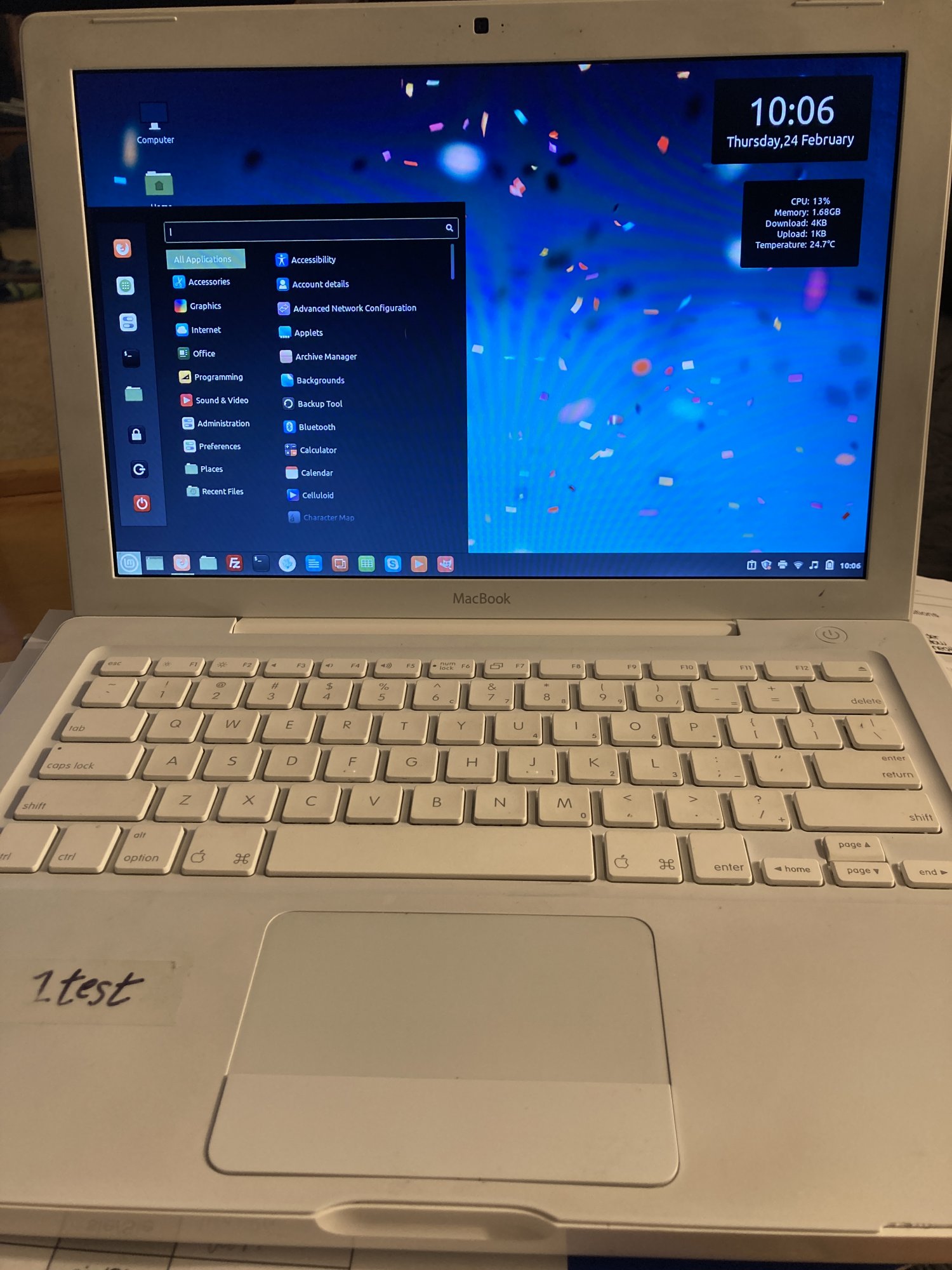

@Hughmac thanks, that might fix my problem. I thought that with its 64-bit processor and 64-bit EFI it might work but apparently not. I will definitely try this!
I tried the version in the link at it booted the installer fine! However, after installing, it won't recognize it as an operating system the Mac can boot from, even though there were no errors during the installation. I am wondering if I did not set up the partitions correctly? I had them set up as follows:
60GB partition, mount point /, ext4, this is where I installed Mint
60GB partition, no mount point, ext4, this where I was planning on installing OS X Tiger
4GB partition, swap area
4GB partition, efi
I am not sure about the order, unfortunately, but if it matters I can try it again and keep track of it this time.
Thanks in advance.
I would start by installing OS X, and leave a blank unformatted partition for Mint. Once you have Tiger the way you want, then you can boot to the Mint installer.
Just let it do its thing; it will offer to install alongside the Mac system and if you let it partition as it wants everything will go fine. It will also handle Grub for you.
After that you can put rEFInd on, either from Tiger or Mint, and you should be good.
Cheers :)
Hugh
@Hughmac I tried that and it works very well! Thank you for your advice!
