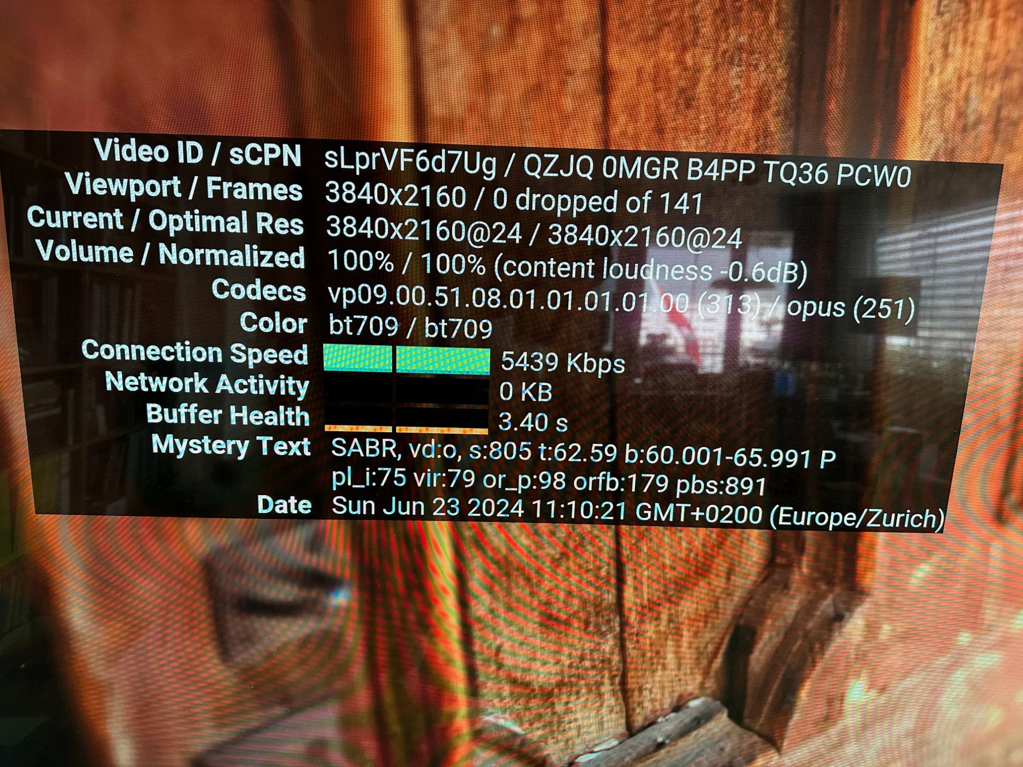

Hi! Recently I could easily see 4K movies on YT. 2160 HDR, no problem. But yet it's no more possible. I use my ATV for Apple TV movies /series and Prime: both UHD no problem on streaming. But YT doesn't work any more. An I changed nothing...
My web connection is ok 400 Mbps. Stats for nerds are bad. This morning impossible to watch my 4K demos. Even on 1080p.
I made a hard reset, multiple reboot, deleted YT app, reinstall. It's now worst than friday...
I installed SpeedTest on my ATV: max speed 9 Mbps. That's not enough for 4K. Why is it so low? It wasn't...
Tx for any help.
Well... I tried something hardware. I connected my ATV direct on the modem/router of my cable network operator. It now works perfectly. Previously it was connected on my gigabyte switch...
I always wonder: why (when you changes nothing) what have worked very well doesn't work any more... ??
