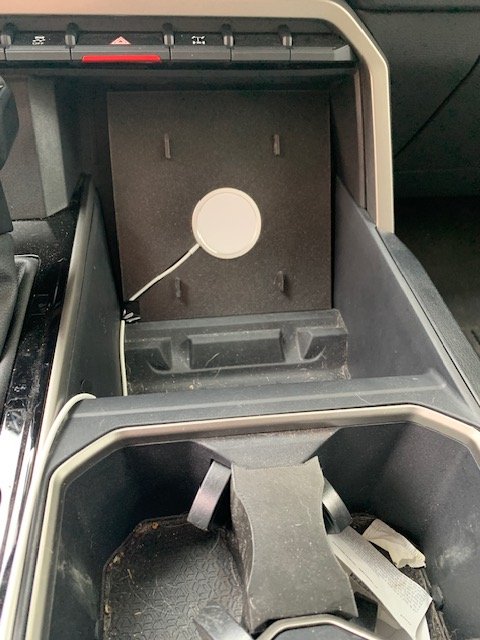

BTW, this is the setup in my truck. I just 3D printed a mount for the MagSafe puck and fitted it into the console. Hope it works OK with the 16P on wireless carPlay... if not, it will be back to using the charging cable.
Plain ol’ Qi with wireless CarPlay, is gonna struggle to keep up with power requirements so you will get little to no charge while using it. MagSafe works fine… in my Chevy the USB-C port became the limiting factor with MagSafe so I switched to a high-power cigarette lighter adapter for it, and that’s been flawless for the past couple of years.
Qi 2 should, theoretically, work fine but I’ve not tried it as I have enough MagSafe pucks.
I tried the MagSafe with my XR and it behaved exactly as the generic Qi. Hot and no significant charge progress. That MagSafe in the photo. It is about a year old and I don't believe they have changed since then, but IDK.
I have not yet tried it with the new 16P. I'd have to look up the specs on my vehicle's 2 USB charging ports (they are not wired CP ports) but they call them "high power". When plugged into the phone they easily charge the phone right up even using wireless CarPlay so they do put out some power.
