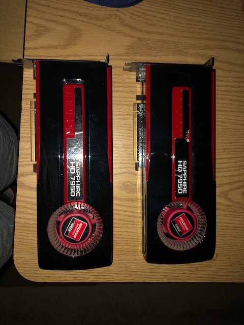

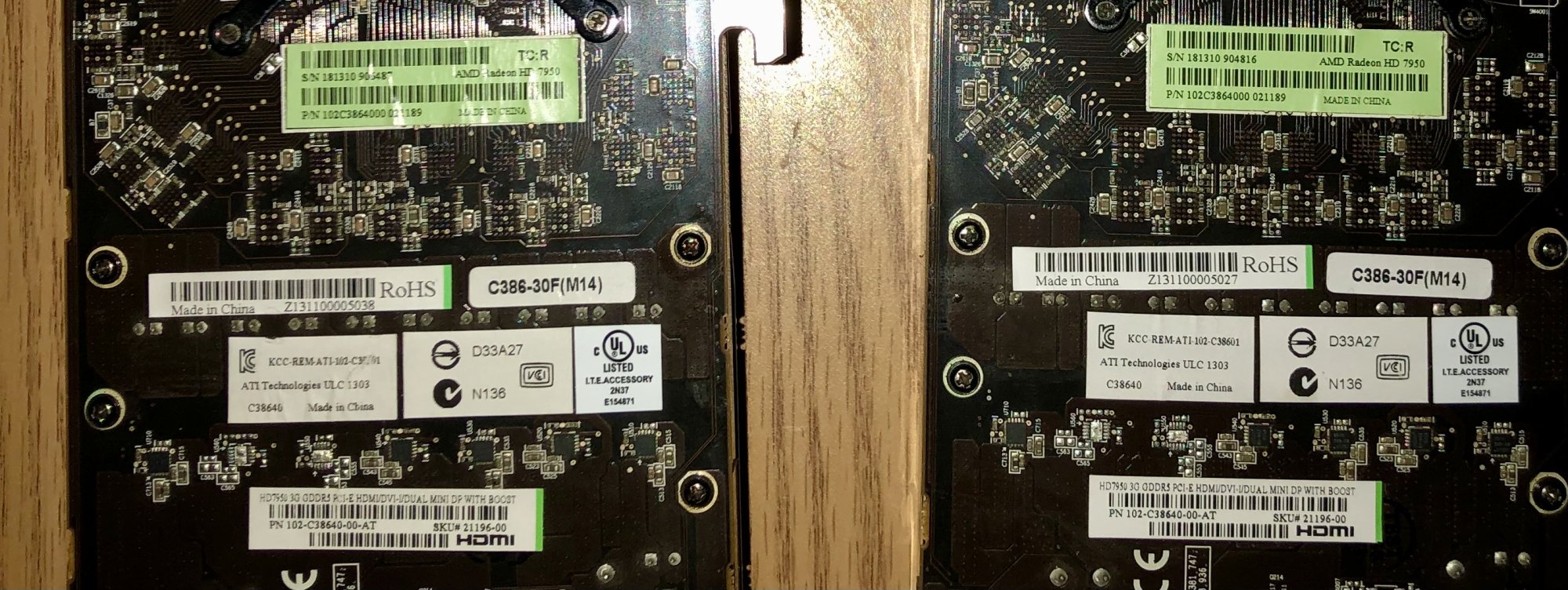

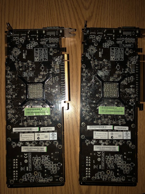

Here are some pics of my 7950 cards. Both are basically the same but the have a core clock difference. Don't know why since they are both HD 7950 with boost. And I was wrong on the pins, both are 6 pin to 6pin.
As you can see, they have different GPU clock MHz, don't know why though. I plan on flashing them to Mac if I can ever learn how to do it. Have watched and read various procedures for this but can't seem to get it right. Seems like the people writing and video taping know what they are doing and I guess assume everyone knows what to do also. They should have one geared to stupid (for lack of a better word) guys like me. Is there anyone beside macvidcards that flash them. Heard some not so good things about them.
800MHz is the original reference clock speed.
925MHz is the boost version.
Both card may look identical. In fact, the hardware can be identical, but just the firmware is different.

Yeah, I guess that's what it is but if you look at the labels everything is identical except the s/n's. Both even say BOOST on the labels. I just couldn't figure out the difference. As far as bumping the rom, I don't have clue for that.

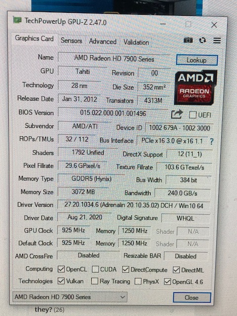

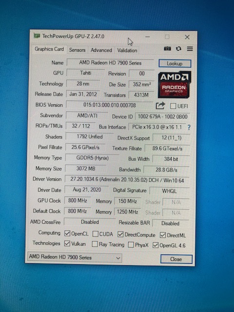

Justplaying with one card and ran teethe tech power up for bios 1 and 2. Bios 1show GPU clock ar800MHz. Bios 2 shows 925MH a it should be foe a boost card. So what's up with this?
Then highly likely both are the boost version cards. ROM 1 is the reference setting, ROM 2 is the boost setting.
