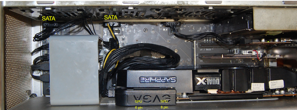

When using the Sapphire 7970 it is powered like this ..
a. 2 X Mini 6 pin to 1 x 8 pin
b. 2 x SATA to 1 x 6pin ( NOT 2x SATA to 8 pin ! )
Both of the above cables go to an EVGa PowerLink's "Power Inputs "
From the PowerLink i use ( EDIT ) 1 x 8 pin male to female + 1 x 8 pin to 1 x 6 pin to the 7970.
Note 1 : I had to cut away a small piece of the Sapphire's fan shroud to fit the EVGa Powerlink
to the 7970.
Note 2 : To use the 2x SATA to 1 x 6 pin cable you can move two HDDs / SSDs to the DVD drives cage
there are even 4 spare, standard HDD drive screws attached to the DVD drive cage.
Note 2.1 : This assumes that you will now be without an internal DVD drive - I use an external ASUS
USB powered DVD drive, works faster than my original drive.
Note 3. The EVGa PowerLink comes with a spare 6 pin power input socket which can be used to replace
the factory installed 8 pin power input socket.
The reason that I replaced the standard 8 pin input power socket is that if one uses a 2 x SATA to 1 x 8 pin you run the risk of drawing too much power from the two cMP SATA ports for the 7970's 6 pin socket.
Note 4 : You don't have to use an EVGa powerLink but I endorse it as if will 'smooth out' power surges.
