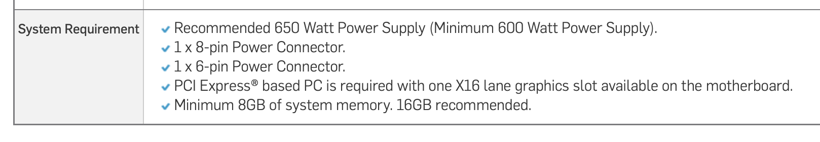

Most RX 5700 XT's require 600W minimum (650W recommended) and most are 8+6 pin configs. They'll run around 250W under average load. Personally would not run more than three of these on a single PSU, regardless.
Radeon VII and Radeon 5700XT does not require 600W power supply. It is requirement for entire platform and not for graphic card.

RX 5700 XT:
Yes: System Requirement – CPU (overclocked), GPU, motherboard, memory, disk drives, external ports, additional PCIe cards, etc...

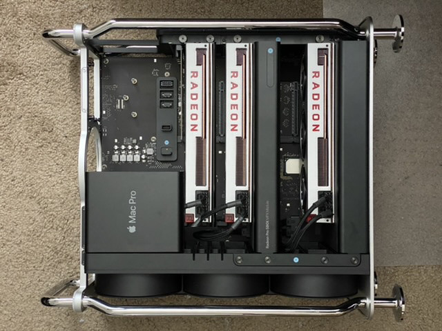

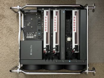

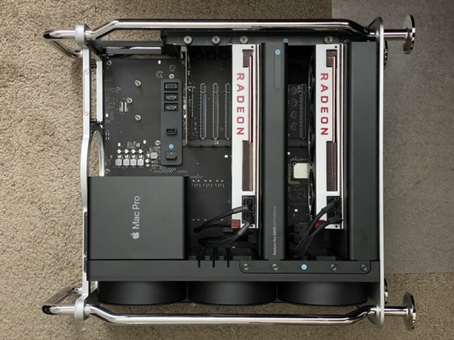

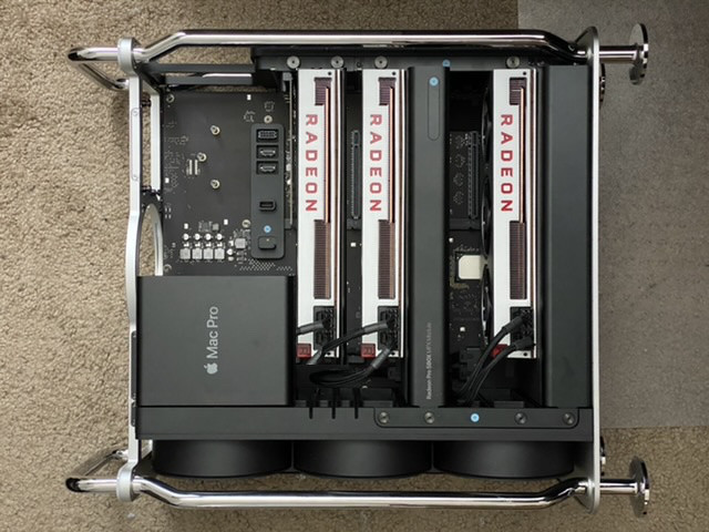

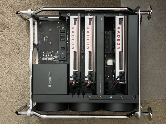

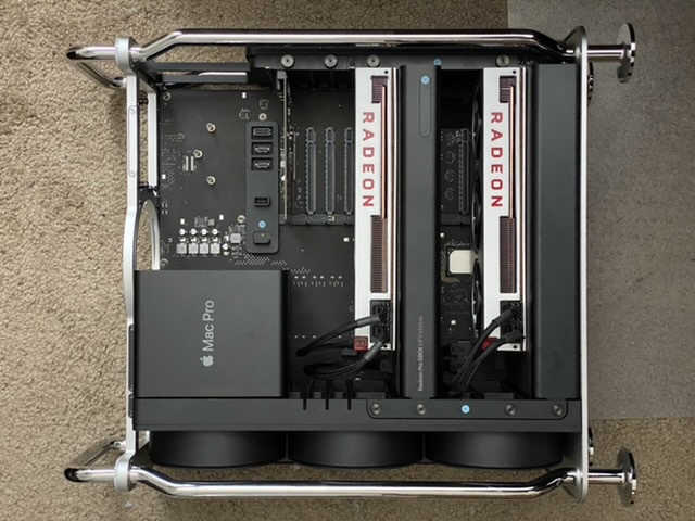

This is what my two VIIs with the factory 580 MPX module looks like.

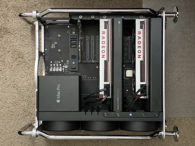

The slot you edited it into is a PCIe x8. Not sure the real world hit in performance you'd get.
If you wanted 4 of them in PCIx 16 they'd need to be stacked side by side.
Does this work? I just installed ONE Radeon VII into my new MP last night. I'm also running the base 580. I just got off the phone with apple support and they told me that the base 580 only lets you run one module and not another GPU in tandem. So he explained that I could either use the 580 OR the Radeon VII but not both. How are you running TWO Radeon VII as well as the base 580?? Would love to know.
Does this work? I just stalled ONE Radeon VII into my new MP last night. I'm also running the base 580. I just got off the phone with apple support and they told me that the base 580 only lets you run one module and not another GPU in tandem. So he explained that I could either use the 580 OR the Radeon VII but not both. How are you running TWO Radeon VII as well as the base 580?? Would love to know.
It works fine. You can have the 580X plugged into either one of the MPX slots, and still draw power from both of them via the Belkin power cable kit.
I’ve been running it like this for a couple weeks now.

Hey mate, really appreciate the reply. The reason I rang Apple support was to figure out how I know that my MP is using BOTH my base 580 as well as my Radeon VII. I jumped into FCPX last night and think it was only using the 580X and ignoring the Radeon VII. Forgive me, I'm fairly new to the multiple GPU game. I just saw a video on YouTube where a girl is using her base 580X to run her 4K screens but is using her DUAL Radeon VII (like yours) to run all her programs, editing, Adobe, After Effects, Premiere etc. Can you please help out the uneducated and tell me how I do this? Do I need to go into the settings and tell the Mac to USE the Radeon VII or do I assume it's automatically already using it. My base 580 is in the original module slot above the power and my Radeon VII is in the 16PCI slot where your image shows you have your top Radeon VII. any help is greatly appreciated. Thanks again.

Adobe seems to use whichever GPU your monitor is plugged into as the primary GPU. So for example won’t use all 3 for playback/timeline performance, it’ll only use the one. Premiere only uses multiple GPUs for some export rendering
I use iStat menus to monitor which GPUs are being used.
All 3 of my monitors are plugged into the bottom VII, so it’s the only one active in Premiere, Photoshop, etc (Adobe applications are pretty terrible at using the extra resources like multiple GPUs)
Capture One Pro is an example of a program that uses all 3 though. It uses all 3, regardless of what is plugged in where. DaVinci Resolve Studio also uses multiple GPUs.
