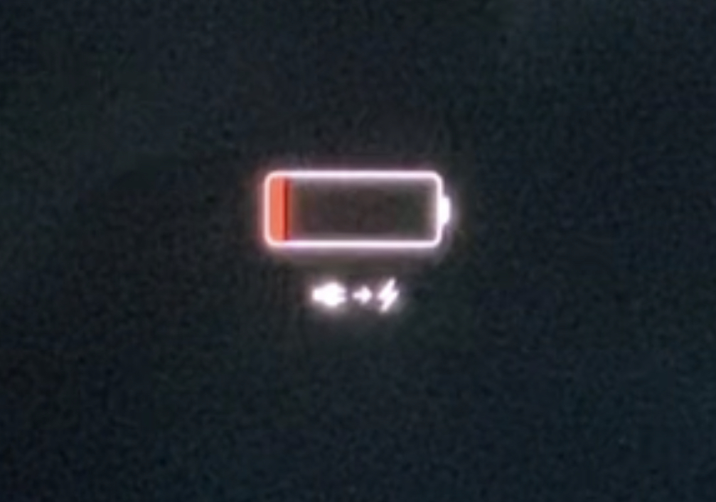

I have a 2018 15" MBP which randomly shuts down or goes to sleep. When it shuts down it appears to Crash Stop and when trying to reboot it shows the System Low battery graphic.
When plugging in the mains plug and booting it shows the battery has plenty of charge (in excess of 50% charge). The machine shutsdown/crash stops once or twice a week but has only done so when running on battery power and has never had an issue when running on mains.

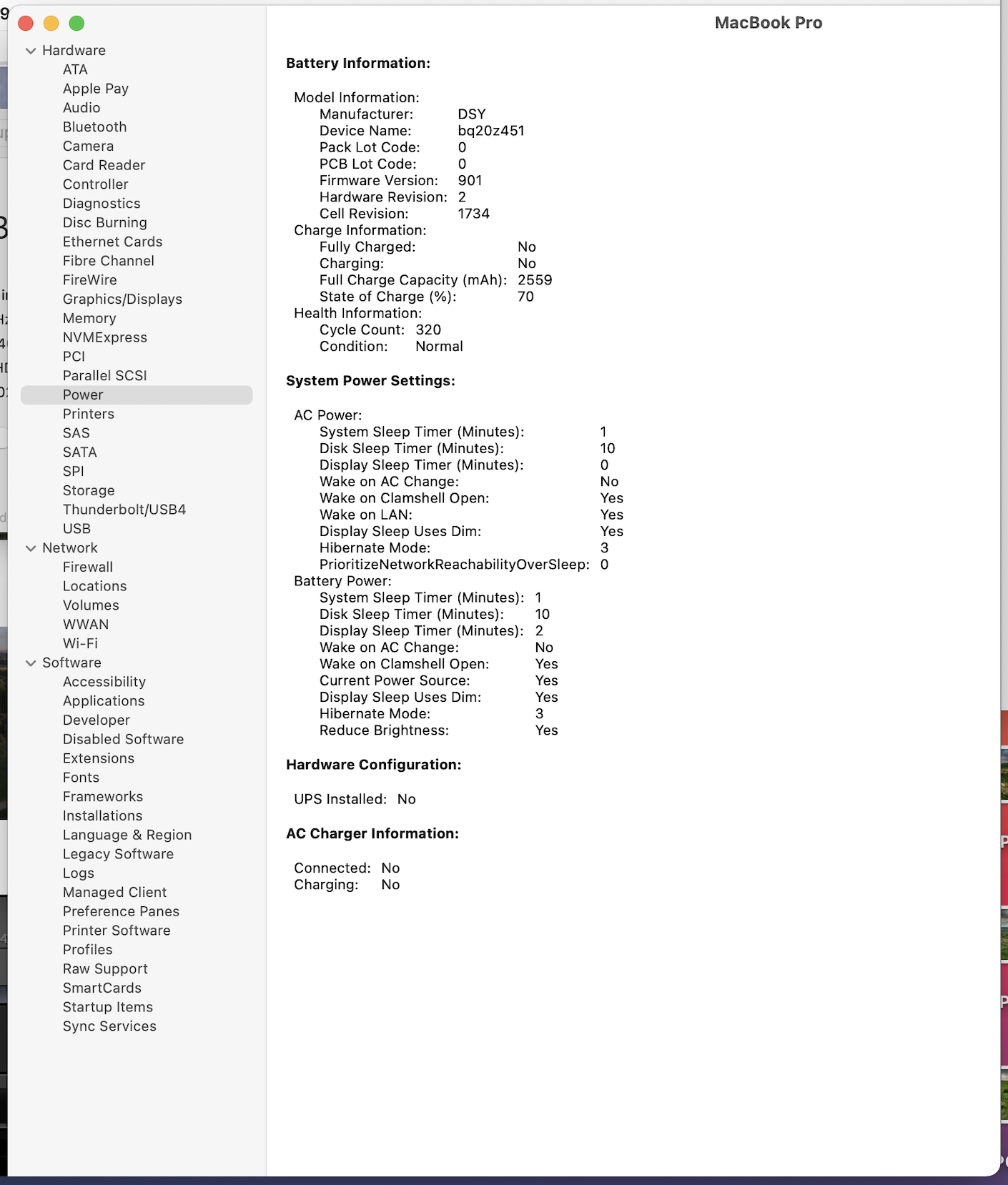

I have noted the battery capacity from within system report usually around 6,000mAh but I have caught a screenshot of it dipping to 2500mAh at times, although Apple tech seems to say its a software issue and not a battery issue.

can you install CoconutBattery and check what info that gives? that app is great and a lot more reliable than macOS's system profiler at reporting battery stats.
I have coconut battery installed and the values are comparable
