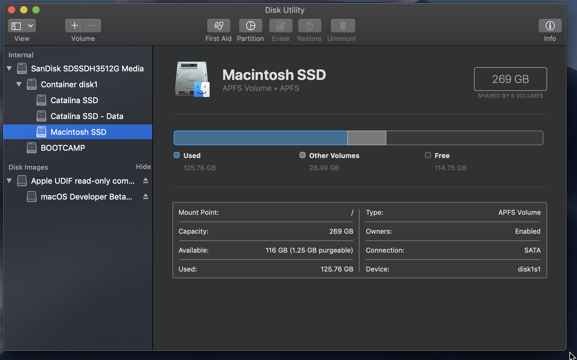

Catalina is on an APFS volume on a secondary Mac for me. That works fine. During the install just be sure to select “show all disks” and choose the volume you just created. Your Mojave system should stay just fine. Note that Catalina will split that volume into two, one read-only with the system files, and the read-write data volume. So you will end up with 3 volumes altogether.
The one caution, albeit a small one, is that on some Macs Catalina brings new firmware. While this shouldn’t affect the Mojave system detrimentally, that is one reason why I both use a secondary Mac (in my case, my laptop versus the desktop I use daily), and separate APFS volumes.
I just have 1 apfs container on my Mac and created a separate volume in that container for Catalina works great image is a pick of disk ut8ility in major atm, but everything works fine in both doses
