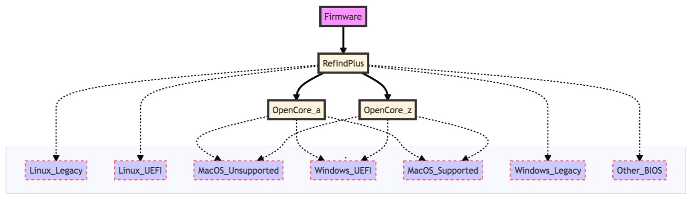

I believe you may already have a MyBootMgr configured setup active. If so, you will already have OpenCore in place as a component of the setup (RefindPlus is the other component). MyBootMgr is tool/process for setting OpenCore up, which it does along with RefindPlus.
RefindPlus and OpenCore work together in a MyBootMgr created setup by doing different things as summarised here: https://forums.macrumors.com/attachments/mybootmgr_multi_oc_2a-jpg.2106559/. OpenCore is used to boot unsupported Mac OS in the setup while RefindPlus does some other things.
To add Monterey to an existing MyBootMgr configured RefindPlus|OpenCore setup, go to the MyBootMgr thread and follow the instructions in "How Do I Install Mac OS XYZ" under the "Hints and Tips" section of Post 1 in that thread. In summary, you boot into the OC_VMM instance of Opencore and run the Monterey installer.

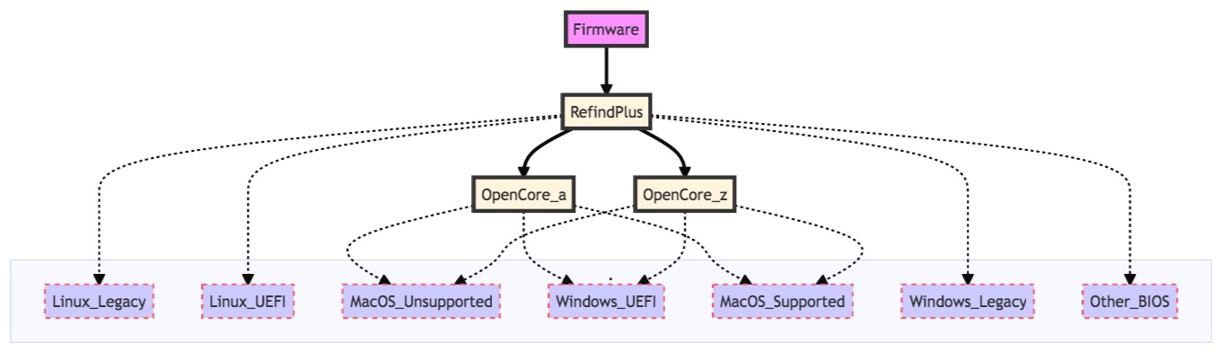

A variant of the process ... OC_ALT is now OC_VMM:
You might need to rerun the ConfigFactory tool first and deploy the setup again if you did not indicate that you wish to install Monterey when you previously ran it as it only sets things up that were indicated or detected when running it.
