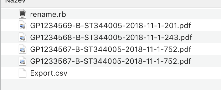

I am trying to rename groups of PDFs from a .csv file.
Working on a MacBook Pro / El Capitan
The original .pdf name is long and has more characters than the .csv reference.
The .csv file has many unneeded columns of information.
I don’t want to have to alter the .csv or original .pdf name.
The Folder Action:
move the .csv and .pdfs into the folder
Reference .csv column header:
Export.csv, column A, GP Number, GP1234567
Match to original PDF name:
GP1234567-B-ST344005-2018-11-1-752.pdf
Export.csv, column H, Code, 987654321
Rename PDF: 987654321.pdf

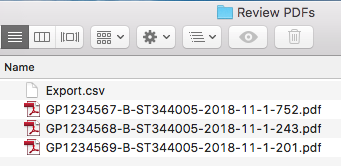

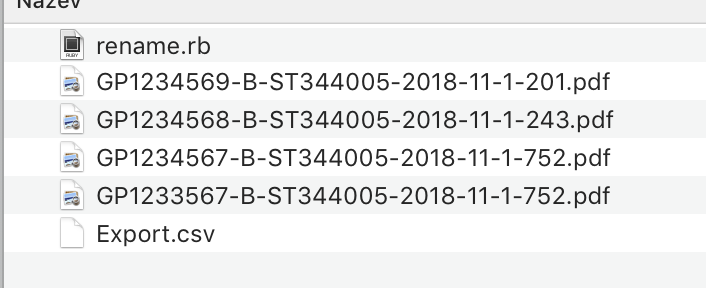

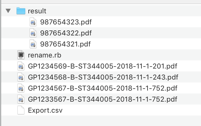

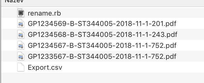

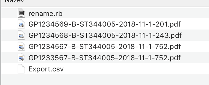

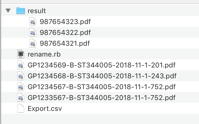

Put the file in a folder together with your Export.csv (the name is hardcoded in the script, you can change that if needed) and with your pdf files, like this:

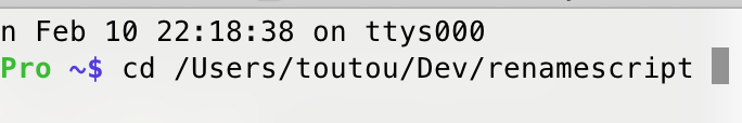

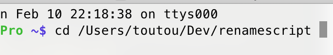

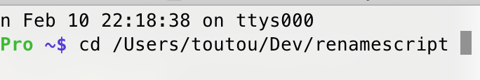

Then open Terminal. Type cd, then a space, then a path to the folder with your files. You can type the path manually or just drag and drop the folder into the terminal window.
Press Enter, the terminal thingie will jump into the folder and await further instructions.
Type ruby rename.rb
This tells the terminal to run the file as Ruby code.

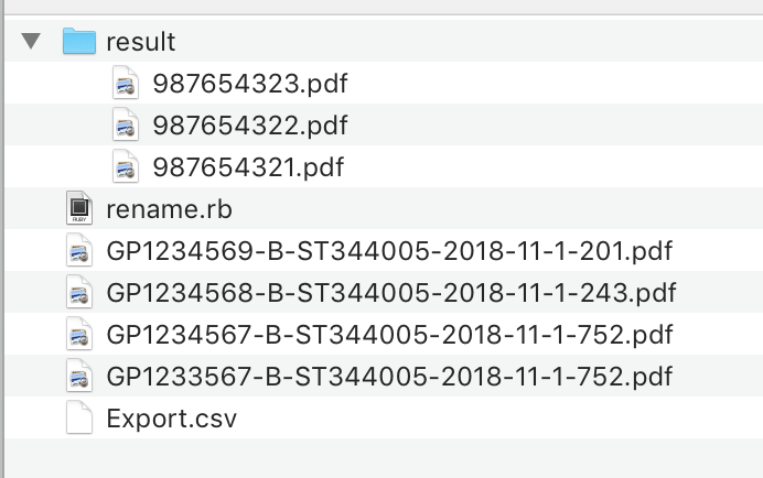

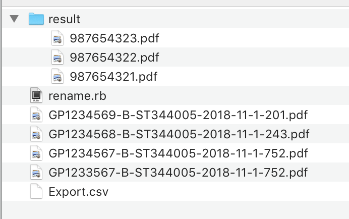

After the script finishes, there should be a new folder result right next to the files, with the renamed COPIES inside.3.png

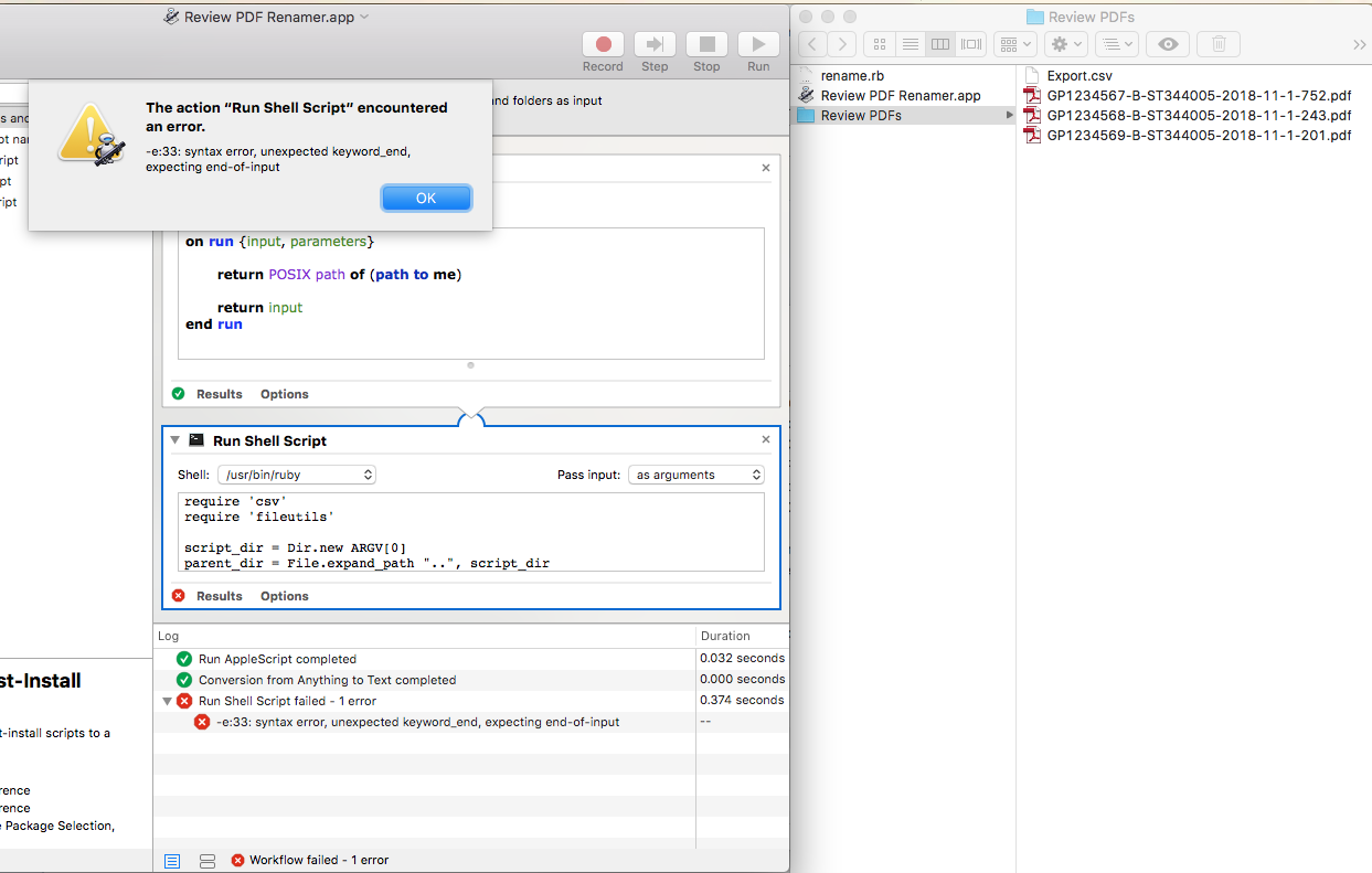

When I drag the 'Review PDFs' folder into the Automator App on my desktop, there is an error.
Would you be able to tell me what I'm missing?

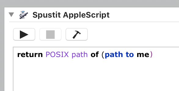

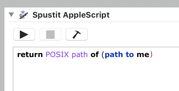

Okay, I've never even touched Automator, but try this: (works for me)

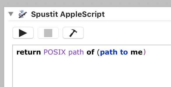

Start with Run AppleScript, put this into the field:
Code:
return POSIX path of (path to me)
This is needed because the Ruby script would, by default, run in your home directory, instead of where the .app file is.

I am having no luck. What am I doing differently than your run test?
First, the Apple Script part: this is enough, you don't need to specify the whole on run handler.
Second, double check the Ruby part. It looks like you've been doing some tinkering with my code (the ARGV.each do on your previous screenshot), and you might have left an end keyword right at the, well, end. At least it's what the error message is telling — it was expecting the script to end, but encountered an end keyword Try erasing everything, then just copy and paste my code.
