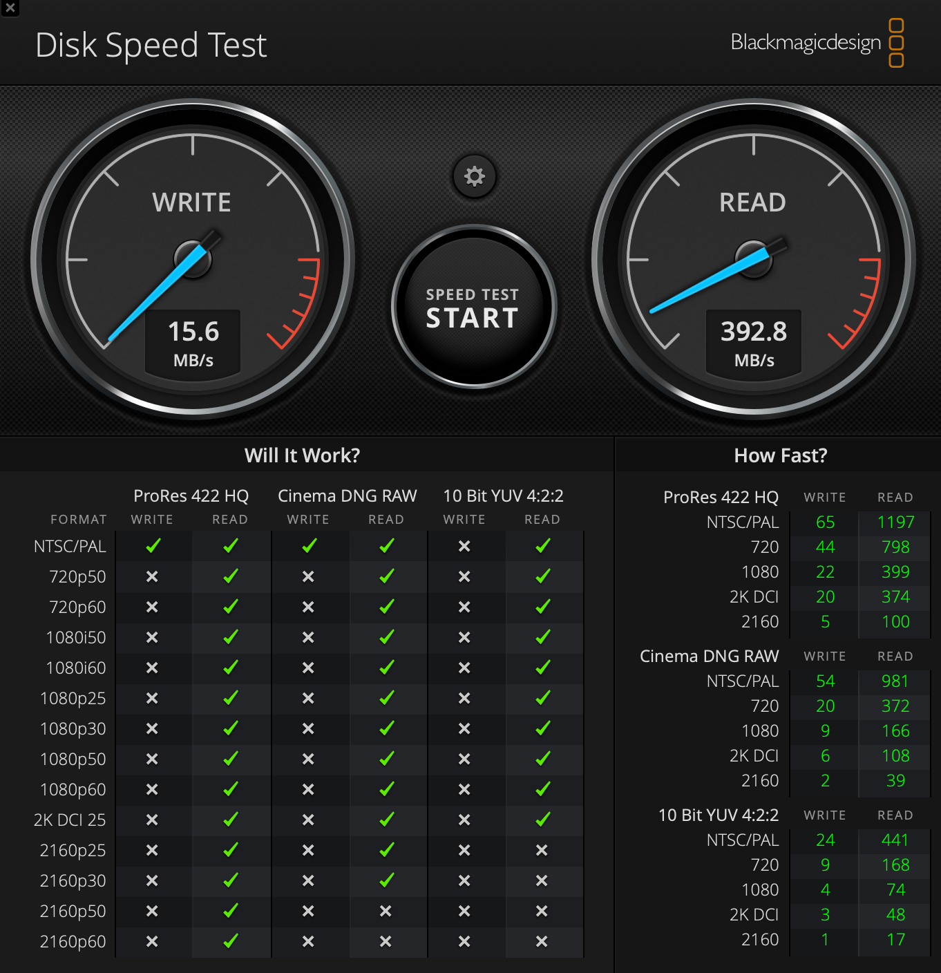

This is the speed I am getting. Write speed is obviously problematic. Any advice?
Are you getting this right from the start or does it start out at higher numbers and then drop? And which USB enclosure are you using?
