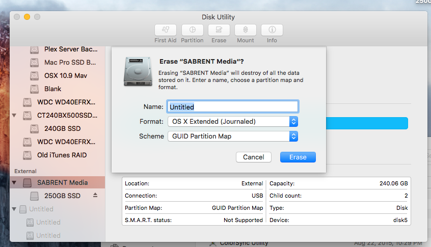

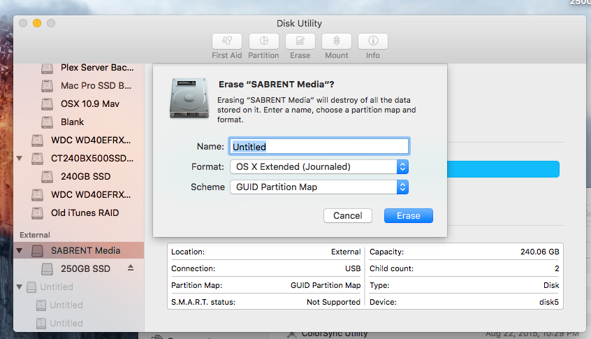

4.2 Format and HS Install - If you already installed the OS on the SSD, skip this step. Format the SSD in Disk Utilities if you have not already in a previous step. Install High Sierra on the SSD, and migrate your data.

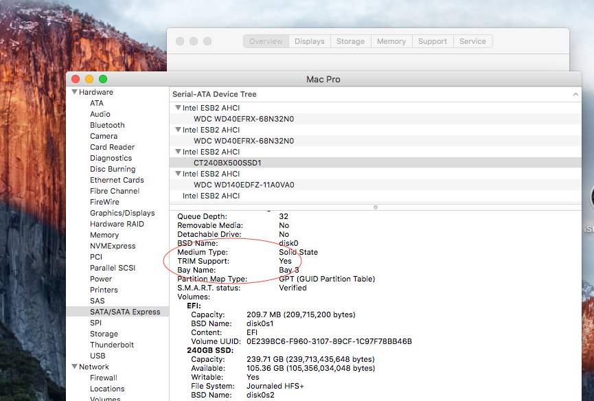

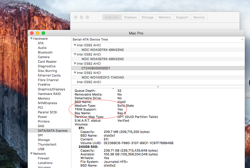

4.3 Enable Trim - This requires using Terminal, but is super easy and is basically copy and paste. Open Terminal and type or paste the following then press enter:
You can check to make sure that TRIM is enabled by Apple Symbol > About This Mac > System Report > Hardware > SATA/SATA Express > Your SSD > TRIM Support.... Or look at this:
