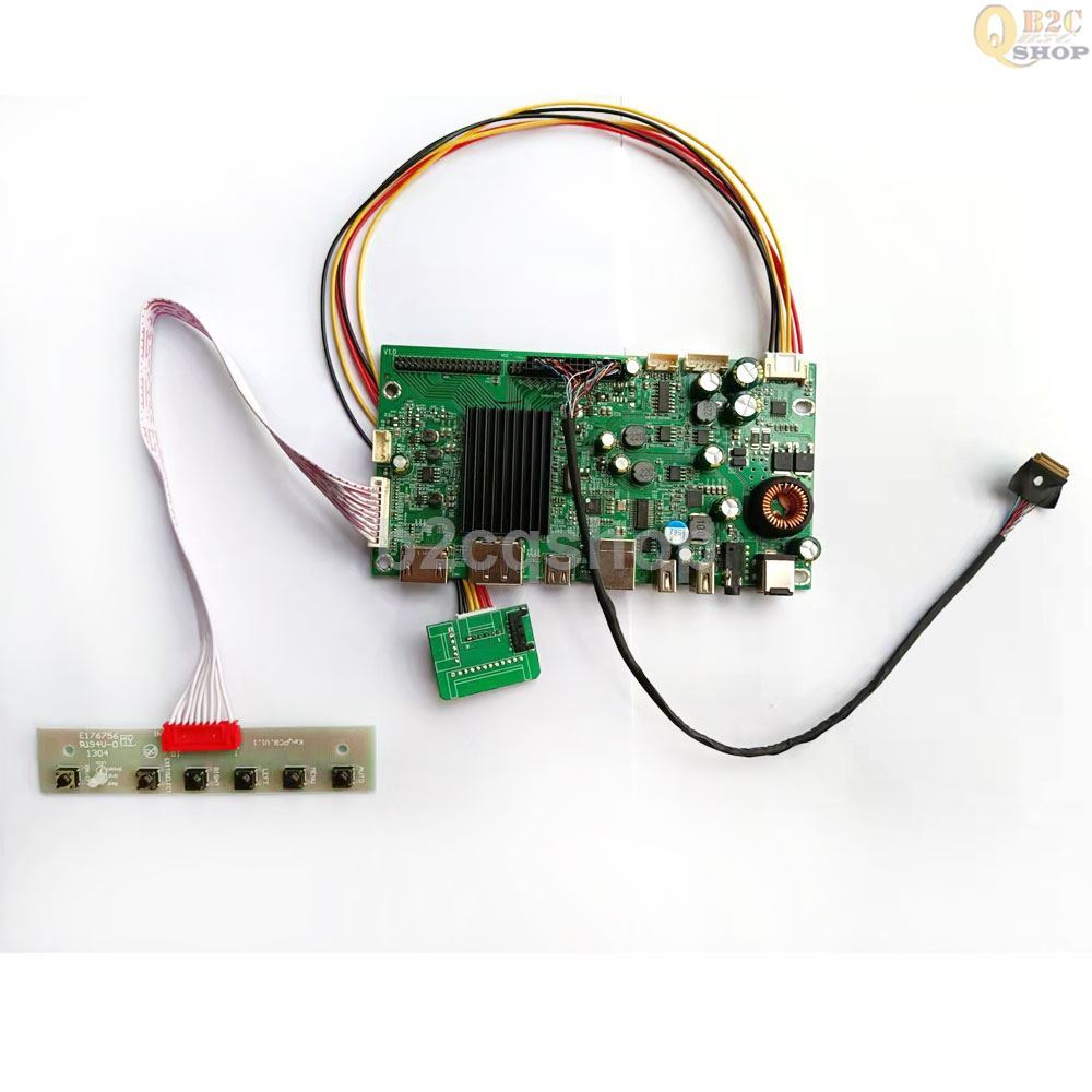

The kit to test cost 27$. I bought one myself.
It also serves as the required parts to convert the LCD to a working monitor with HDMI and VGA port.
You can also buy a more luxury LCD driver board with Display Port and HDMI, cost about 72$.

To be as helpful as possible, I can advise that to convert the LCD to a working monitor as suggested in post #7 is a very difficult modification indeed, which requires the removal of all the iMac internal components!
I note your comments that, "I know how to use computers, not how to fix them", so this is certainly not a task for you if you've never dismantled an iMac before!
Another potential showstopper is that even if you had a friend prepared to do this for you, be advised that THIS link to the required kit shows that it's no longer available. There are possibly other sellers of a similar kit, but I'm unaware of them.
Just for info (and perhaps to blow your mind);) here's a LINK to the actual task being performed.
To answer your original question, is it worth buying? Yes if it's cheap. If it's being donated to you, and you're a little adventurous then definitely yes, and then try the internet recovery procedure as given by Fishrrman in post #3.

There are more than a several billion items sold on Aliexpress.com. So far I've only got the link to the cheaper kit. Need some time to get the second (more expensive) one.
And I plan to make a new post with detailed info and guidance, with photo etc...

I found both links to the kits eventually. Maybe my bigger post can wait for a little longer.
In both links, you need to know the exact model of your LCD panel, i.e. actually open your iMac and look at the back of the LCD panel. Connection guidance is already inside the seller's info.
The cheaper kit (25$ + shipping)
Luxury kit (64$ + shipping)
I got myself a dead iMac 27" 2011. PSU is dead, logic board is dead, GPU is not tested yet, but it could have been the shorted out GPU that led to the death of both PSU and logic board, so I don't bother testing it anyway.
The LCD was still bright and beautiful. So I bought the cheaper kit to convert it to a hacked Apple Cinema Display.
