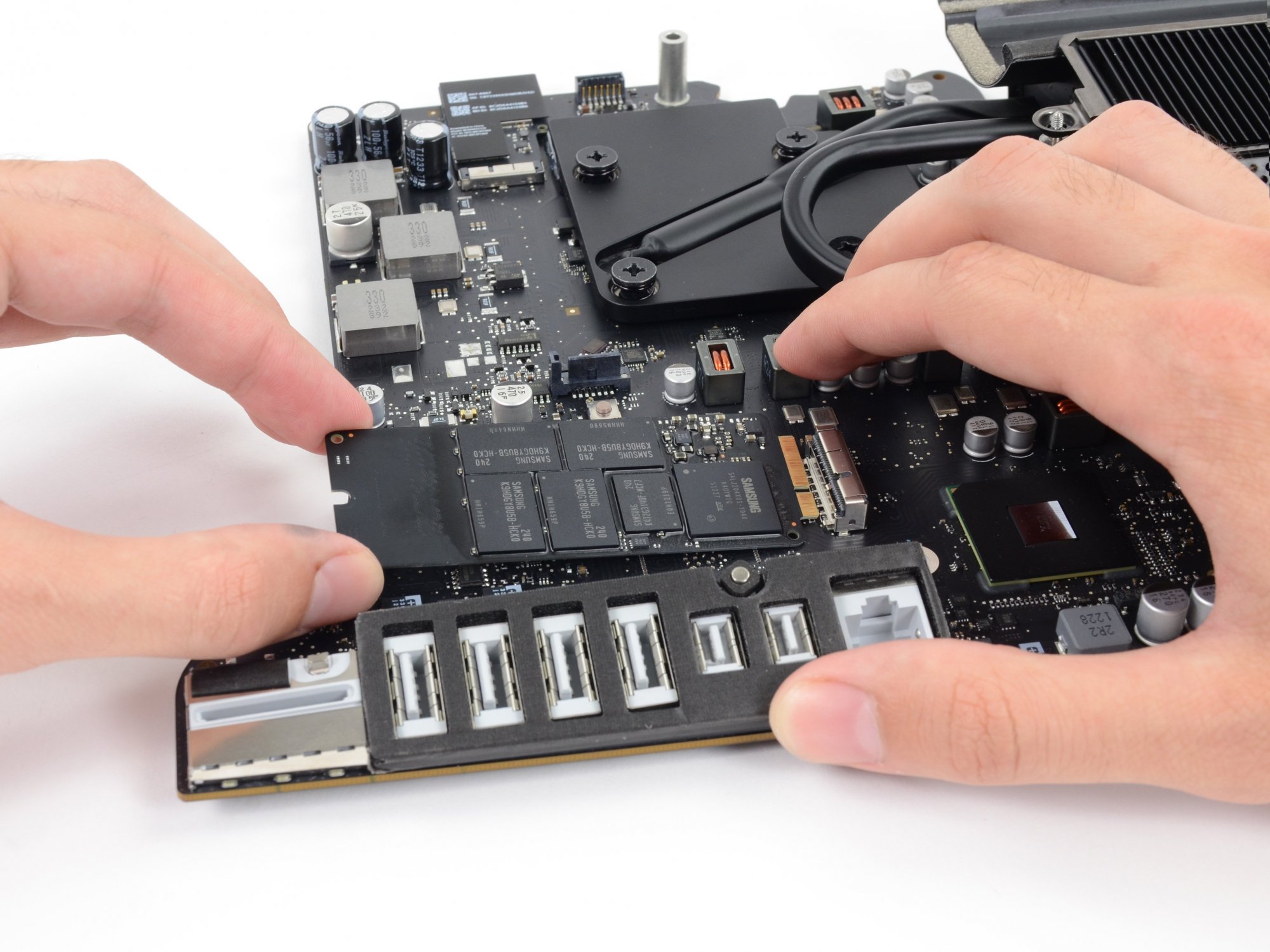

SSD Flash storage is on the underside of the logic board, logic board out to replace,
if you don't know what you're doing pay the $400.
https://www.ifixit.com/Guide/iMac+Intel+27-Inch+Retina+5K+Display+Blade+SSD+Replacement/30537
YAlDc2SbbjPWyEJS.full.jpegiMac Intel 27" Retina 5K Display Blade SSD Replacement

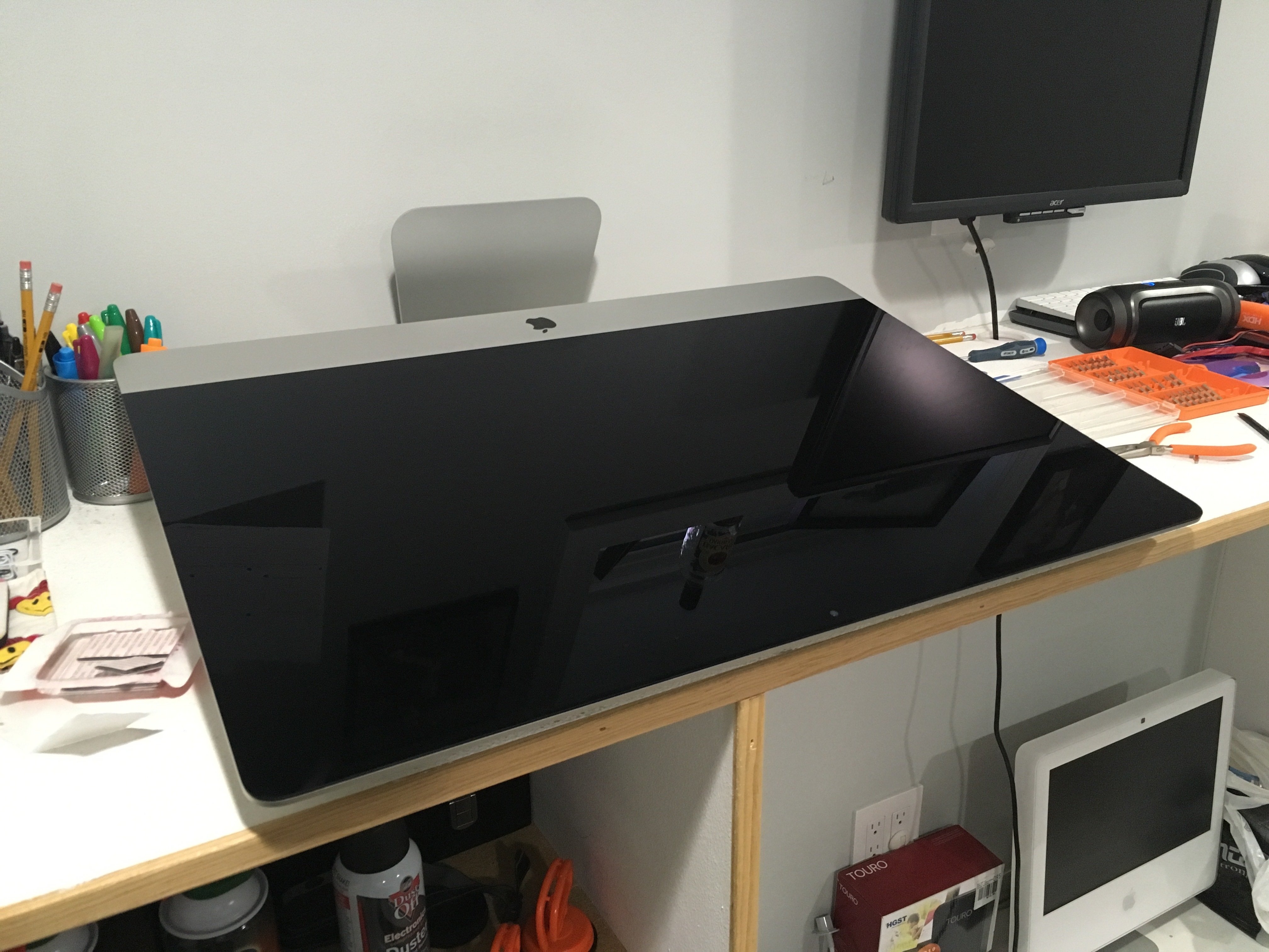

I ended up replacing the hard drive myself and it was a success. The computer works 100% now! I also went for a larger capacity 512GB drive, so it turned out to be an upgrade too. Cost was under $100 for the SSD, the 3 special screwdrivers you need, and the adhesive strips, vs the $500 Apple wanted to charge. Additionally I was able to clean out a TON of dust that accumulated inside over the years, which likely was affecting the iMac's outflow of air and ability to keep it cool, because I was also having issues with the fan coming on way too frequently before.
For those who want to try this, it's very doable. It's a lot of steps and takes a good amount of time, but if you follow the iFixit guide precisely, which is excellent BTW, and are very careful, anyone with decent repair skills and a careful hand should be able to do it. Though I would only recommend doing it if your Mac has a dead part and isn't worth enough to pay Apple to repair it, and not just to upgrade the RAM or Disk to a larger size, because no matter how careful you are, accidents can happen and when dealing with such delicate parts it would be pretty easy to wreck your Mac. The hardest and most risky part is taking the display off and then putting it back on, mainly because it was new to me. Once you have it off it's just a ton of screws and cables to unhook, nothing too crazy. Having done it once though now, I could breeze through it a second time in a fraction of the time.
