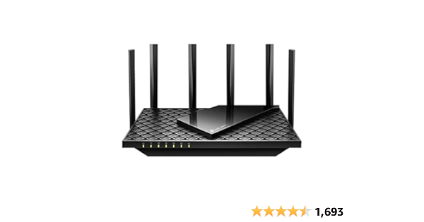

Just a few possibilities...
TP Link routers are "yeoman-grade", nothing super-special, but affordable and they work well enough for most folks' needs.
There is also the TP Link "Deco" mesh system, as well.

I know there is a spread in prices here. Do you have a preference among these routers? Do you prefer TP Link over other brands? Why?
I’d like to stay in the $200 range if possible.

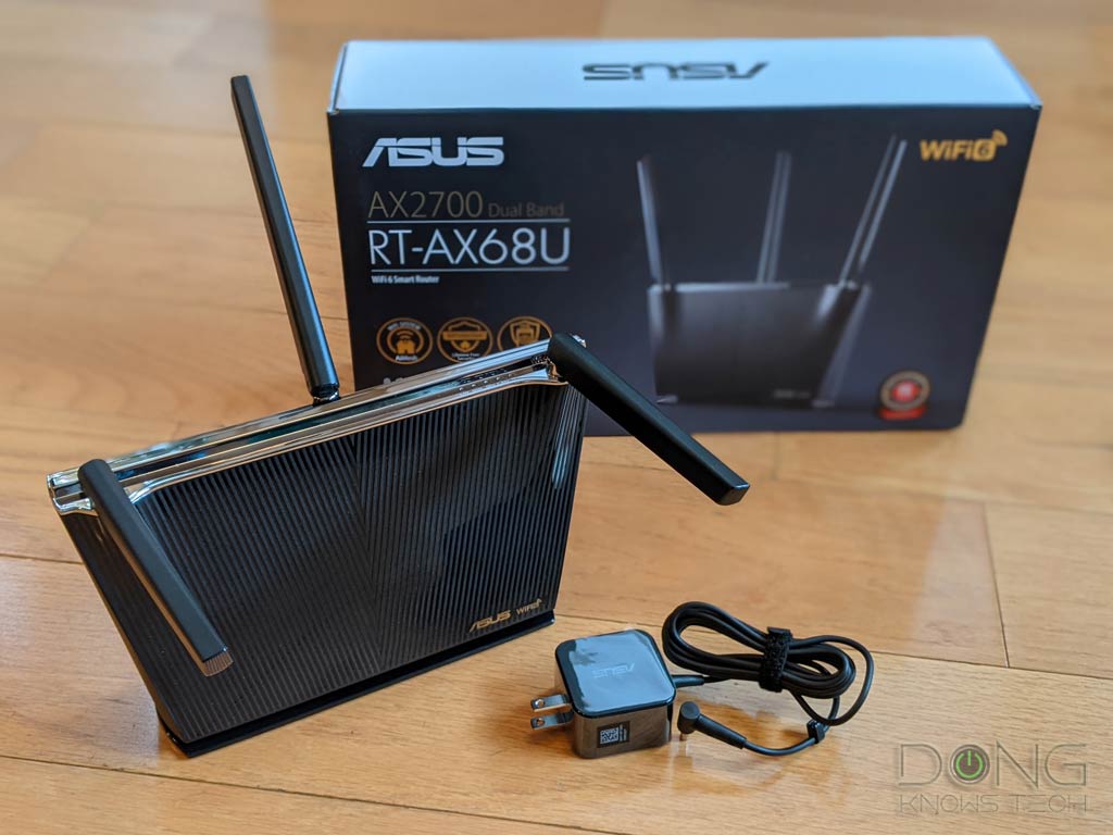

This Asustek router is "midrange" and aren't to pricey.
Can be used in a mesh config and should you need to tweak and mess around with network settings that can be done as well.
This fella reviews quite a lot of routers and seem fairly honest in his reviews.
