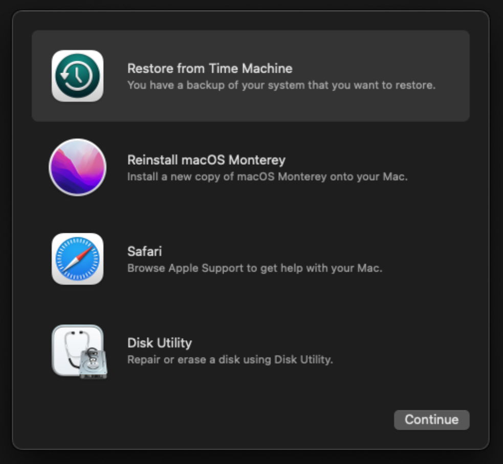

I used to have my own cloning script I used so I could just swap and boot if I had a disk failure. That's no longer an option due to changes in the last few OS versions. Is there a good reputable, non-malware app I can use now? We've been having weird issues in my area and I'm worried about what might happen if internet is down and my mac goes Tango Uniform.
Things have changed, and you need not worry about operating system corruption. Your machine has three bootable operating systems on it–the normal everyday system, Recovery, and Fallback Recovery. The system is verified at every boot, is signed, and is read only so it cannot be corrupted. If the SSD fails, the machine won't boot, even from an external drive.
All you need to protect with backups is your personal data. For that, two good choices are Carbon Copy Cloner, or SuperDuper. Either of those will make full copies of your user data. Also, don't forget that Time Machine is built in to the system.
