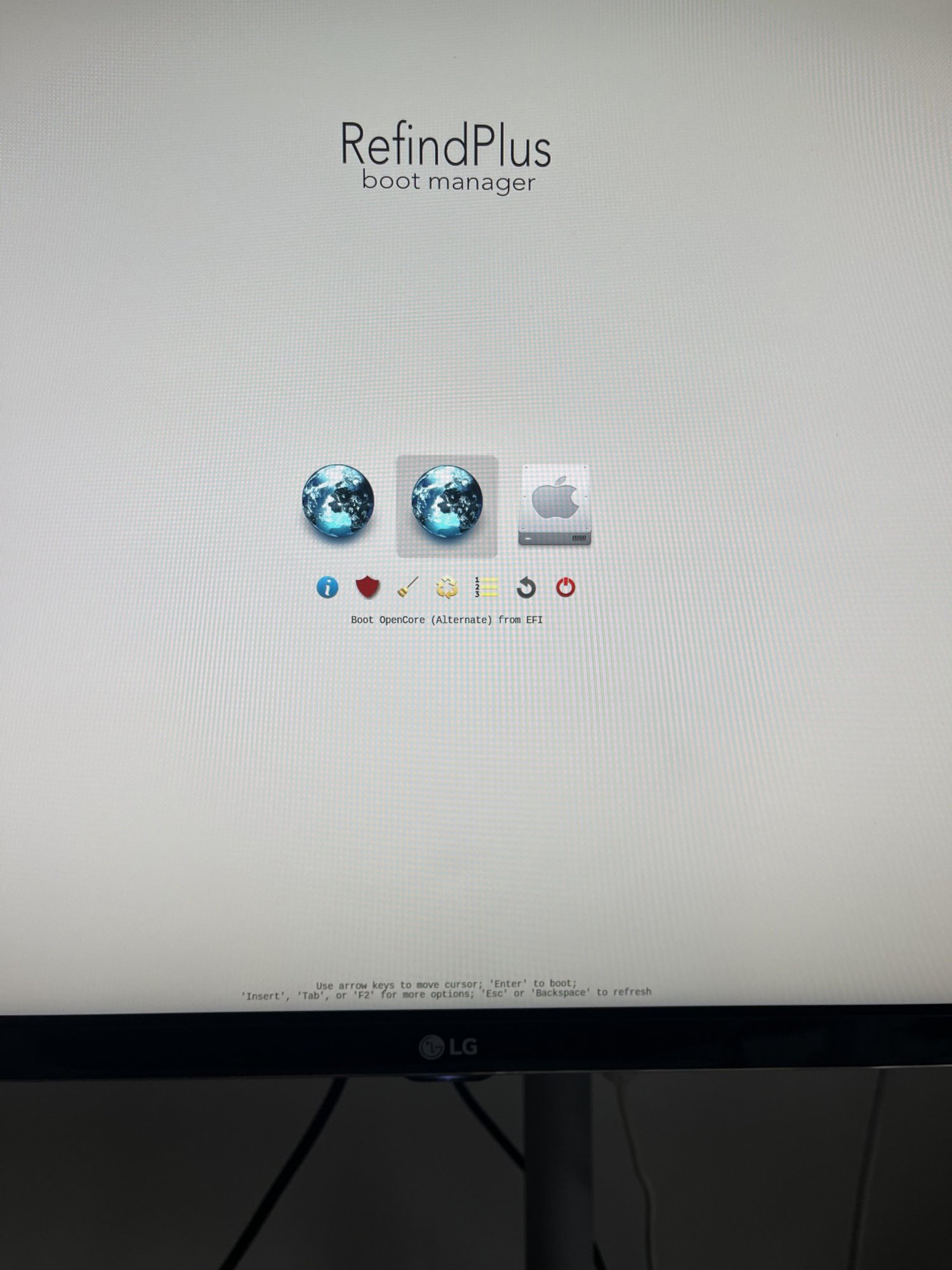

Hello

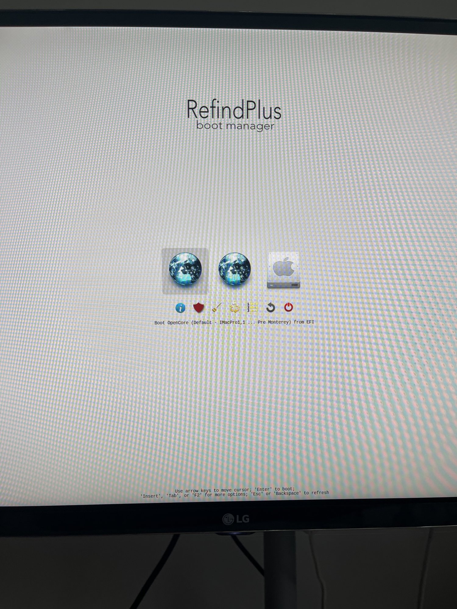

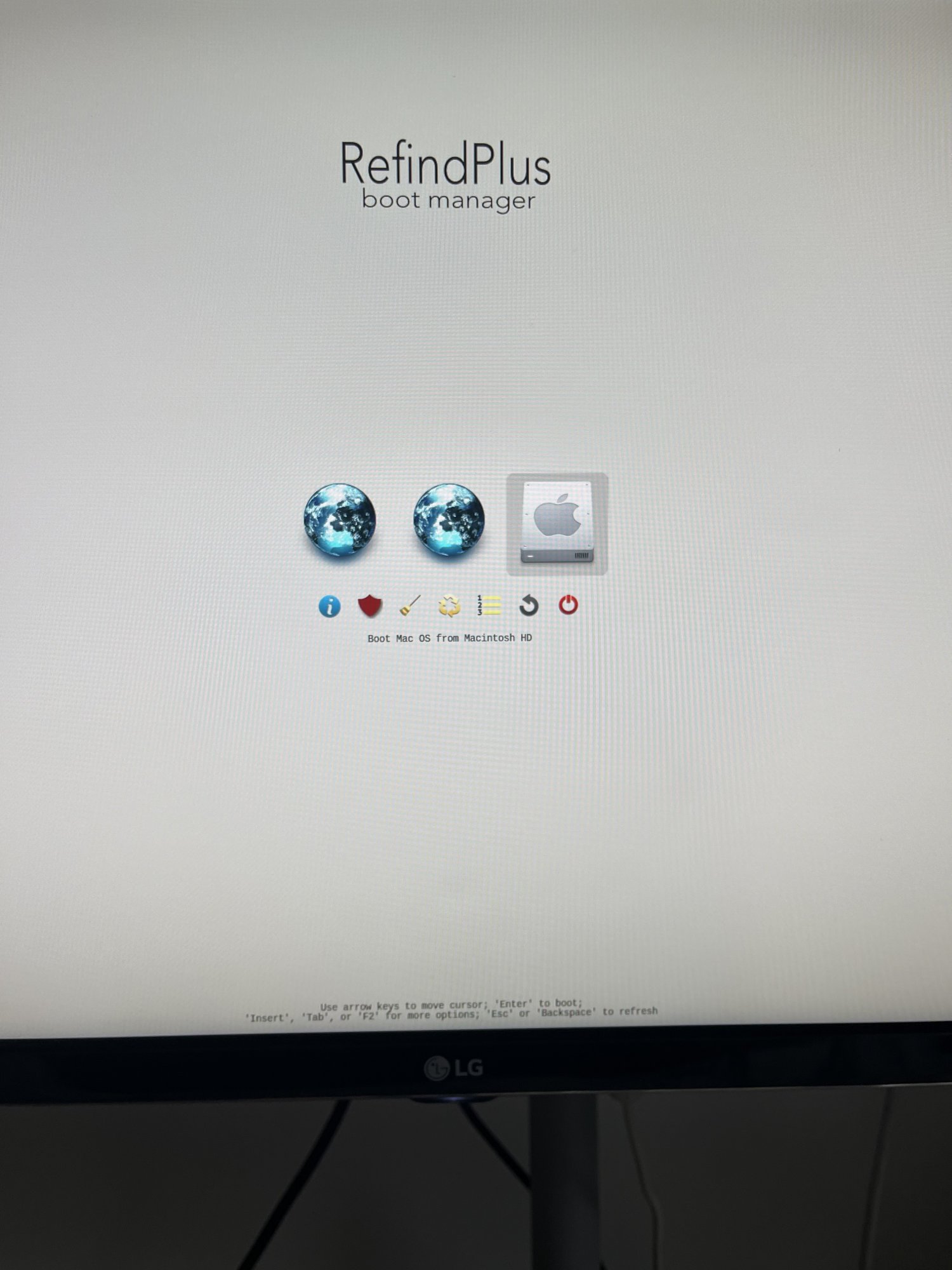

After several weeks of posting the issues I was having and going back to the drawing board because of my inability to follow instructions meticulously, I managed to install Refindplus boot manager (with Opencore) via Mybootmngr, thanks to @Dayo @tsialex and @Macschrauber
I get the following folders in my bootscreen (attached 3 screenshots below)
1. Boot Opencore Default(this option loops back into recovery screen)
2. Boot Opencore Alternate via EFI (Does nothing)
3. Boot Mac OS from Macintosh HD (takes me into my native OS Mojave)
I would like to upgrade from Mojave into a stable OS (Catalina, Big Sur, Montrey), i'm open to suggestions, but more importantly how do i go about doing this?
Ideally, I would like also to install a window legacy OS but that can come later.
My signature has my current setup.

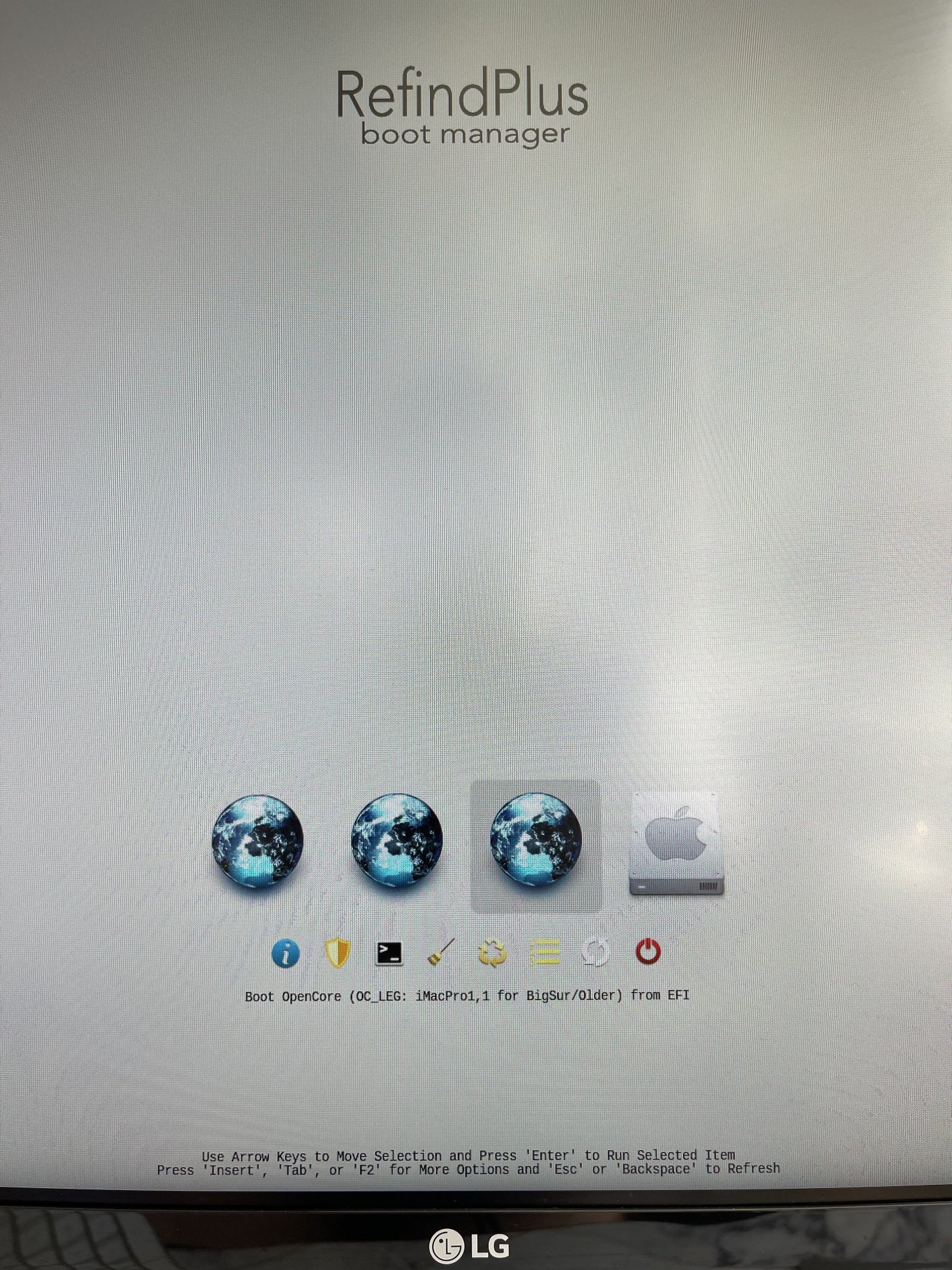

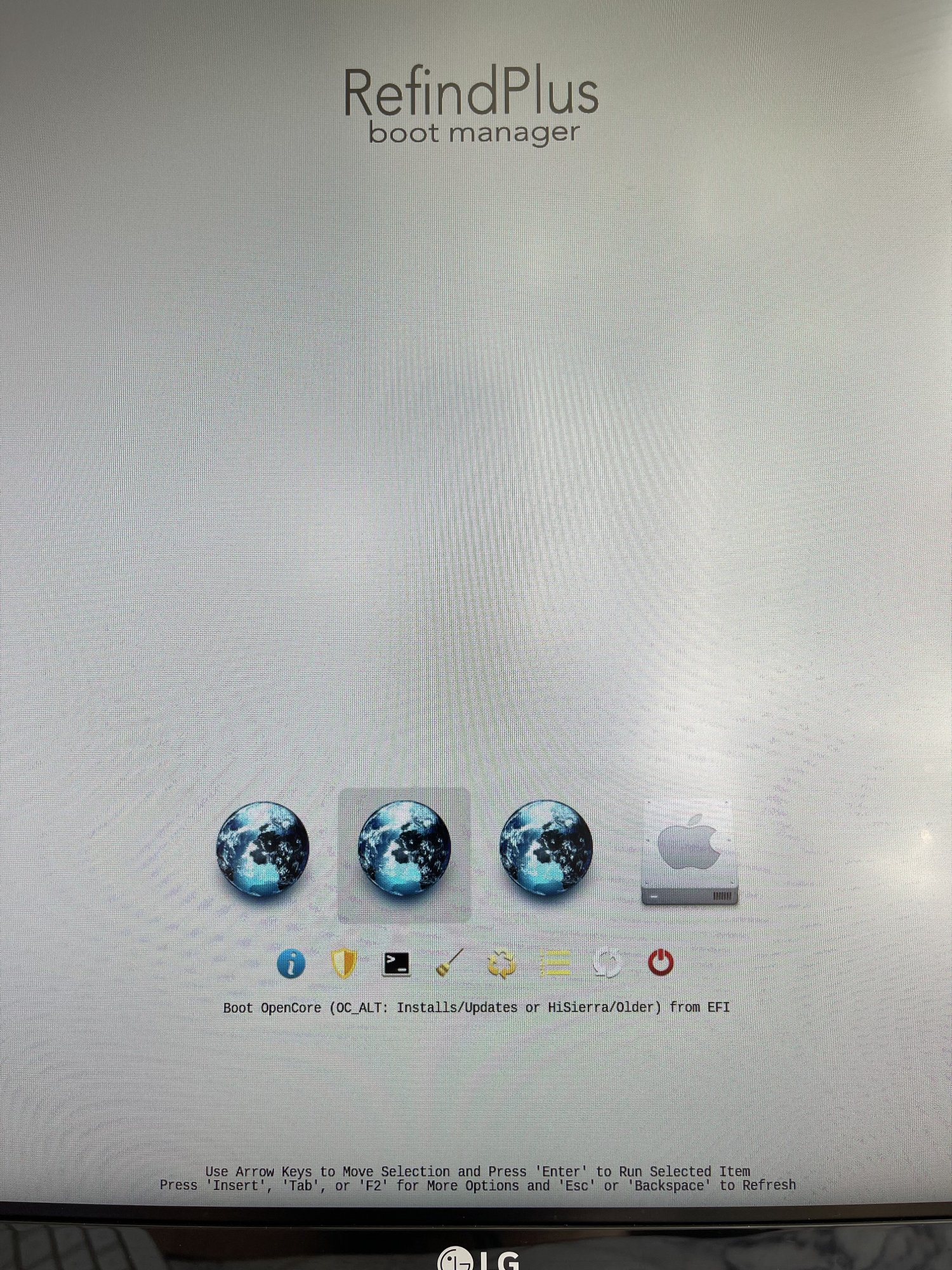

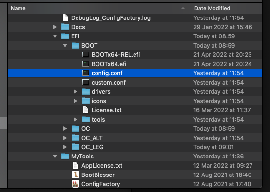

Okay. If that is now working, clean the labels up a bit.
Open the RefindPlus config.conf file and...
  • Change iMacPro1,1 MacPro7,1 to just MacPro7,1
    • Might be iMacPro actually, check your ConfigFactory debug log for the correct one
  • Remove or HiSeirra/Older to only have Installs/updates
You must have indicated that you intend to install BigSur/Monterey when running ConfigFactory which is why you have an additional instance over the two instances you had before.
Each instance is optimised for a specific function:
  • Default OpenCore Instance
    • Spoofs MacPro7,1 (might be iMacPro depending on options selected in ConfigFactory)
    • For Catalina and newer only ... Cannot boot Mojave or older
    • Do not use for installations or updates
  • Alternate OpenCore (OC_ALT)
    • Spoofs VMM for Installations and Updates
    • Can actually boot anything but best to only use for the stated purpose
  • Legacy OpenCore (OC_LEG)
    • Spoofs iMacPro1,1
    • For Big Sur and older only ... Cannot boot Monterey
  • Direct MacOS Boot (RefindPlus)
    • Use to get into Mojave natively whenever this is needed
If you install Windows and/or Linux, these will appear as well. Legacy Windows is recommended as it does not come with baggage but RefindPlus can work with UEFI Windows and block certificates etc. If you do decide on UEFI Windows however, hide the icon in RefindPlus by selecting it and pressing the minus key and always boot it through OpenCore. You can use any of the OpenCore instances for this.
To install some other MacOS version, boot in via the "OC_ALT" instance, download the installer and run the installation. The various NVRAM issues with installations/updates do not affect this instance but it is not efficient for day to day use.
Of course all depends on whether it is working as you didn't mention.
PS: You can always toggle SIP back on. It is always going into that disabled state when booting without any SIP setting in place. It basically automatically toggles it from empty/enabled to disabled on first boot.
Need to look into tweaking that to leave it empty later.
Reactions: Farravi

This is still very unknown territory for me so how would i go about doing that? As in go to the Boot folder and open config.conf file ?

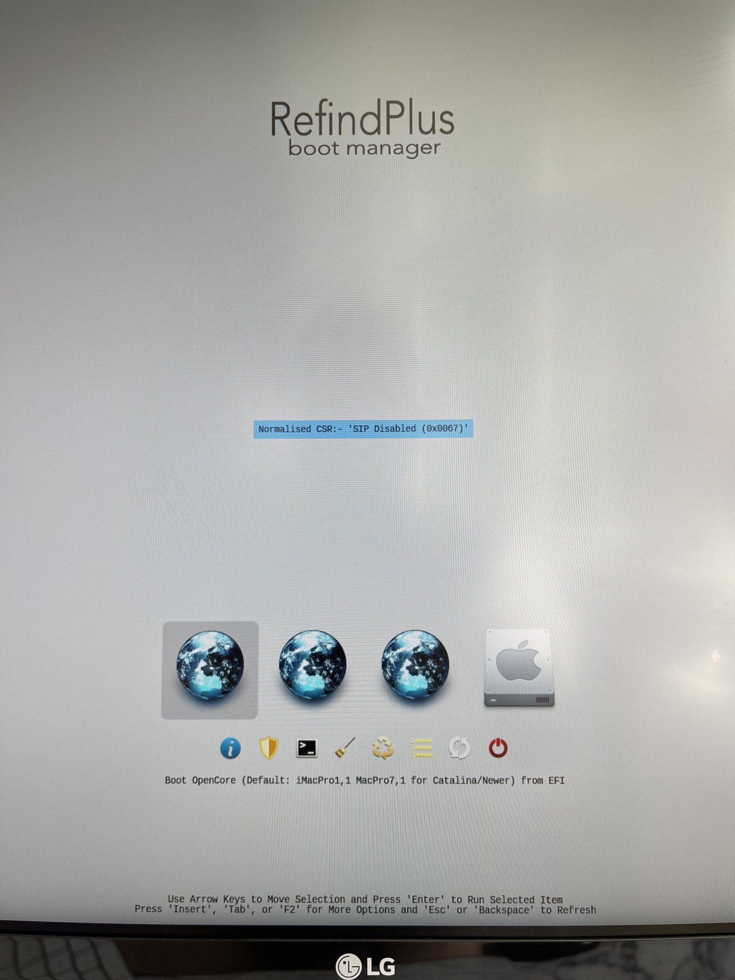

Selecting Boot Opencore shows me the following screen and then restarts the computer back to Refindplus bootscreen as previously
and then it loops back to the Refindplus Boot manager screen.
Selecting OC_alt and OC_leg does not do anything other than say 'CSR - SIP Disabled' and selecting Mac OS takes me to my native Mojave OS.
I want to be able to use BigSur/Monterey as my main OS simply because I have Office 2021 which i cannot install on Mojave as it does not support it as of Dec 2021 and requires Catalina or newer.
Selecting Boot Opencore loops back to the Refindplus Boot manager screen.

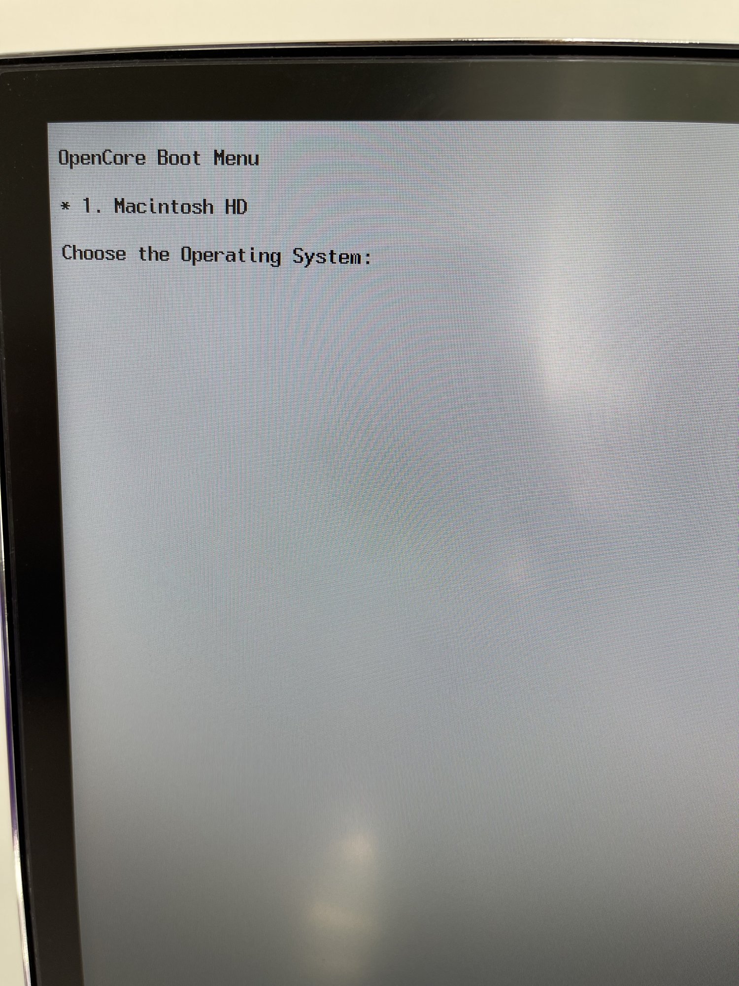

Did you not:
  1. Boot the machine
  2. Select an option to load an appropriate OpenCore instance in RefindPlus
  3. Get the OpenCore Selection Screen when you did that
  4. Select your Mojave instance in that OpenCore Screen
  5. See Mojave load afterwards??
If all that happened, then yes, that is what is supposed to happen but doesn't really need me to tell you that though.
EDIT: Regardless, I looked at the attached image and yes, you got that screenshot from a MyBootMgr created OpenCore setup while booted into Mojave or earlier.
Reactions: Farravi

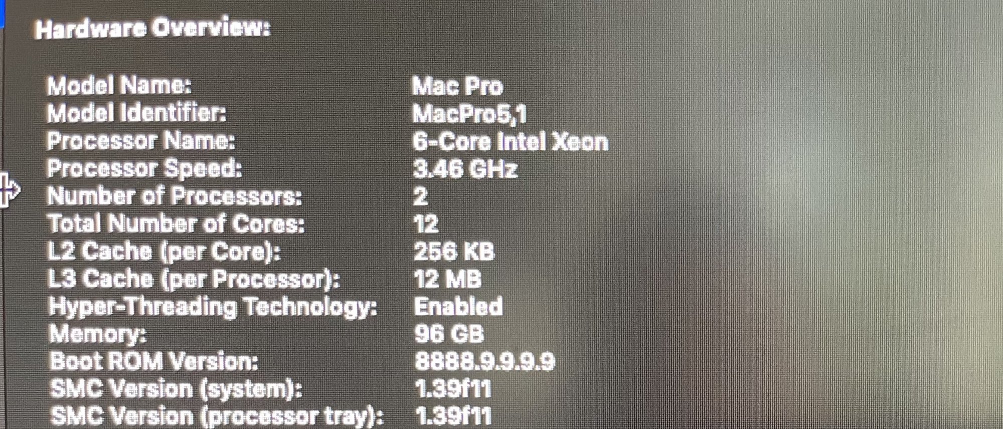

1. Yes
2. Yes
3. Yes
4. Yes
5. Yes, I am typing this from the Opencore instance of Mojave. Copied this from 'system report' (
Boot ROM Version: 8888.9.9.9.9)

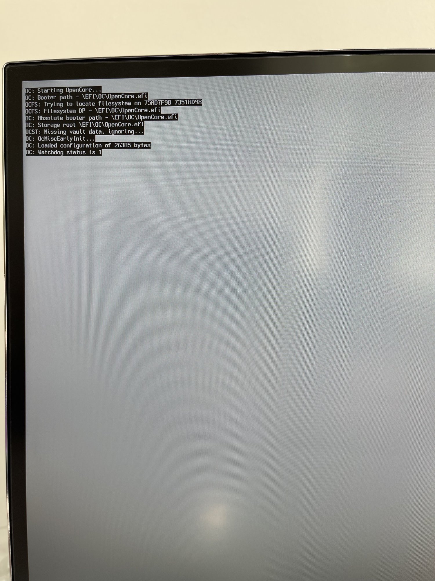

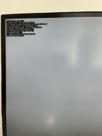

So after rebooting / restarting a few times these are my findings :
> Boot Opencore Default - Spoofs Mojave and does this without any issues
> Boot Opencore (OC_ALT : Installs / Updates or HiSierra/Older) from EFI - loads into a white screen and nothing else

I see. Might be missing something in the packaging.
Copy your /User/shared/MyBootMgr/EFi/OC_ALT folder to your desktop, zip it up and attach here so i can take a look later.
In the meantime, delete the actual /User/shared/MyBootMgr/EFi/OC_ALT folder, duplicate the /User/shared/MyBootMgr/EFi/OC folder and rename this as OC_ALT.
Open the new OC_ALT config file and make the following edits:
  • Search for <key>Cpuid1Data</key>
    • Amend the item under this to <data>AAAAAAAAAAAAAACAAAAAAA==</data>
  • Search for <key>Cpuid1Mask</key>
  • Search for <string>Mac-7BA5B2D9E42DDD94</string> (more than one place)
    • Amend this to <string></string>
Then deploy the setup.

Replicated same issue for OC_ALT - White screen

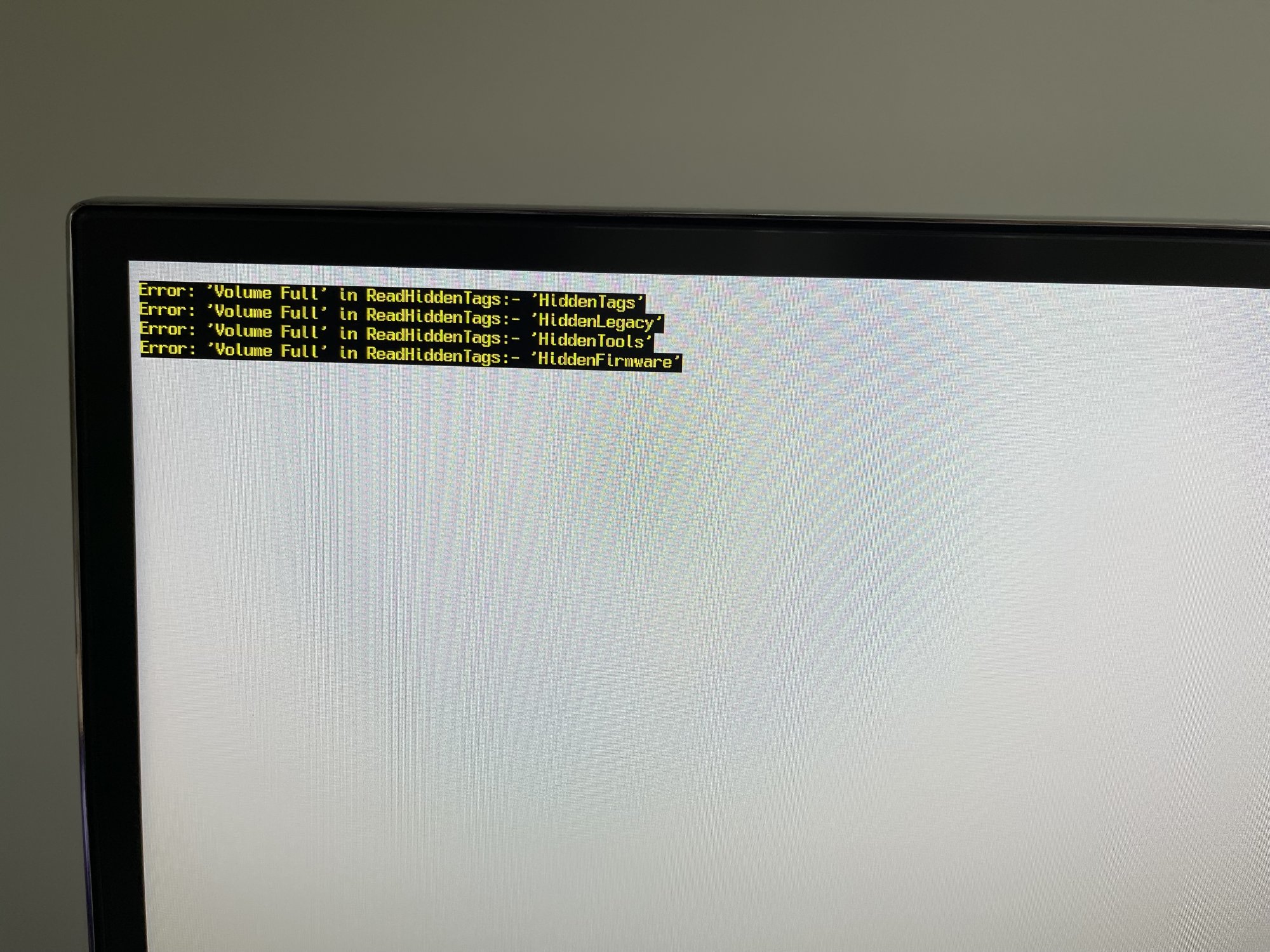

I also get the following error on Refindplus Bootmanager screen.
