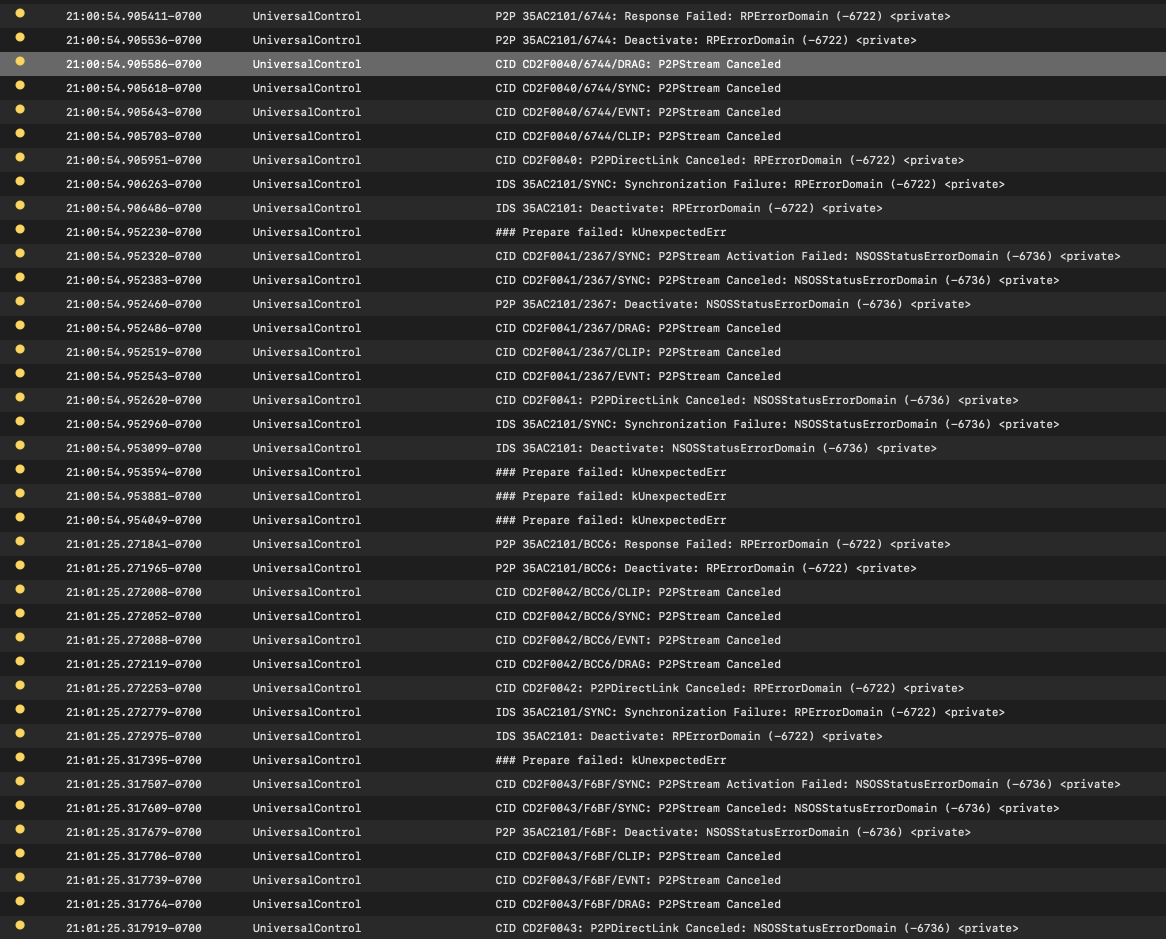

I was troubleshooting UC again tonight after the 12.4 update and after disabling/enabling the built-in firewall on both machines, noticed these entries in the system log:
The entries show up after I bump the cursor into the side of the screen where the iMac should be.
Thoughts on troubleshooting from this?
