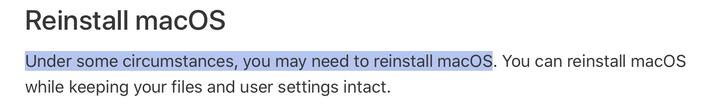

The first paragraph:
Just sayin’ :)

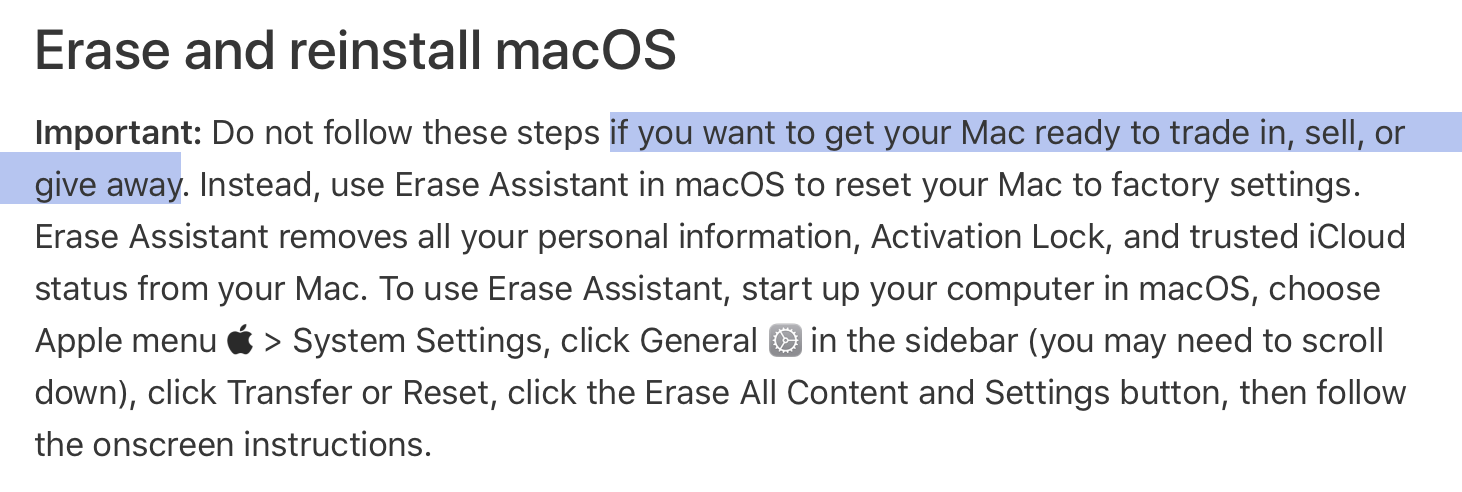

Yeah I've seen that, but the statement is incomplete. Apple often oversimplifies things in their support articles. Here's a more complete statement from Apple, indicating the admonition against doing an OS reinstall on Apple Silicon was not meant generally, but only for those planning to transfer their Macs:
Further they explicitly add:
Just sayin’ :)
Source: https://support.apple.com/guide/mac...licon-mchl82829c17/15.0/mac/15.0#mchl57249f89
