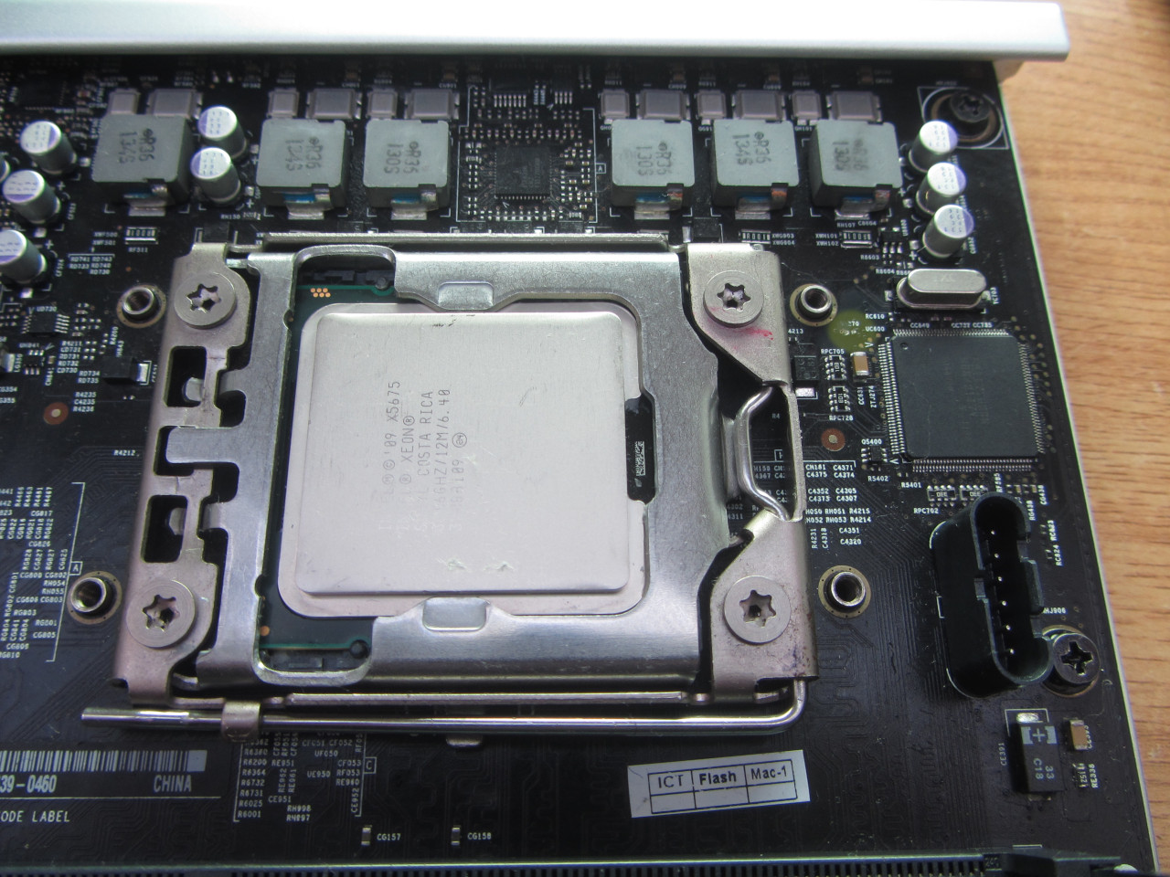

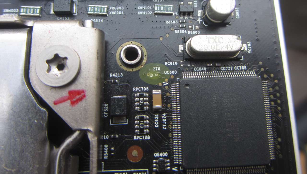

Hi, I recently acquired a Mac Pro 5.1 dual processor tray, when checking it I noticed that a resistor is missing from the motherboard, as I could see in pictures on the internet it would be R4270. Could someone tell me what is the value of the resistor? Thank you very much!!!
I attach a couple of pictures of my board.
Ps.: I'm not a native speaker, I use a translator.
Hi, I'm answering myself in case it can help someone in the future :)
I measured with the multimeter and saw that one of the terminals was grounded, so I decided to place a 10K resistor. Looking for other resistors nearby I found several 10k resistors connected to ground so I deduced that maybe it could work. I turned on the computer and ran it with the cpu at 100% for several hours without the computer crashing once, I think the problem is solved.
