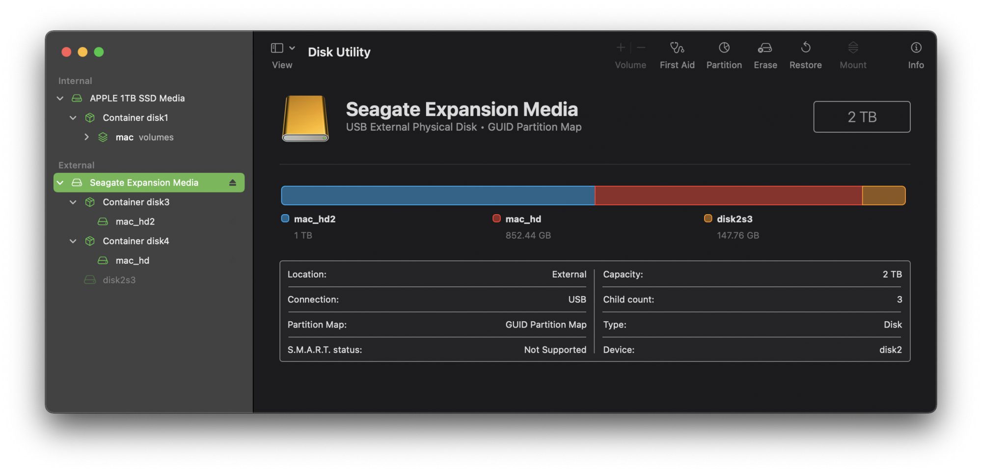

hi I have a 2TB ssd with 3 sections ones the main Mac_hd which I store my Mac files . I want to expand Mac_hd and use the 1TB space from Mac_hd2 .. disk2s3 (147gb) is a veracrypt volume I want to leave that alone.
how do I expand Mac_hd ?? Ive tried deleting Mac_hd2 and then creating a volume/ container .. can't wrap my my mind around this I don't understand how volumes/containers work on Mac.
if anyone can help would be great. do I need to use diskutil ?? I don't want to lose my data on Mac_hd
The normal way would have been to highlight "Seagate Expansion Media" in the sidebar, then click the partition tab in top right.
In the pie chart that appears you should be able to select the Mac_hd2 and delete it, and its space would be added to the adjacent slice. But it isn't very clear to me what you will see as not sure what you already done or how Veracrypt affects it, but I would start there. Sometimes you can't do what you want in the pie chart, depending on how things were created.

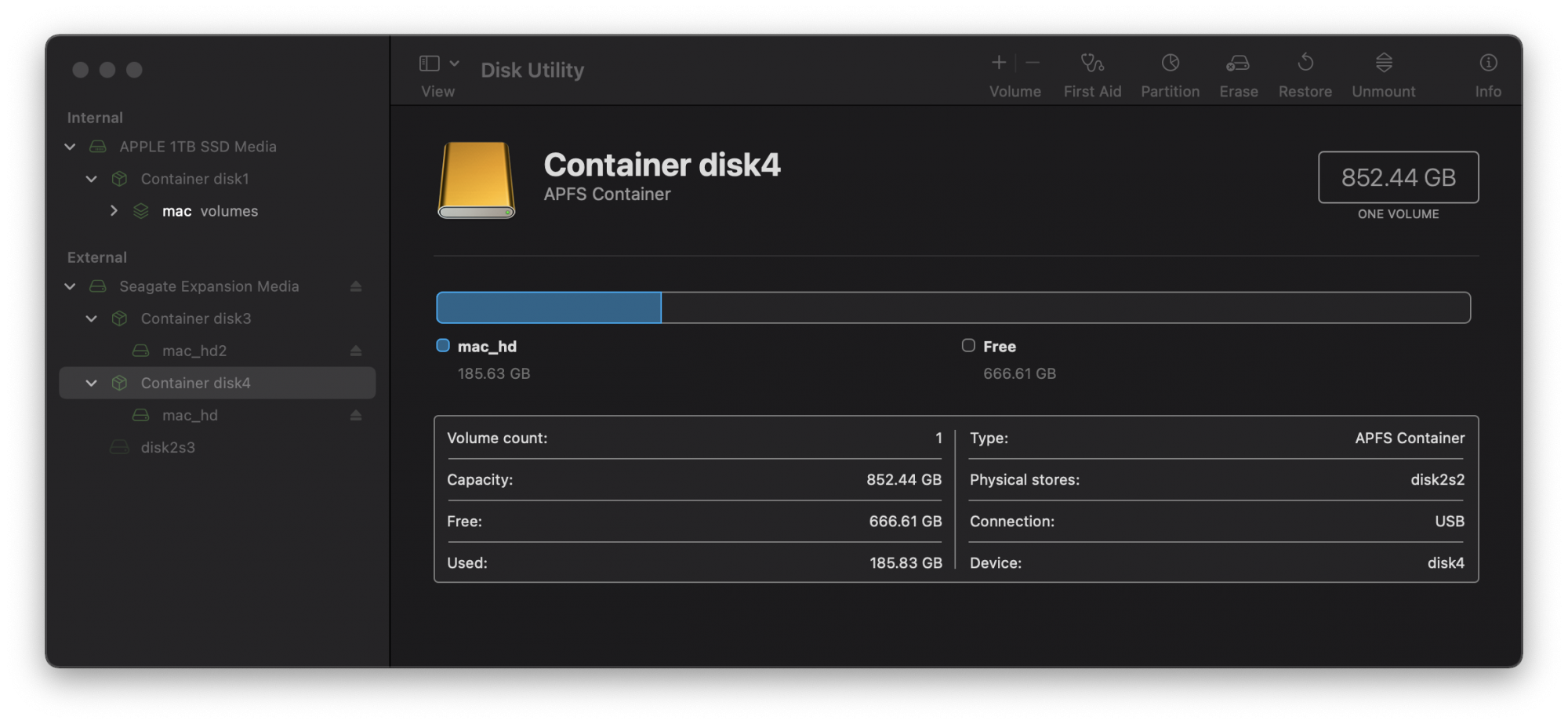

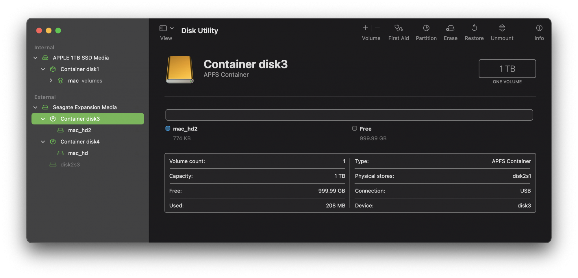

Think container = partition. Strictly the type of a partition is 'apfs container'. As Mike says, usually best to have one container/partition for all your APFS volumes.
Three layer hierarchy is 1) physical disk which has 2) partitions and the partition type can be APFS container. The APFS container then can hold 3) multiple volumes. In your case, both Mac_hd and Mac_hd2 would be better in the same APFS container.

I tried that but it didn't move the space to Mac_hd and it didn't allow me to move the slider to expand Mac_hd to take hold of the extra 1tb , initially the drive was setup for cross platform /linux/Mac/windows
I deleted the Luks drive in disks in linux and changed the format to APFS.. I just want to delete Mac_hd2 and assign that 1TB to Mac_hd
