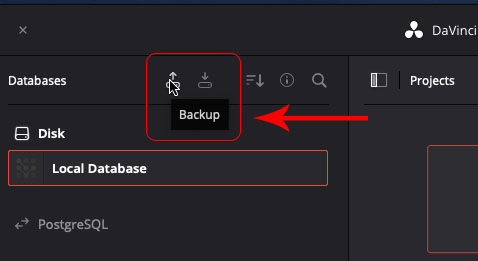

  1. Backup again your database.
  2. Save the .diskdb file in your Desktop.
  3. Open a plain text and copy and paste the name of your .diskdb file
  4. Move to trash the .diskdb file.
  5. Save the text file with the same name of the original .diskdb file in your desktop (Uncheck "If no extension is provided, use ."txt".).
  6. Close TextEdit
  7. Click on Restore, select Open, Choose the new .diskdb file, Type a "Name" and select a "Location"
  8. Click on Create.
  9. When the message Window appear asking you "Are you sure your would like to restore the database ".diskdb" (0.0MB)?
  10. Click on Restore.
  11. If you see an Error "Failed to restore database: Failed to restore database USERNAME from /Users/USERNAME/Desktop/.diskdb. Click OK
  12. Close DaVinci.
  13. Restart.
After restart Open DaVinci and check if your database is fixed
Camelia
