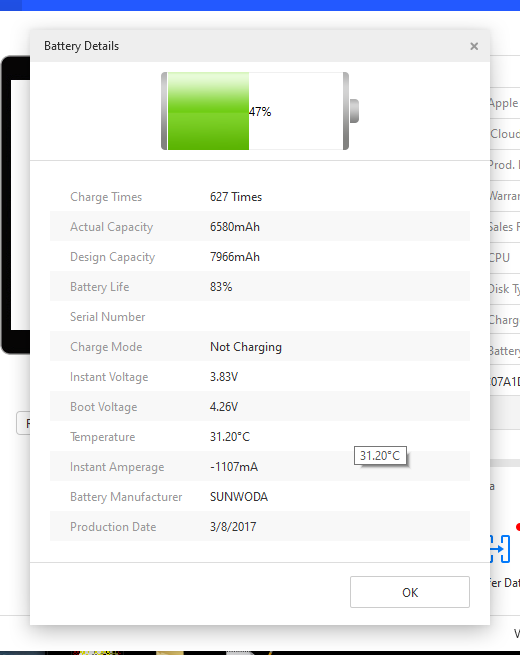

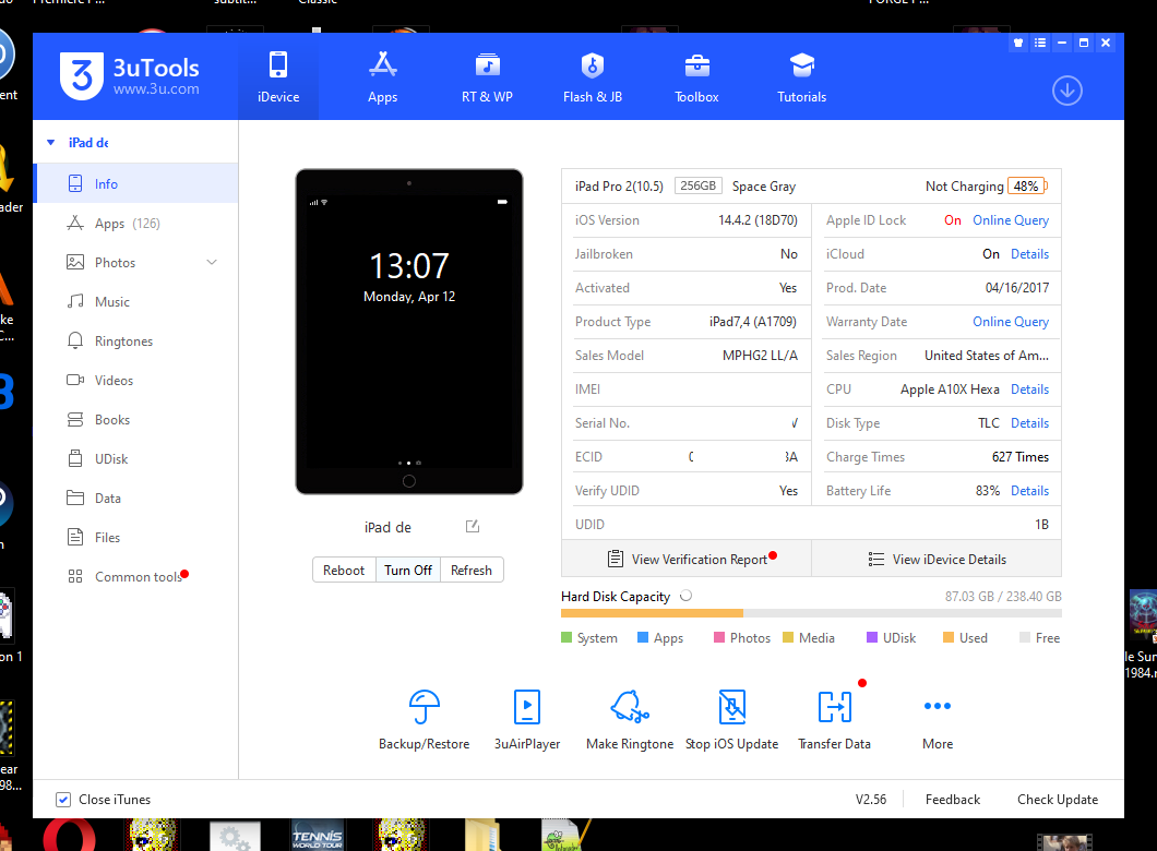

My IPP 10.5 has been suffering in terms of battery compared of course to years ago. This is the current status:

I don't think I did anything wrong with this iPAD. Perhaps using more the 29W USB-C Power Adapter? This reduces charging time a lot compared to the default one that came with the IPP 10.5. I also don't let the device run to 0% before charging. And no, I don't have the habit of using with the charger.

You have over 600 charge cycles on a 4 year old battery. I’m not even sure why you think there is a problem. Batteries don’t last forever. You’re lucky that’s it’s still above 80% health.

Sure, more than 636 charge times and 82% of battery life are among the reasons, yet I am positive something made this battery be drained much faster.
