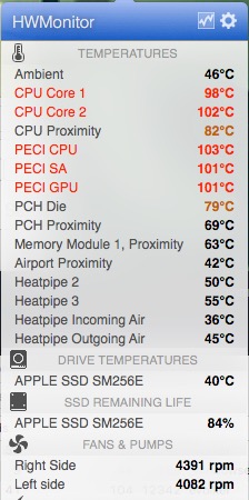

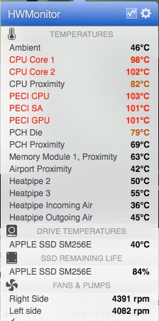

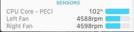

I recently picked up a 2012 Retina MBP 13" with a broken screen that I've been using as a desktop until I can get the screen repaired (or do it myself.) I've noticed that when doing something as innocuous as playing HD video the temperatures can get quite high.
Now that is with 12 or so Firefox tabs open, and Mail, Word, iTunes and few other programs idling in the background. Despite that CPU usage doesn't seem to be going over 60%. Things are a little better if I close everything except Safari, but temps still hit 93ºC when *just* playing Youtube video.
Is this normal? I've heard that MacBooks run hot, but that seems a bit much.
Does it need to be blown out with a can of air? Do I have to remove the bottom (with its lovely pentalobe screws) to accomplish this?
Not normal temps with your usage. You may have to re apply thermal paste and definitely clean out the fans and vents with compressed air.
Open it up, being so old, the fan may have dust that is inhibiting its function, otherwise as noted above, it may not be a bad idea to reapply the thermal paste.

100 C is the maximal safe operating temperature for Intel CPUs. I suppose that the video you are playing is not using any dedicated decoding hardware, instead relying on general-purpose CPU execution units. Under these circumstances, its not unusual that the CPU's ALU utilisation is close to 100% (since it is basically running a lot of intense math) and so high temperature is not unexpected. Of course, this is not really sustainable in long term, since your battery will go down very quickly. This is why contemporary CPUs/GPUs have specialised decoder units which can decode mainstream video formats while using very little energy (and therefore producing very little heat).
That is for sure not normal. When the temp spikes like that, open up Activity Monitor and see what's hitting the CPU. Something has to be really hammering it for the temps to get that high.
Or, there's something wrong with the cooling system, which, like others have said, involves cleaning the fans and making sure the vents are unobstructed, and maybe replacing the thermal paste. Also couldn't hurt to make sure that the heatsink assembly is properly tightened down.

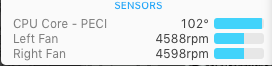

In your screenshot, it shows your fans running at ~4000rpm. I'm not sure about your particular model year machine, but I've had other MacBooks that would run the fans closer to 6000rpm (and sound like a hair dryer). May be nothing, but if there is some more oomph to be squeezed out of the fans, it could help a little.
On the video side the content may not be decoded in hardware hence the very high temperatures, nor much that you can do with it. The notebook will likely benefit from the fans and heatsync being cleaned up as with such high temp and middling CPU usage something is off.
The external display may also push the iGPU harder. I still have 2014 13" rMBP kicking about that I mostly just use for media playback attached to a 34" 2K Ultraswide and it rarely passes 70C. Is the player using Flash as that will send the temp through the roof on a Mac guranteed.

Thanks for all the input. So this is a Youtube video playing in either Safari or Firefox Quantum. One thing I've noticed is that the initial transition between windowed and full-screen modes generates a *lot* of heat. That animation hammers my iGPU for some reason. Since it's Youtube, I assume it's HTML5. I assume both Safari and Firefox are able to apply hardware acceleration to a Youtube/HTML5 video. I doubt it is using Flash.
I am using an external monitor because the internal display is physically damaged. However, the external display is a 1080p monitor whereas the internal display is 2560x1600p, so it would seem odd to me that a lower resolution display would generate more heat than the Retina display.
I did blow out the external vent & exhaust, but I don't have a Pentalobe driver handy to remove the bottom of the chassis. The most helpful thing I've done is install "Macs Fan Control" and set up a more aggressive fan curve. That got me down to about 80ºC for full screen playback.

CPU Proximity is the heat sink for the CPU.
The difference between CPU Die and CPU Proximity gives you a hint at the performance level you’re getting from thermal transfer between them. Larger the diff, worse the performance.
ie: My mid2011 Mac mini has a delta of 4C between CPU Die and CPU Proximity. The GPU Die and Proximity has a delta of 3C. I reapplied the thermal paste about 18 months ago in that system.
I don’t have a mid2012 13” Retina system with which to test, so I can’t say for certain, but the delta for your system seems rather high. You could try to reapply thermal paste and see if that helps, but TBH, you have a used system that has been physically damaged, so there could be other things going on that are not readily apparent without a visual inspection of the logic board by a more qualified person.

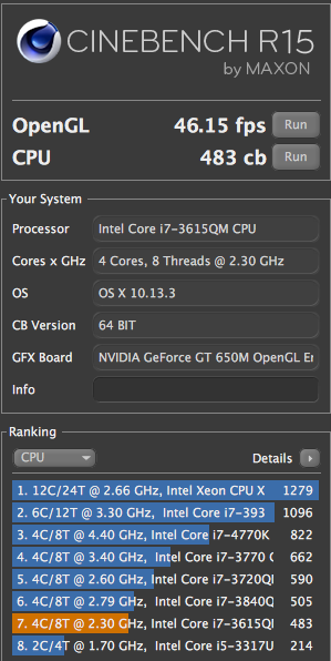

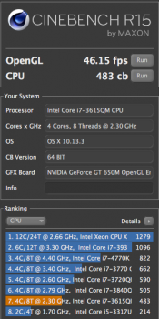

So I finally got the pentalobe driver (took a couple of days longer than I thought), removed the bottom cover of the Macbook and blew out the vents and fans. Now temps hover around 75ºC - 78ºC when playing an HD video, but they still spike up to 90ºC when the video first loads. That doesn't sound like much of an improvement, but I also tried another test.
My Cinebench R15 score went from 209 to 246, which is a substantial improvement in performance. The extra cooling performance must have alleviated some of the thermal throttling I was seeing. Anyone know what Cinebench R15 score I should expect with an i5-3210M that's not getting throttled at all?

I failed to realize that the ambient temperature was about 5ºC below normal, skewing my results. After warming up the room, the Cinebench score dropped to 217. Better, but not as good as it should be. So I decided to go ahead and re-paste.
The screws were a fair bit smaller than the ones I usually find in Dell laptops, but I managed the disassembly without losing any hardware. However, after re-pasting the temperatures just don't seem that much better. I'm still hitting 83ºC while watching videos, though it's 10ºC - 12ºC cooler than when I started this project.
Another pass with Cinebench netted a score of 232. Also, better than the 209 I was getting at the beginning, but still short of the 246 I saw when the room was cold. Is throttling normal with a Retina MBP when running something as demanding as Cinebench?

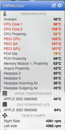

I'm still seeing a large delta between the CPU Proximity sensor and the Core 1/2 sensors. It's still about 13ºC, no different than the numbers I posted in previous posts. So it seems there's something fundamentally wrong with the cooling system. I'd say it's not worth repairing the display.
Yeah those numbers you’re getting are still way too high. I did some testing on a friends 2015 mbp 13” and his computer is at 46-53c watching hd video. Seems like something is wrong with the heat sink or cooling system in general
I never ran Cinebench R15 before, so not sure if I did it right. I just clicked the "Run" button next to each of the test (OpenGL and CPU.)

It's possible that a cracked heatsink or pipe could explain the temperature difference between die and proximity. I usually check iFixit.com for Apple part numbers, and then Google that part number for a cheaper source, unless iFixit's price seems reasonable at the time.
https://www.ifixit.com/Store/Mac/Ma...na-Late-2012-Early-2013-Heat-Sink/IF123-014-1
Apple Part #: 923-0227
Found one marked as "new" on eBay from a "top-rated seller" for half the price. But it won't get here until next week. I'll post my results once I get the new part.
Success! I got the heatsink/heatpipe in today and installed it. Now when I play videos the temperature runs between 58ºC and 66ºC. I did a Cinebench R15 run and got a score of 249, and the temperature maxed out at 85ºC. That is a major improvement, though I think the temps are still a little high.
