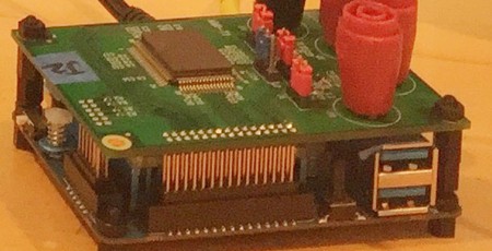

Micro Magic 64-bit RISC-V CPU runs at 5GHz on 1W.

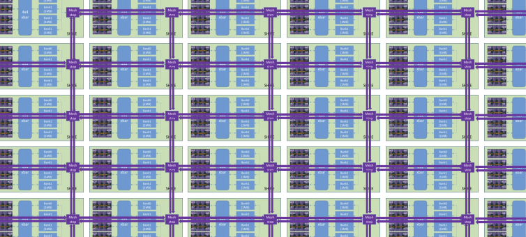

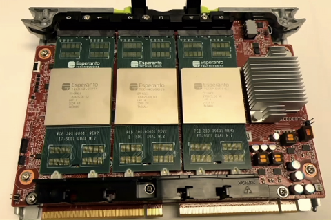

1000~4000 cores with RISC-V is in development which both x86 and ARM cant do. The power consumption is extremely low too.
Show me some industry standard benchmarks. SPEC, even Geekbench or some browser benchmarks will do. I don’t know what CoreBench does. From the developers description, it only measures low-level ALU performance. This has nothing to do with running real-world code. Furthermore, we have zero information about that CPU. It could be something very simple designed to run at high frequencies abs low power consumption, but sacrificing everything that actually makes CPUs go fast (out of order execution, branch prediction, caching).
These are specialized ML units. It has nothing to do with running general purpose code. These cores are extremely simple and hence energy efficient. You could also be arguing that a two-stroke diesel engine is more efficient than a modern fuel injection car engine since it’s what ships use abs they can transport more cargo per unit of fuel used. You have to take the context into account.
