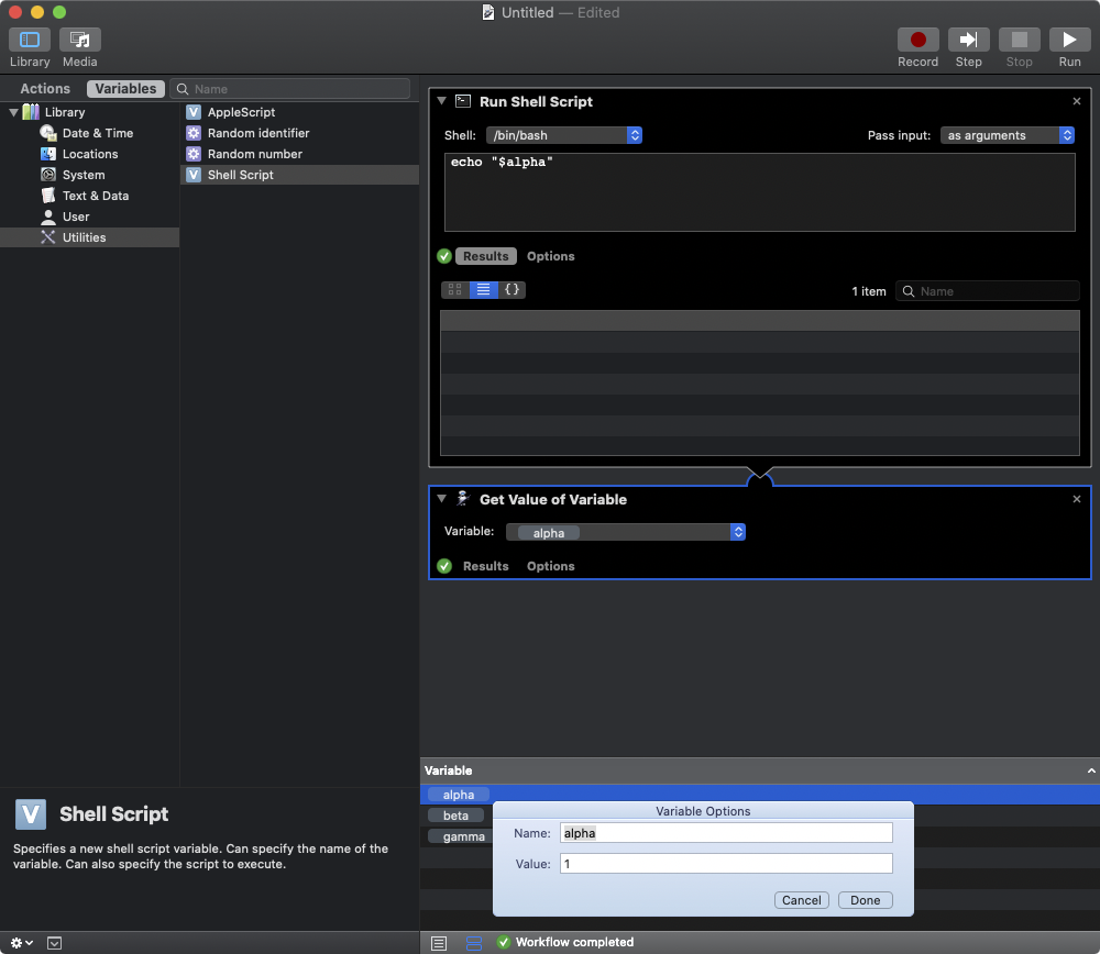

I'm trying to emulate the following pattern:
  • Have several variables defined into Automator script
  • Running the Automator script will ask you what variable to use, from defined list
  • Automator will execute the command every 30min
I tried what shows into screenshot, but it would print the value 1. I do not know how to pass the variable into one liner.
Still, my goal is to have the script ask me what variable I want to use, then execute the command using the chosen variable value every 30 minutes. Is this something feasible? I'm very familiar with shell scripting, cronjobs, launchd .plist, I would like to learn using Automator.
Thank you for your help.
Each time the workflow is run, the variables will be reset to the original settings. You will need to save them to preferences/defaults, or otherwise keep the workflow running. Automator isn’t really the tool to use, you might have better luck with a stay-open AppleScript application using an idle handler or NSTimer.

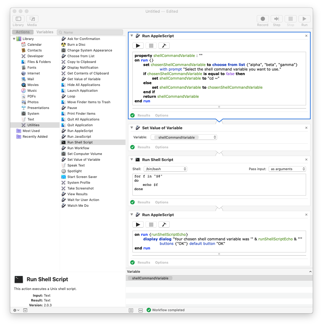

The way to produce the same result in Automator, is pictured below, but doesn't have the option of of repeating every x number of minutes, but hopefully the picture shows the workflow steps needed to duplicate the above script.
In the Automator workflow showed above, I've set the choose from list "Cancel" button to a harmless shell command.
And you can obviously edit the "Run Shell Script" command displayed to anything you want to run.
