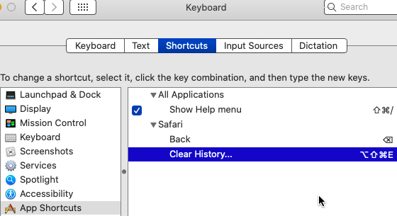

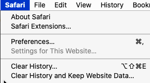

I clicked on "Clear browser history..." (whole history) then quit and relaunched it.
I have a shortcut for that
After setting the shortcut, a second entry in the menu appears
The first, Clear History... with the shortcut, deletes all, just like the rm commands.
The second, Clear History and Keep Website Data..., doesn't delete cookies
Reactions: Yoms

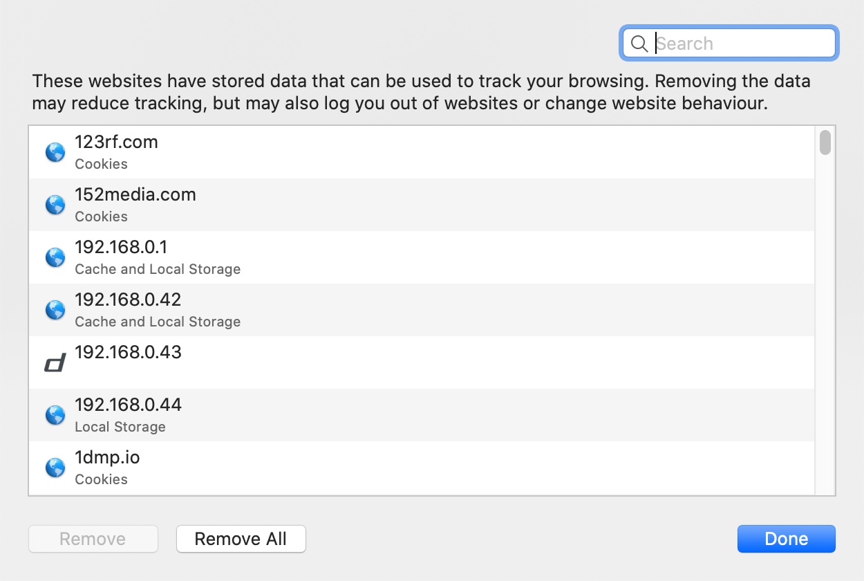

If it's any use I've had the same problem since the update too. If you delete all data in the prefs-privacy-manage website data.. - remove all, window and quit Safari, some files that are shown as being caches magically turn into cookies on the next relaunch, but at least once they've become cookies the next delete appears to remove them after the next delete/quit/relaunch. Don't forget to do a 'Clear History' AFTER deleting the website data. It must be something to do with Virtual Memory and Safari keeping cookies in ram even when you're telling it not to. I hope they fix it and don't just turn it into a feature

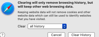

Did 10.5.4 give you a newer version of Safari?
I'm using Safari 14, and if you tell Safari to [Clear History...], then that's exactly what it does...clears your browsing history (although I have mine set to clear every time is close the browser).
However, that option DOES NOT remove website data (cookies, caches, permissions, etc.)...that is part of [Manage Website Data].
To clear cookies, etc. you need to go to the [Privacy] tab in [Preferences] and click on [Manage Website Data], then wait a few seconds for it to populate the list of sites it has data for (slower machine with lots of sites will take considerably longer - mine takes 5 seconds for about 400 sites on a recent iMac with SSD) and then click [Remove All]. On closing and re-launching Safari this should have logged you out of your websites too.
