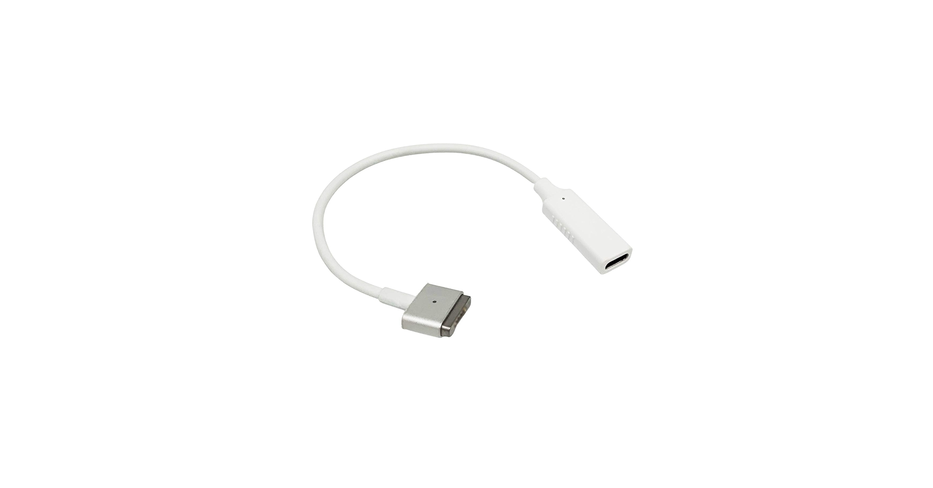

now I see: I neglected to note that I also ordered one of these:
USB C Female to Magnetic 2 T Tip Charging Cable Converter for Mag-Safe 2 T Tip for McBook Pro 13/15 inch for McBook air 11/13 inch(After Late 2012 Models)
…which itself requires USB-C PD, and states it WILL work with PD USB-C 20V, at 61W / 65W / 87W / 96W / 100W / 130W.
So the above adaptor does the job of negotiating with the USB PD charger based on the requirements coming from the MagSafe2 port on the MacBook Pro.
So it seems the voltage IS irrelevant.

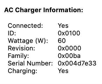

Here's the window capture of the AC Charger information.
The Apple 96W USB-C PD power brick, plus Anker 100W USB-C to USB-C, plus USB-C to MagSafe2 power adaptor WORKS, and appears to charge my MacBook Pro quickly. However, in the System information Power tab the wattage only shows up as 60W. The standard 87W Apple MagSafe2 power brick will show up at 87W.
It may be that a different USB-C to MageSafe2 adaptor MIGHT show 96W (or max out at 87W). But I'm not sure if the actual charging results would be any different.
Most of the USB C to MagSafe adapters I've tested only support 60W, even if they claim higher. I can't find it on Amazon anymore, but one which did NOT advertise 85W actually supports 85W.
It differs from most of them by having metal casing on both usb c and MagSafe ends, where most of the others have plastic (or rubber?) on at least the usb c end.

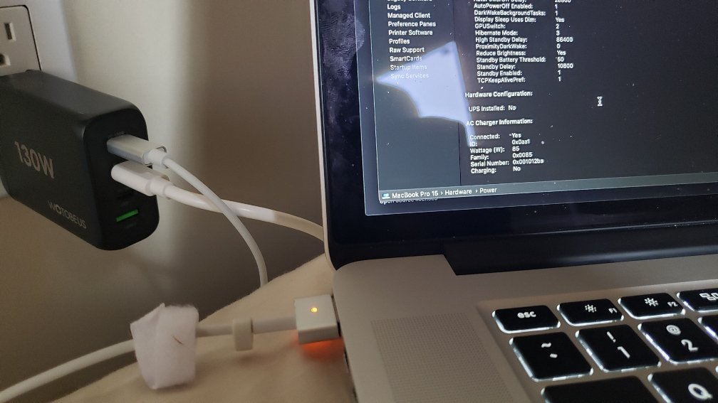

Howdy! Is this setup still working for you? Have you had any issues with charging?
I’ve already opened and repaired the MagSafe 2 for my A1398 a couple times and the mag end is now fidgety.
It’s a challenging fix, as separating the mag cnx is a giant pita and oft results in damage. I chose to buy the 96W usb c brick, usb c cable, and a c to magsafe adapter and am awaiting arrival.
There is a thread on reddit but it’s mostly about 3rd party bits.
Any feedback is much appreciated!
