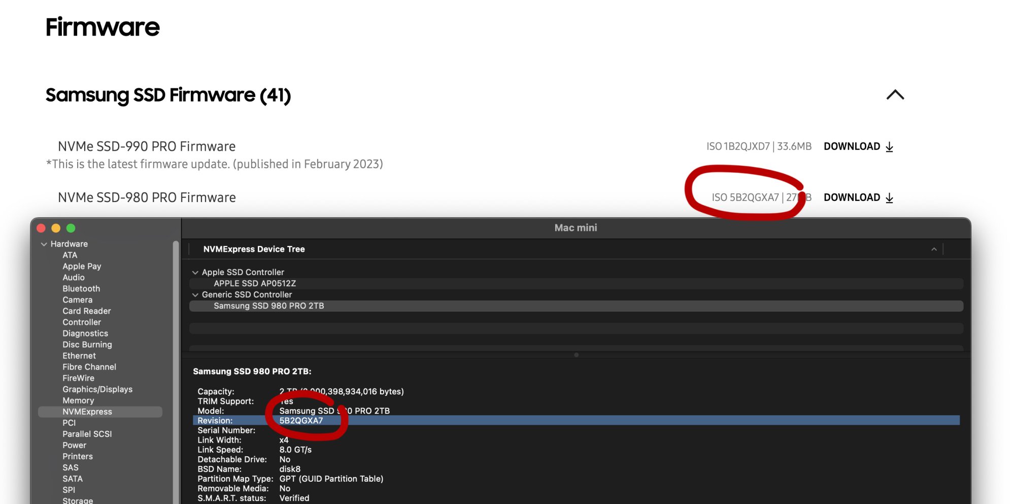

I have an external Acasis (TBU405) Enclosure with a Samsung 980 Pro 2TB and wanted to know what firmware it is running and if I can update it. I contacted Samsung and to no surprise they do not have an easy way of dealing with it on a Mac but was told (and received confirmation via email) that if you need to have the firmware updated you can send it to them and they will update and test the ssd under warranty. This of course is kinda a last resort thing as they will completely wipe it in the process.
As far as checking what firmware your ssd is running you can use your mac's system information and compare that with the latest version on Samsung's site.
If you have Bootcamp (obviously not on an Apple Silicon Mac) you can update SSD firmware via Thunderbolt. That's probably the easiest way to do it on a Mac but is rapidly becoming impossible as Intel Macs become less prevalent.

You can check the firmware yourself... you just can't update it.

Ahhh thanks for the tips. I didn't know it was possible. A quick google did the trick. Confirm newer batch shipped with latest firmware.
you could have looked up at this thread where I actually show how including a screenshot... #10
Just wanted to say thanks for this!
Had a 2 tb 980 pro from last year and just got a new one for Amazon prime day and they both have the more recent 5B2QGXA7.
