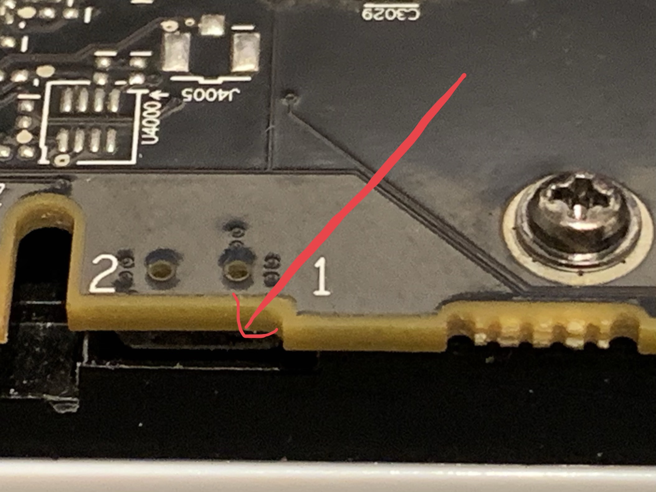

There should be a ROM switch on the card. Did you try another ROM? Just in case someone accidentally flip that switch (may be the selling during packing the card, or when you installing the card, etc).

I'm aware about the switch on the card, however the switch handle is missing when I got the card. There is no way I could check if this card is switched to Mac EFI or windows.

Can you take a picture of the switch and post it here?
